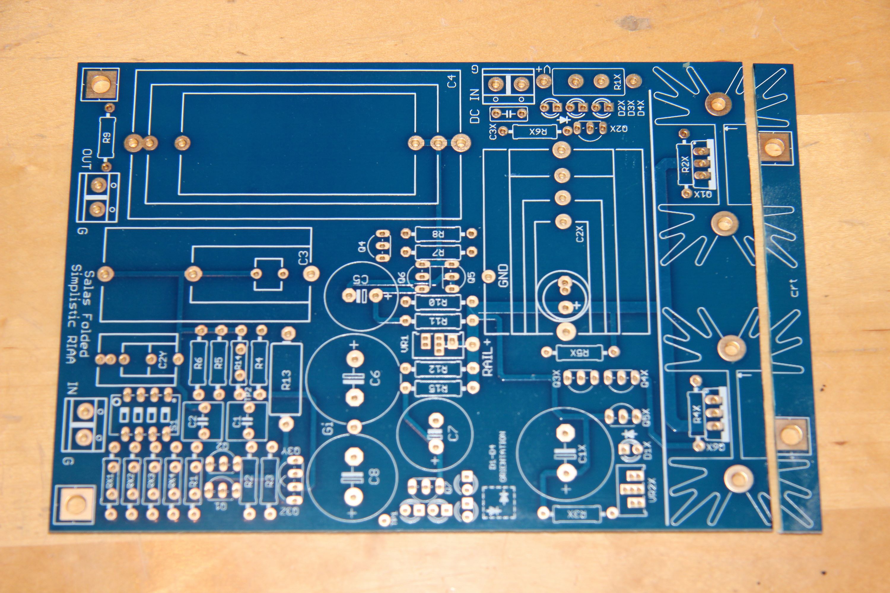

Its easier to concentrate on fine preferences when the board has solved the layout concerns. Those types are popular enough in the course of the FSP PCB builds. Its good when there is some basic subjective consensus about parts in a project. A rare thing. There was specific layout provision for EVO size in C2x also. What you combined for interstage (C3)? What resistors for Rload and R14?My first folded build using Salas boards came home again and I decided to modd it a bit.

R14 47k PRP 1WIts easier to concentrate on fine preferences when the board has solved the layout concerns. Those types are popular enough in the course of the FSP PCB builds. Its good when there is some basic subjective consensus about parts in a project. A rare thing. There was specific layout provision for EVO size in C2x also. What you combined for interstage (C3)? What resistors for Rload and R14?
Load Vishay metal foil trimmer
I placed Mundorf Mcap EVO alu-oil in C2x from the beginning. So, I have no compare impression for other type of caps in that spot. My concern is about C3 (0.1uF) and C4 (2.2uF) . I used Mundorf SIO for both. Have you tried to compare these to ClarityCap MR series? Any other members opinions are welcome.

It also has layout provision for electrolytic termination. EVO Alu is 5 EUR and EVO Alu oil is 9,5 EUR. A rather economic caps range.
