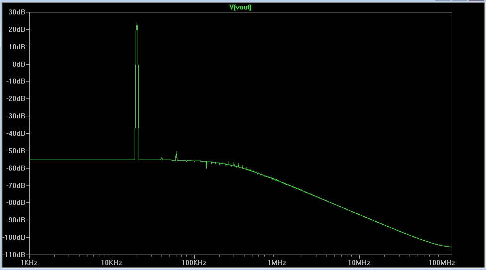

Remember some posts ago I posted a spice simulation that didn't look too good?
Turns out I had a problem with the LTSpice directive. Now I got it right and the distortion spectrum at 20kHz is attached bellow. Looks much better! :)
THD @ 20kHz @ 22V is about 0.02%.
I also had reported an oscillation problem. Gate resistors + input snubber (20pF // 3.3K as recomended by Keantoken) + 680pF input filter cap + a new, shorter, shielded, decent input cable, and the oscillations are completly gone! :) It's obvious to me now the culprit was that stupid inductive long cable. Gave the cable to the cat. He's having lots of fun with it! ;) The amp is rock stable!

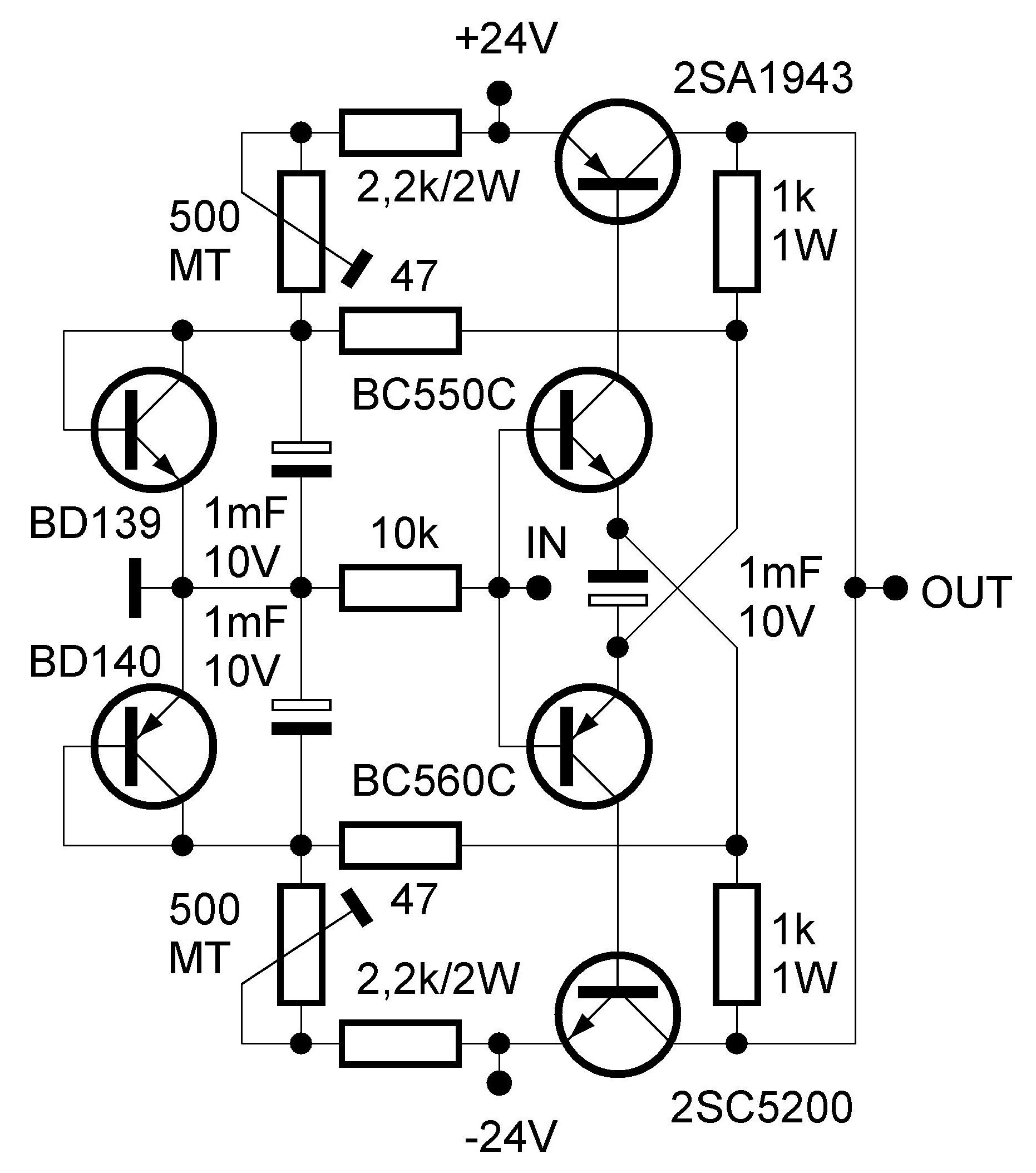

So, I would really like to build the very basic BJT version, based off of the schematic posted. Just wanted to ask a few questions first:
1. The three 1uF caps look like electrolytic's. Is that right?
2. The BC550/560's need to be strapped face to face?
3. The BD139/140's need to be on main heatsink?
Now for the big question. I already have a few different power transistors. They are:
1. Toshiba 2SC3281 / 2SA1302 (original)
2. Toshiba 2SB755 / 2SD845 (original)
3. NEC 2SD588 / 2SB618 (original)
I was hoping not to have to buy new power transistors. I'm also not to the point technically where I can tweak values in the schematic to be able to use these transistors, (still a newbie), but getting much better at following a schematic and building. I was hoping someone could point me in the right direction. I'm thinking the 3281 / 1302's would be the best bet. Advice?
