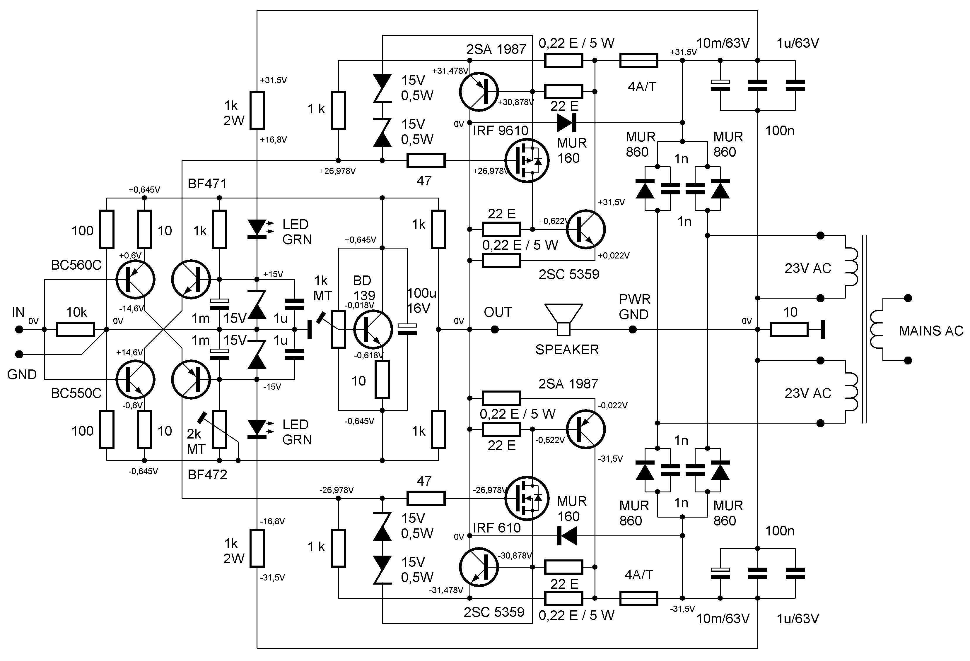

Today i power up the amp, both trimpots are set to maximum resistance
The offset is -1,1v and is settle slowly to -1,55v and swing to -1,59v and it seems i can't bring down more than -1,40v
The BF's heatsink is barely warm
Any sugestions
First look if there's 15 V on zeners. DC offset and VAS/TIS bias is set by changing 2 k trimmer. If that is not successeful than change also opposite 1 k fixed resistor. What's the mid feedback bridge voltage?

Between led's and 1k/2w i have approximately 17v, between led's and zenners i have 15v
Should i change 1k resistor with 2k trimpot?
I don't understand exactly, where to measure mid feedback bridge voltage?
OK, it's good that all voltages are marked in sch. Just connect negative test lead of voltmeter to GND and positive to all marked points and you should measure similar voltages as in sch. Mid bridge voltage is difference between +0,645 V and -0,645 V, that means 1,29 V. If all properly done 2 k trimmer is enough to set DC offset to zero and at that point VAS bias current should be around 10 mA. If you cannot set DC offset to both polarities that means something else is not in symmetry. Please first measure all voltage points as instructed and try to find where your SSA's unsymmetry has the roots.
