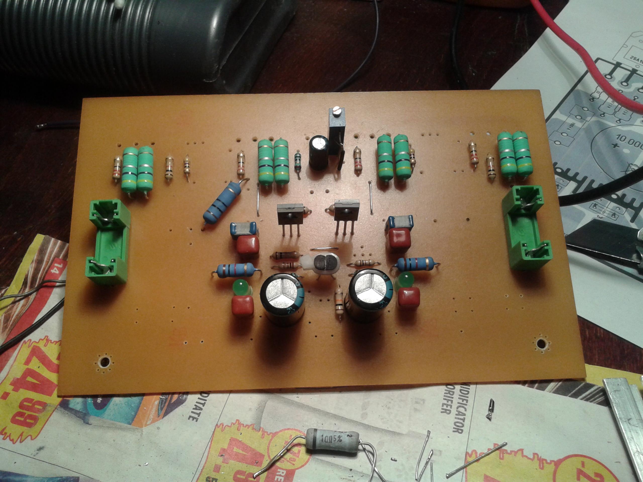

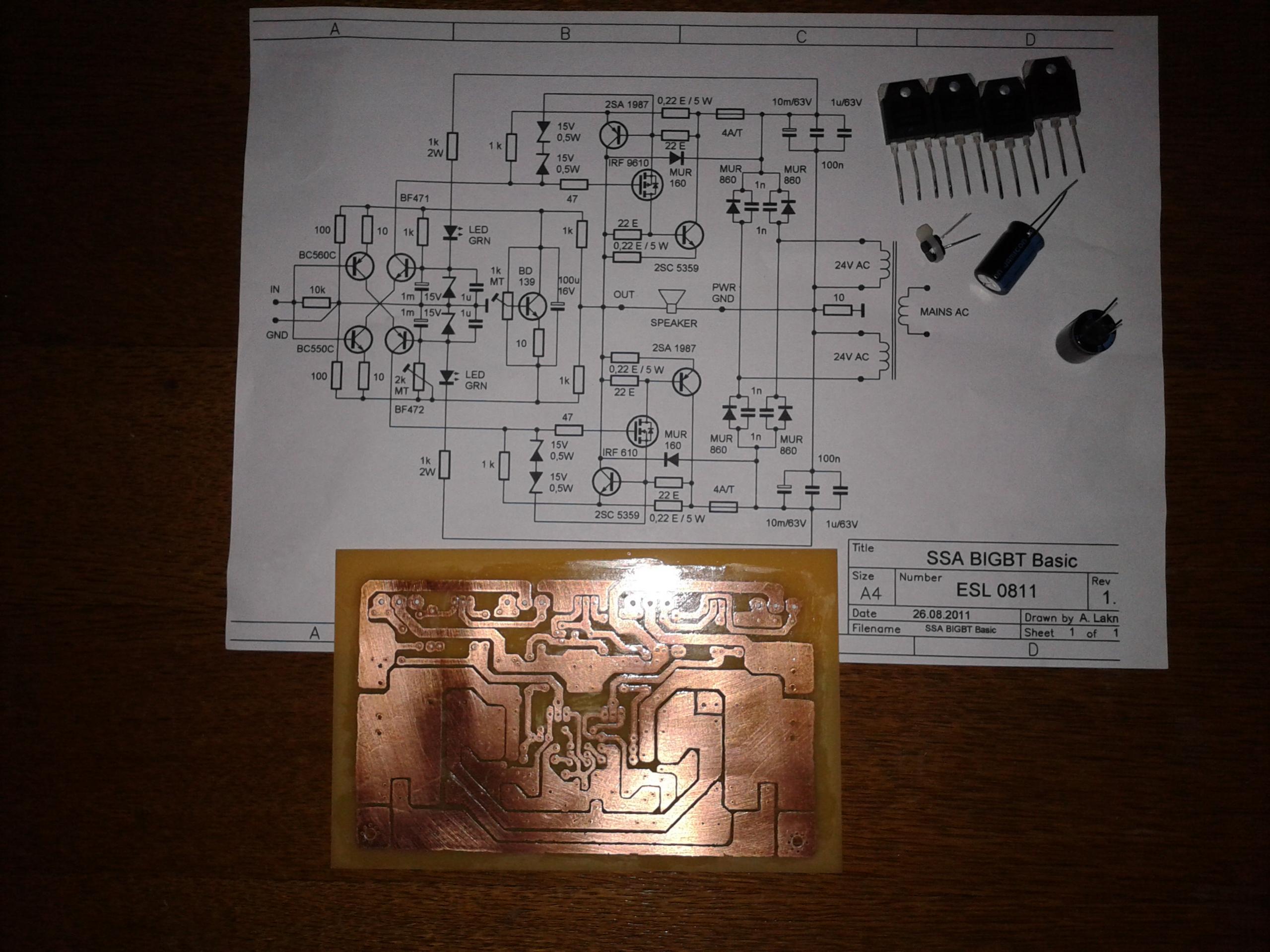

Hi everybody :wave:
I decided to build SSA with BIGBT
I have some BC546 and BC556 with extremely close hFE 303 and 304 :eek: measure with normal DMM
BF471 and BF472 are not close hFE, 160 and 125,
Can i use common heatsink on both BF ?
On output i will use NJW1302 and NJW3281 with hFE 101 and 91
Suggestions are welcome :D

Hi everybody :wave:
Yes you can use common heatsink for BFs, but it has to be on GND potential and both BFs isolated by means of mica/kapton washers. Be careful that it will be big enough to dissipate 2 W from both BFs at less than 50°C. ;)
Inform us about results when finished. :up:

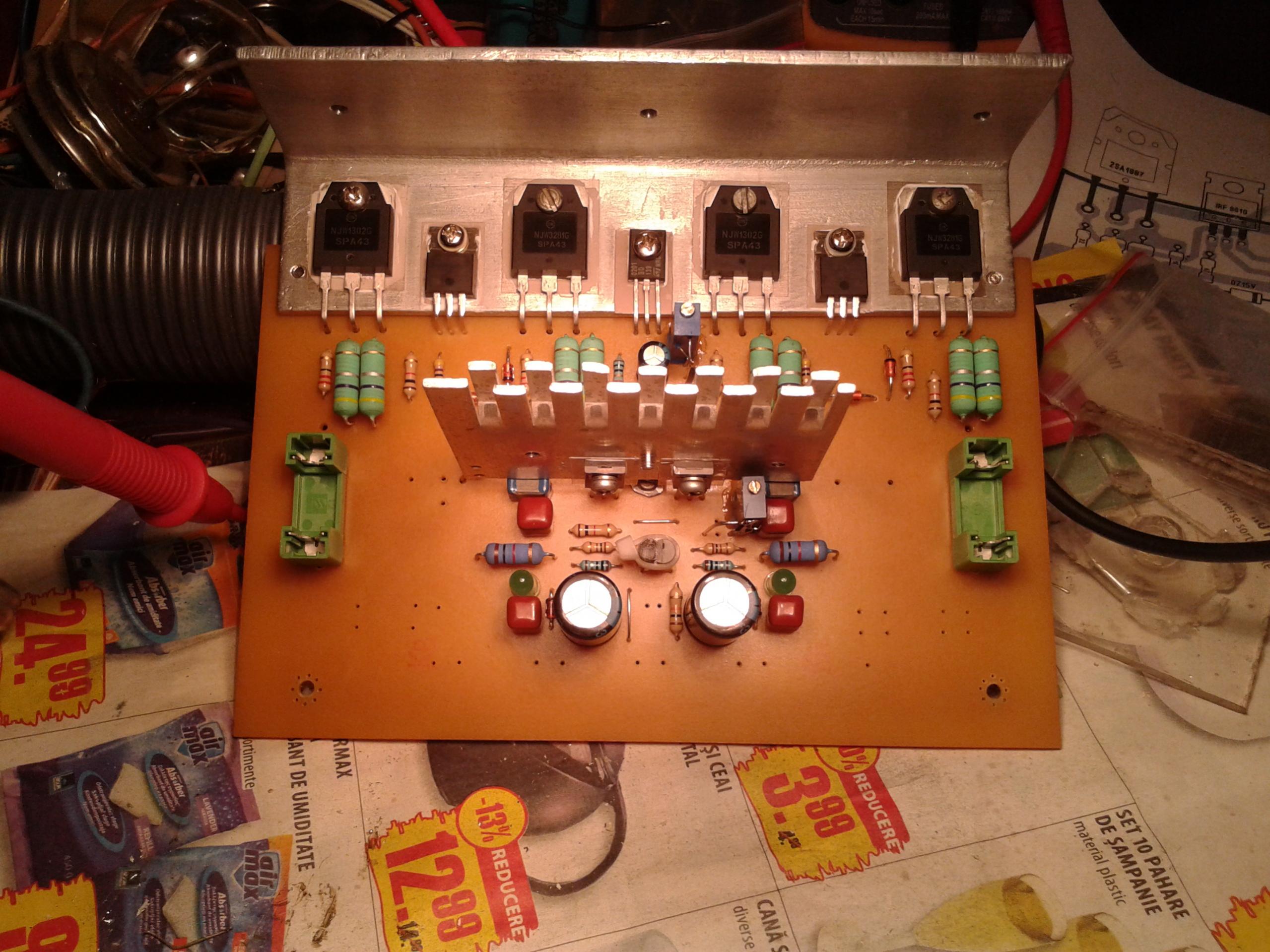

Job done ! :D
Before i will power up this amp I have to check some things
- on the output I mount a Boucherot 10 ohm + 0.1uF
- i connect to GND L braket and BF's heatsink

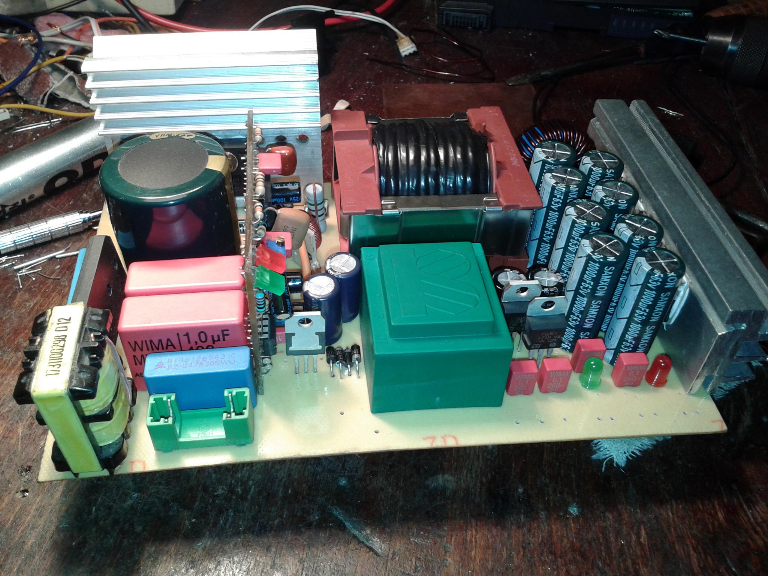

- power supply is a half bridge SMPS that i made two months ago, +/-58v with no load
- what is the optimum bias for BIGBT output?
If you already explained about bias the BIGBT i apologise, but there are 400 pages to read and i can't wait to power up this amp :D

Very nice looking PCB, just great. :up:
Well VAS/TIS TO-126 should have 10-12 mA bias, each output BJT 100 mA, and IRFs will consequently set up at 30 mA if you use 22 ohm Rbe for the outputs.
SSA is completely DC coupled so expect some DC offset traveling if you don't have some sort NTC, DC servo or other temp tracking for the input stage. Bias spreader for the outputs sense and regulates only main heatsink conditions.
Regards, L.C. :cheers:
BTW cool SMPS you have there. :wiz:
