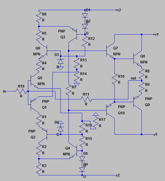

Inverting SSA
There is no way out for the purpose mentioned earlier the amp must be inverting.
Anyway with the feedback system shown earlier it has now a current input and a current output . But does this schematic make sense ? Of course it can be simulated.

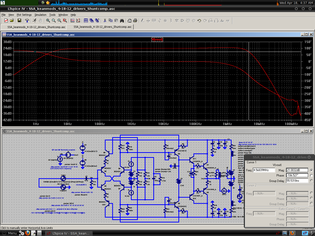

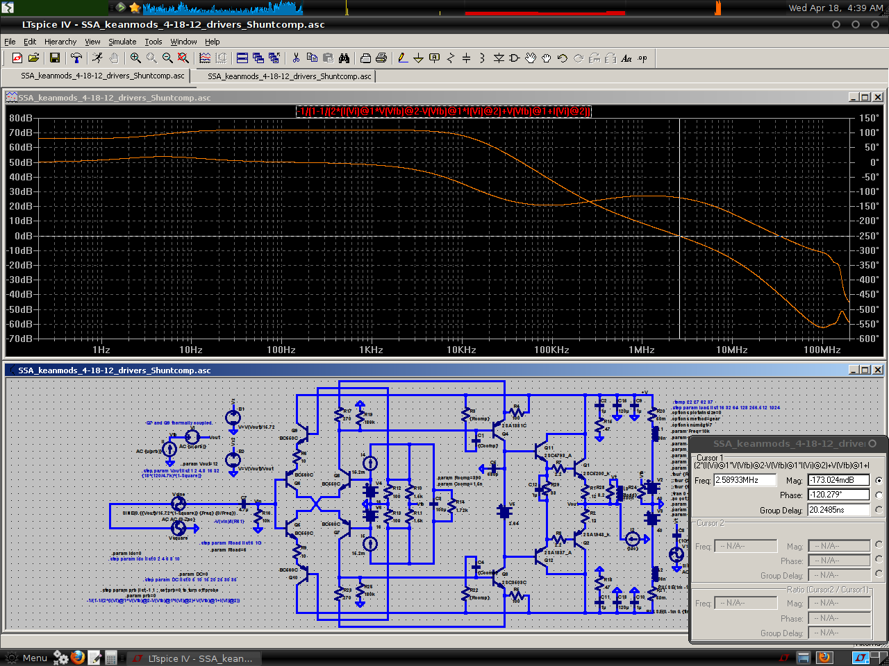

Here it is. The 100pF cap, not the one at the input, is the shunt compensation. It is analogous to Ccomp in my schematic. What isn't immediately apparent is Rcomp, that always comes with shunt compensation. If this cap is deleted, a network of 620p+220R can be placed between the VAS bases to the same effect. Only then, the nonlinear Vbe is imposed across it which might lead to more distortion. The advantage of Mike's approach is that a smaller capacitor can be used, and this arrangement causes less distortion. PSRR is increased, but the frontend rails are RC'd anyways.
The trickyest thing about this amp is where Rcomp has gone. That was the biggest confusion for me, and the compensation of this amp does not make much sense until you've studied Shunt compensation in detail. The R in series with Ccomp sets the amp open-loop gain to a lower value at the frequency needing compensation. In Symasym this is not needed because the other half of the VAS is not compensated. So the uncompensated half of the VAS provides the gain that would otherwise be conserved by adding Rcomp.
The other important part of this compensation scheme is the 330p caps. These caps provide the gain roll-off, whereas the RC shunt just steps the gain down. The best economy of compensation and distortion is achieved when the RC shunt is made smallest by using larger 330p caps. However you can't make them too large or you get RFI issues, like Miller compensation. I prefer to instead make these caps as small as possible while still providing the large reduction in distortion resulting in a smaller RC shunt. This is because in my tests, the 330p caps detracted from realism and soundstage depth. I was only on one prototype though.
Finally, the SSA can be reworked to mimic the Symasym scheme pretty closely, because like Symasym it has two VAS's. However this doesn't work well unless we lower the SSA's open-loop gain significantly. Rather, it works best to keep my previous compensation scheme and simply add a capacitor to the VAS output like the symasym. See my schematics.
With this compensation scheme, all harmonics are below -110db from the fundamental, at 12V, 10KHz into 6R.
Homemodder, what I meant when I said "reworking" it to mimic Symasym, was to connect a cap across only one VAS, and leave the other VAS uncompensated, like the Symasym. It doesn't work though, because even at half open-loop gain the VAS output cap is not enough to stabilize it. So I've accepted the higher parts count. There may be other ways we can implement lop-sided compensation.
Phase lead can disguise the hump but it can't make it go away. It is nice to have a perfectly rounded square wave, but since learning about group delay I see that as somewhat superficial. It is good to keep peaking and response within bounds, but beyond that is superficial unless you're looking directly at group delay. A response may appear to be geometric, but if you look at the group delay it becomes painfully apparent where the corners went. Very simple amps, even if their distortion and speed specs are not great, tend have have more phase linearity (constant group delay=phase linear). This may be the technical appeal of TSSA. On the other hand, if phase-lead lowers distortion, then why not.
