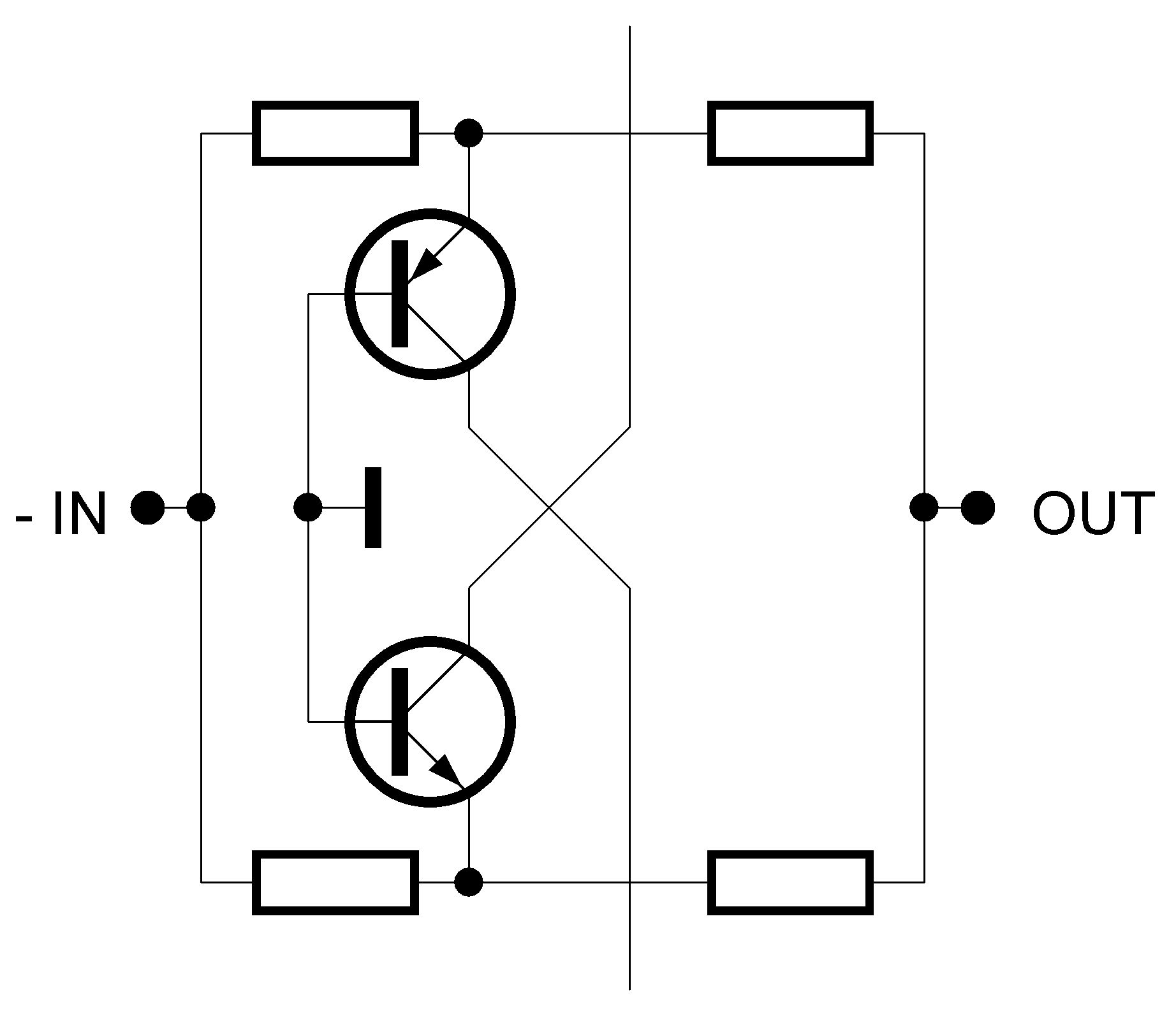

Thats ok. No listening tests yet because the attempt to have the amp inverting, that is input is the summing point of feedback, does not work.
But it should.
But it should.
Inverting amp should have bases (+IN) grounded and input signal connected to the feedback divider (-IN), look the pic.

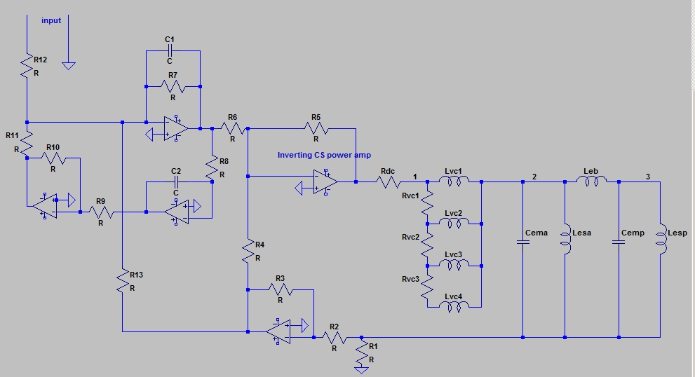

This is the objective (pic) . This positive feedback allows to set the actual parameters of the electrical representation of a speaker in a vented box ( very simplified model) . Thus one can set such parameters as mass and compliance for a target TS alignment of any speaker in any box.
Aside from harmonics, a voltage amp is assumed to deliver real voltage, which causes a complex current to flow according to complex impedance of the speaker.
This circuit does exactly the opposite it forces a complex current which causes a real voltage thus overall a real voltage on input has a real voltage in the complex load.
This does not work with the SSA . While another by design inverting amp ( commercial AVM amp) does exactly as theory predicts. Any idea?
Is there a point in seeing how a complex load behaves since you still have no idea how it sounds since you cannot simulate the transformation into moving air. All you have done is introduce even more variables.
Sure i can compute the acoustical output. of course then I need the radiation resistance but this does not create complication. No in fact I have reduced variables because of the effect, mutual cancellation.

but he did not get the point that the current source must force a complex current into a complex load such that the imaginary parts become zeroed out and hence no phase shifts no timing problems no frequency response problems.
Basically this is not new thinking anymore , the makers of active speakers are considering amp and speaker and box and acoustics of listening rooms as one system, not as independent separated devices.
