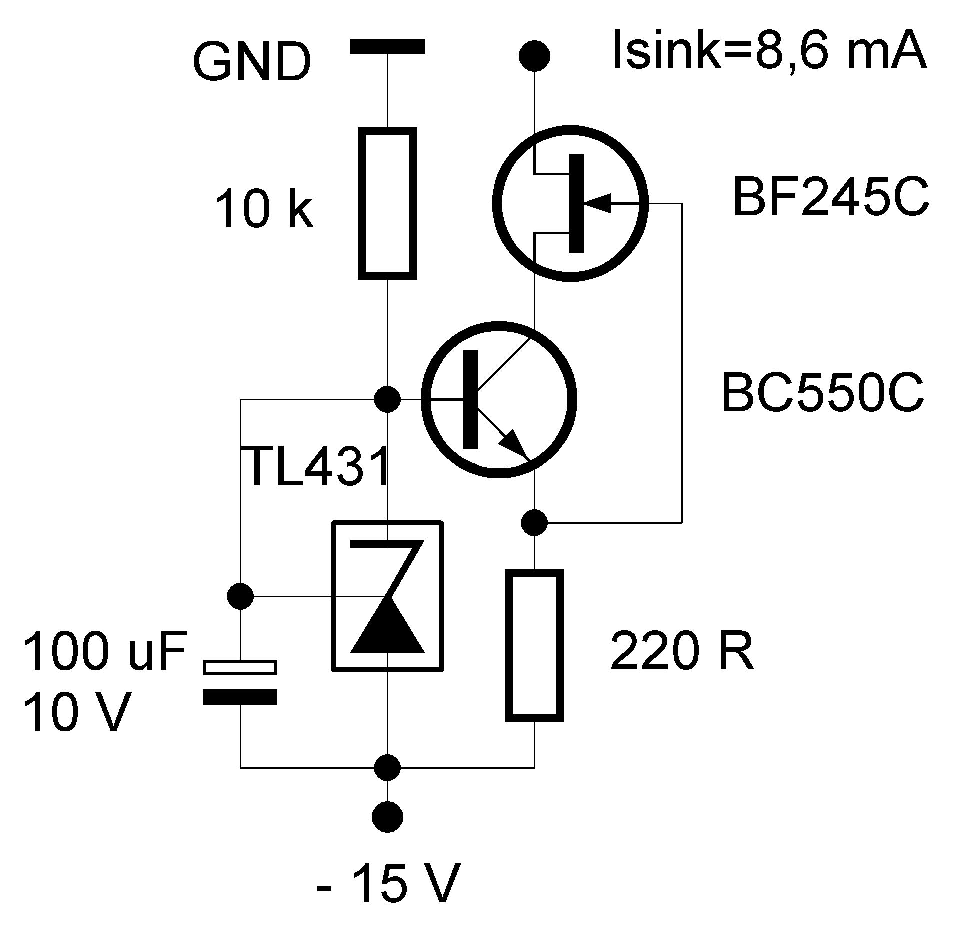

Today I rechecked BJT-J-FET CCS, because it was very late yesterday and maybe I missed something, but hey no, all parameters are the same. I put TL431 instead LT1034 plus BF245C instead 2N4393.
This CCS (also source version) has excelent DC and AC performance. From cold start to idle state, DC current change is only 20 uA max. Repeated AC tests showed no variation in Zout from DC to 100 kHz, noise voltage was less than 50 uV respectively to 8,6 V/1 kohm load, so better than -100 dB. With only six electronic parts this design is a must for audio purposes. Highly recommended!
