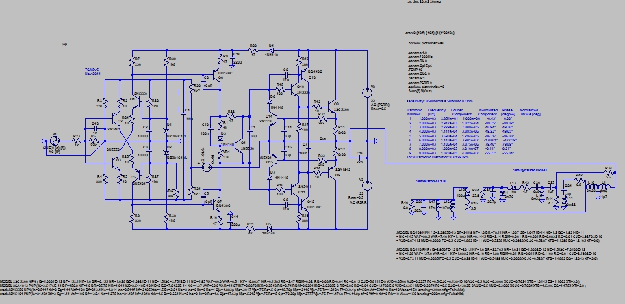

The BJT version of SSA posted here earlier shows as expected very unfortunate sensitivity to complex loads.
The simulation of a 2 way speaker is accurate within 95% of the measured complex impedance of the actual speaker. A critical situation for amps sensitive to reactive distortion is around 330 Hz. There the thd of the amp jumps sharply from less than 0.03% to above 0.6% and such is audible.

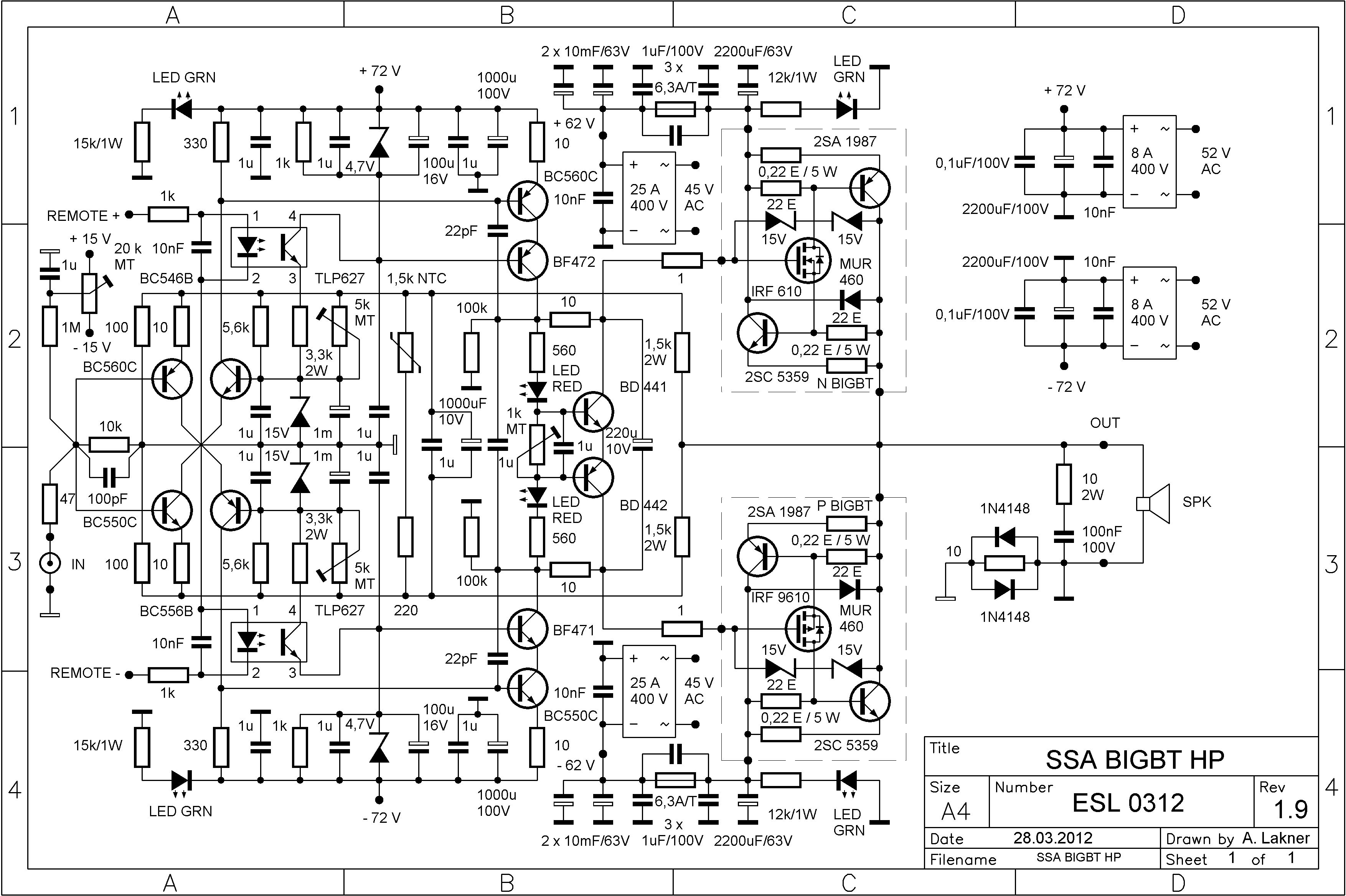

It would be of interest to all of us, if you can verify in sim following tips to lower distortion in SSA:
- replace R26, R27 with CCS
- reduce R1, R2 to 100 ohm and R20, R21 proportionally, to maintain desired voltage gain
- reduce R9, R10 to few ohms to higher OLG
- cascode Q6, Q7
As partial solutions these tips were reported frequently as advancement but I don't remember if ever all of them simultaneously.

I have already reduced R1 R2 to 110 ohms and changed R20 R21 thus that full power is with 1.5 volts input, but that doesn't change the reactive distortion. I oticed further the op of the Vas is too low with roughly 4 mA
it should be 20 mA where ß/Ic linearity is good and ft is max.
I will also try to set the op of the predriver to 10 mA for the same reason because all planar BJTs of this size have their max ft at 10mA and also the max linearity ß/ic.
Will try CCS but am not convinced. We'll see.

I think the basic topology is tremendous. You have attacked the output in a unique manner..where you aim to remove the P to N differences. I have fitted a current dumping error correction circuit on the version I have built. which by the way sounds rather ok...
Now to the house keeping. I do believe that the weakest part of this fine circuit and the very reason why it does not simulate particularly well is the poor relations between the impedance of the current drive and the feedback currents. The basic amp is basically fed from a 1Kohm current source..which is way too low to prevent the feedback currents from modulating the drive-current. This is the main source of error in the circuit and by fitting high (very high) impedance current-sources specs are terrific. I will not show my housekeeping here....But I'am quite sure you catch the direction.
The schematics were published in this thread by lazy cat no changes made except for the complex load.
By grounding the global feedback loop thus the predriver and Vas have only local feedback
I found
the biggest source of distortion are the Vas and the power section, the latter adds high harmonics.
Adjusting R7 R8 thus that i Q6 Q7 is 20 mA and adjusting VR1 VR2 thus that offset is a few µV and i Q8 Q9 is 88 mA the open loop thd drops from 22% to 3%

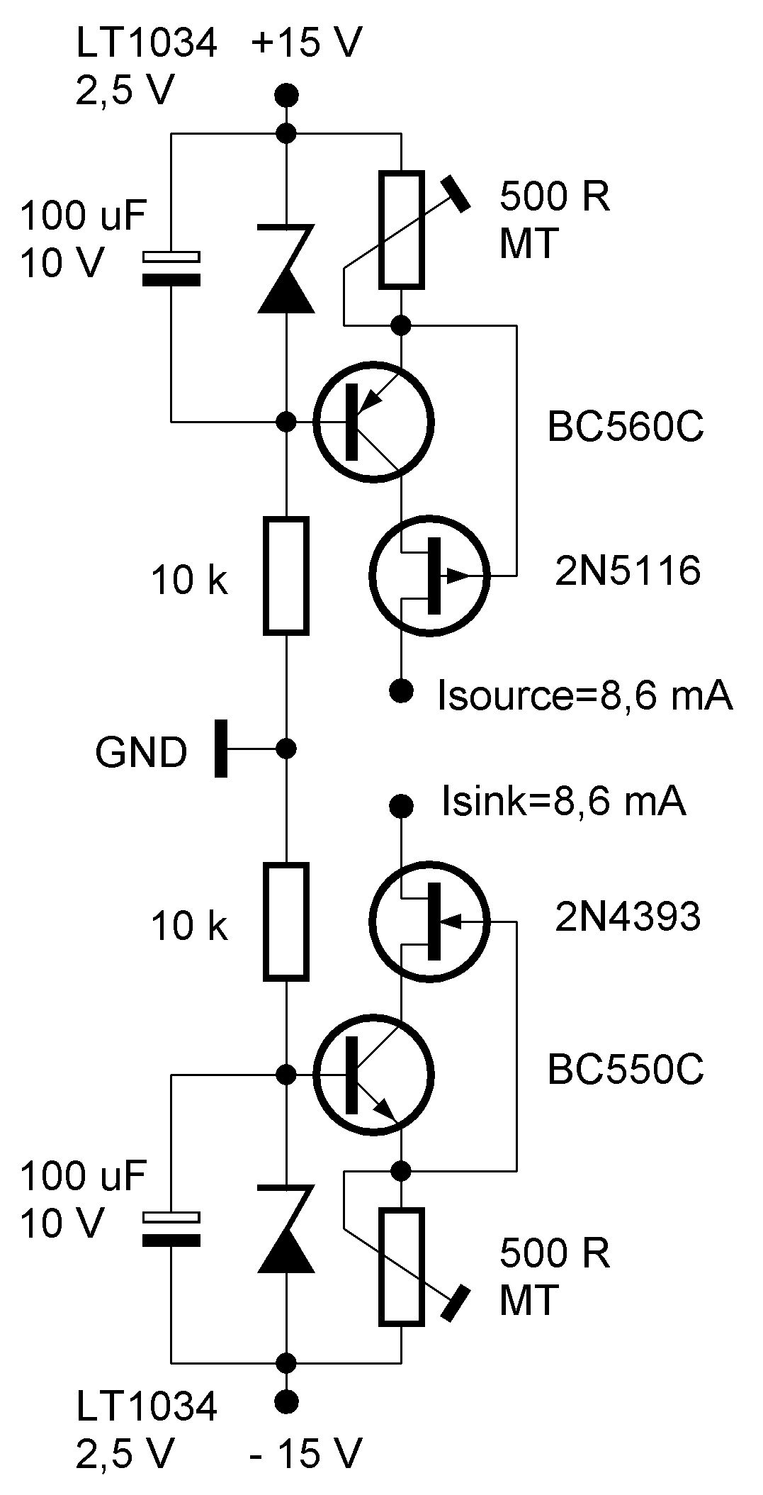

Today I played & messed with different CCS-s to find the most suitable one to replace my trivial FB bridge current injection resistors. The aim was not only to find the highest impedance/frequency ratio but also the best DC current/temperature stability and also lowest noise possible CCS. The winner is shown in attached schematic, which also has among the best performance/parts-count ratio. Now I only have to make four of them (two CCSources and two CCSinks) on a separete small PCB-s and install them in SSA BIGBT HP. ;)
P.S. Dynamic measurements were also performed with load resistor plus serially connected waveform/signal generator. There was practicaly no voltage modulation on load resistor, less than 0,5 mVrms up to 100 kHz at full WSG swing of 5 Vrms.

LC, is this CCS to replace the 3.3k resistor in your schematic on page 224? As I see it, the 3.3k resistor will pass about 15mA current, to a 15V zener.
The current source shown above is for 8,6mA, and cannot supply that current at 15V. Have you reduced the voltage for the bridge, and/or are the zeners omitted ?

No, look here, 8,6 mA CCS replaces 5k6 resistor parallel to 5 k/MT trimmer. CCS supplies/inject constant current to feedback bridge from 15 V potential, previously done by resistor/trimmer. In such a way feedback bridge potential cannot change/modulate injected current, wich is actually collector drive current for input BJT-s. What's left is clear sum/subtraction between feedback current and constant drive current. The result is clear spectral components without modulated side bands. ;)
15 V zeners are not omitted, they provide stabile potential for input cascodes, plus they from reference potential for CCS-s. ;)
