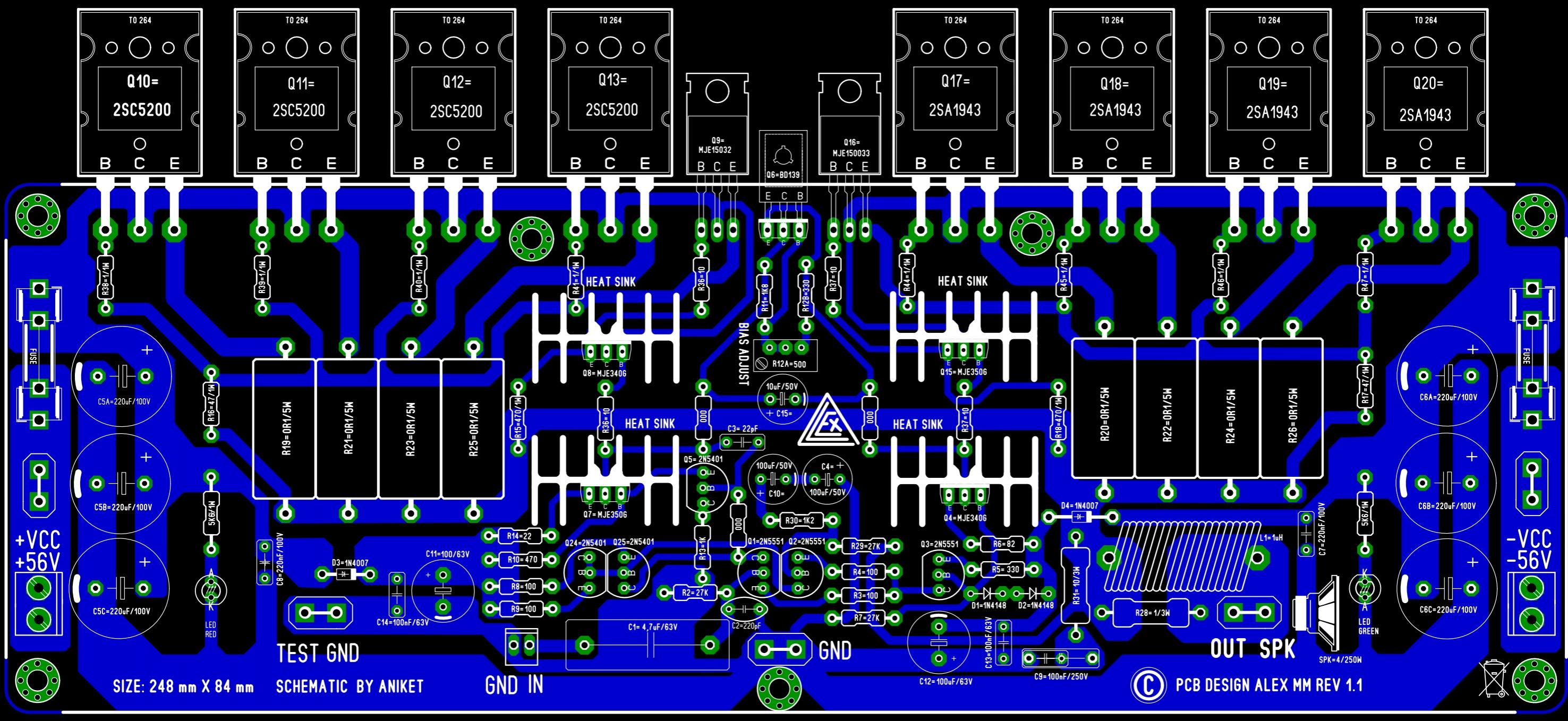

@Aniket just in time rev 1.0 of the amplifier ..... spend all day on layout PCB
Alex.
Great!!!
The master with his art. Thanks a lot Alex mm,
Just a minor change. use a trimmer in place of R12 for bias adjust or better split R12 into a 330R fixed resistor and a 500R trimmer in series.
Many thanks in advance.
Aniket
Hello Alex mm.
There are some minor errors in the component values. and the emitter resistors R15, R18 and R16, R17 are missing for drivers(mje15032/33). Hope these are fixed in the next PCB revision.

...... I think no more problems , corrected @dvv ,I live in north-west close to hungarien border .....
Regards ,
Alex
Thanks Alex mm.
Please post the copper side and component side also. in pdf too.
Aniket
PCB REV 1.1 ALL FILES
...you have, attached below, all files ,you need ,to made this nice amplifier .
Was my pleasure to help again.....
Alex.

Thanks you all , and you have also gerbers attached ...... .
Cheers ,
Alex.

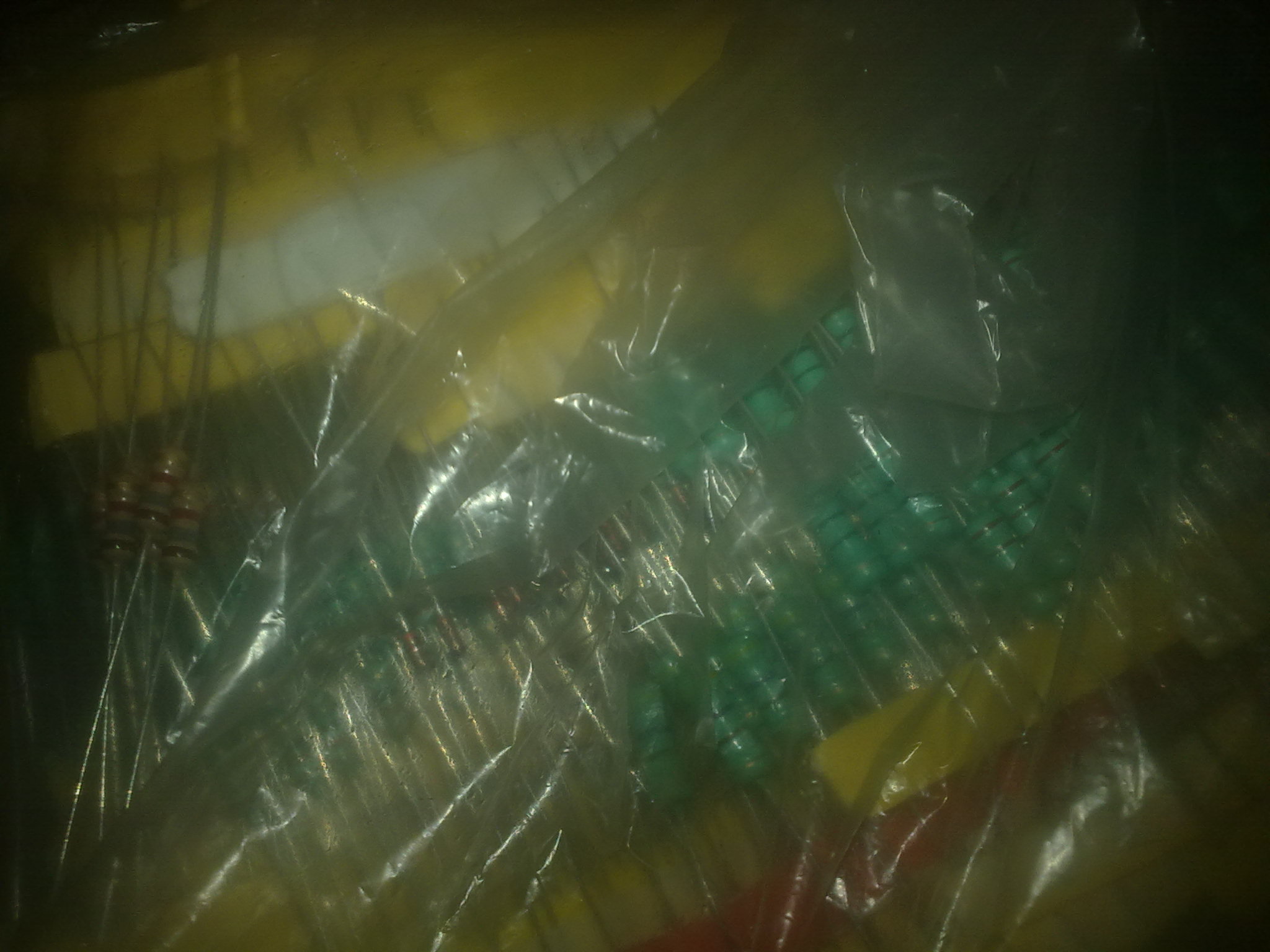

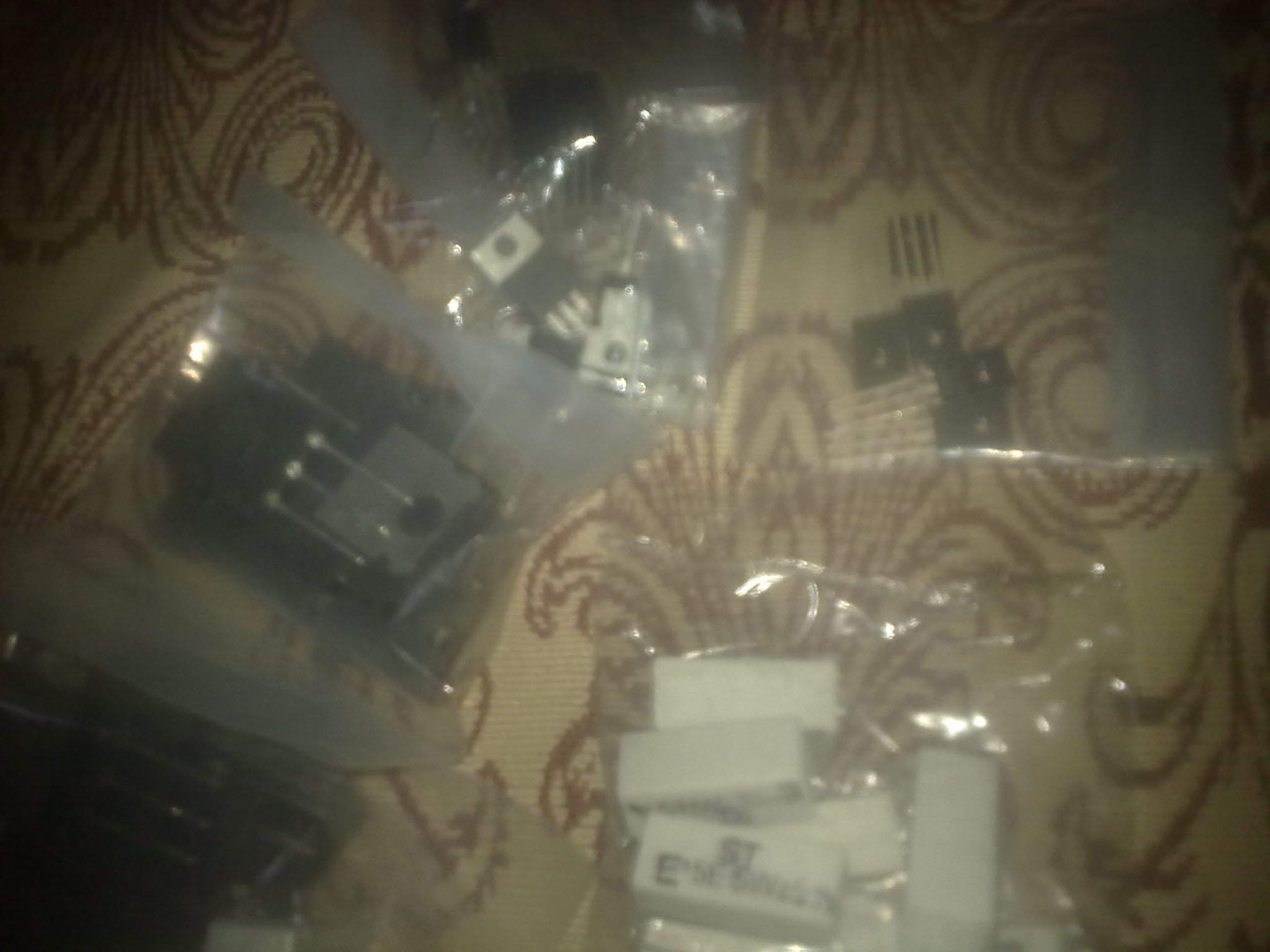

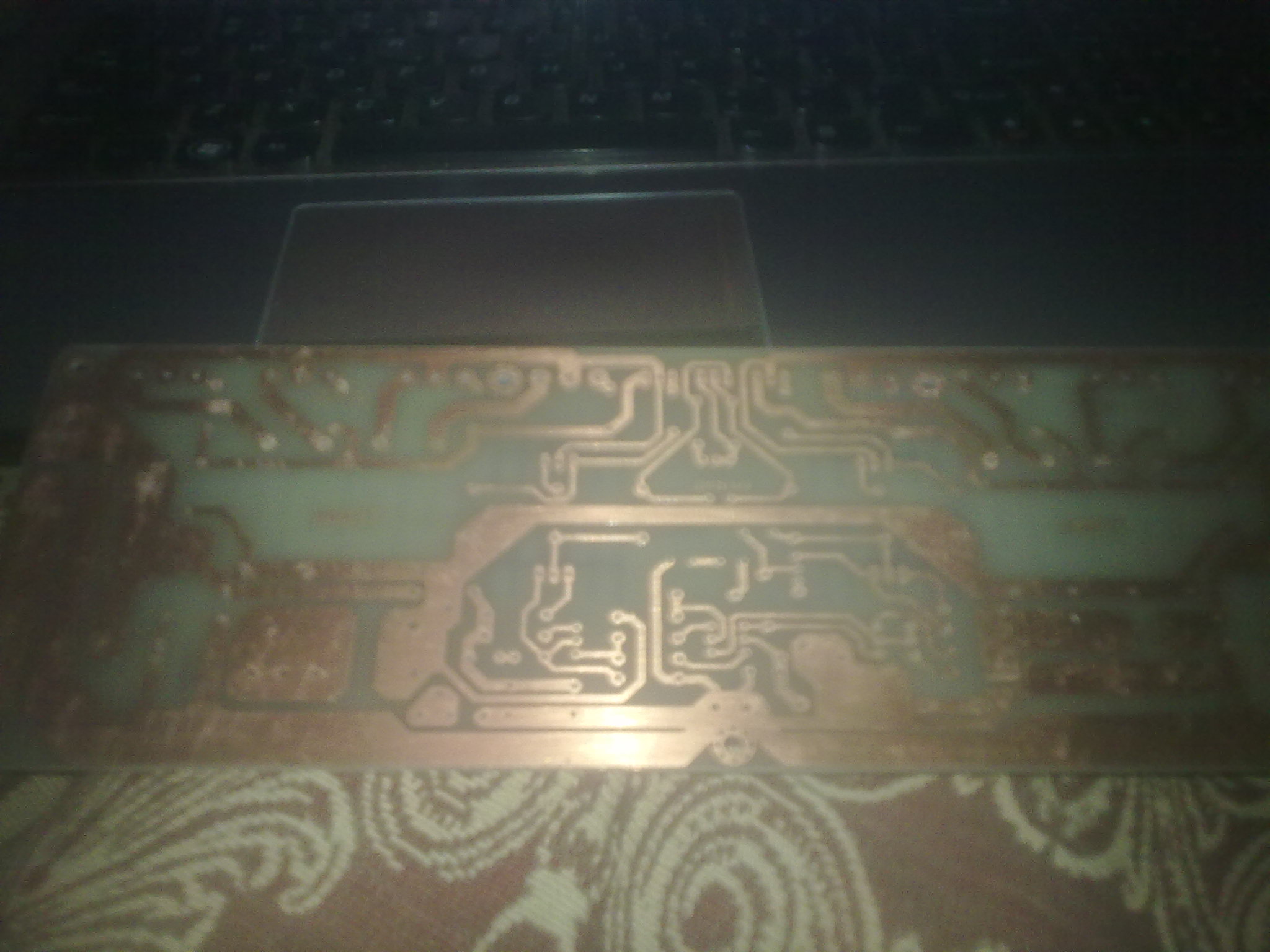

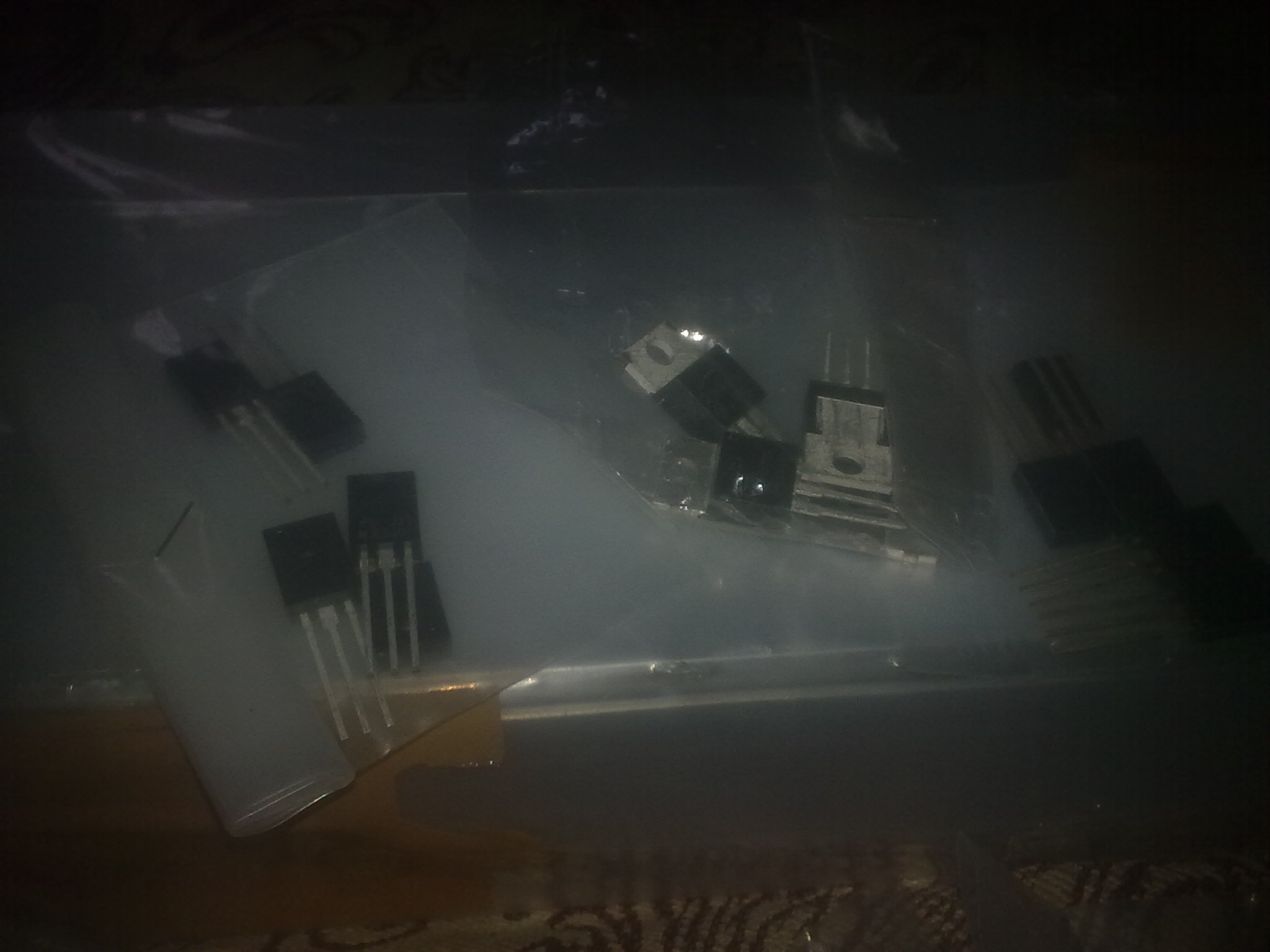

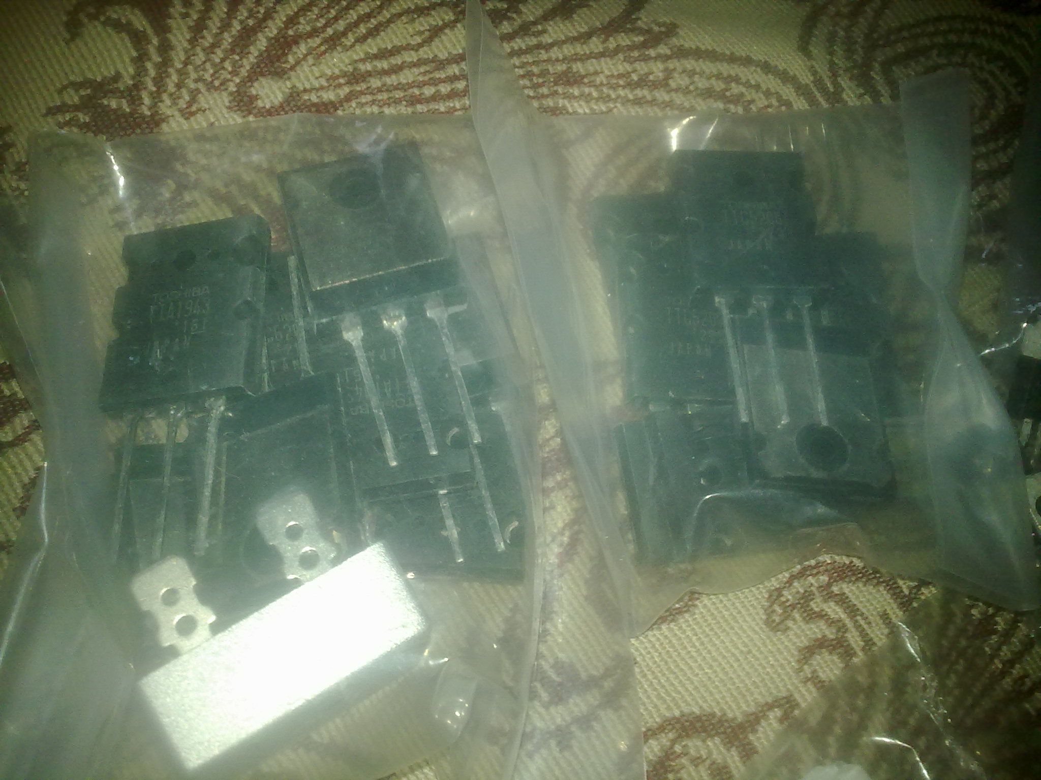

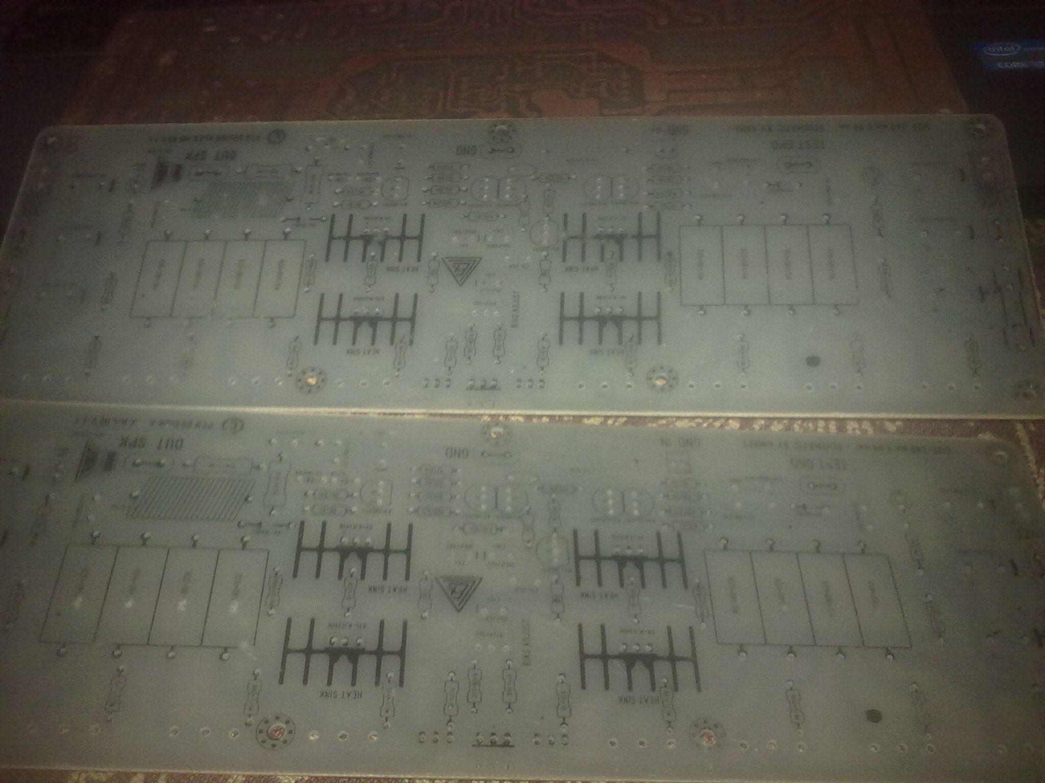

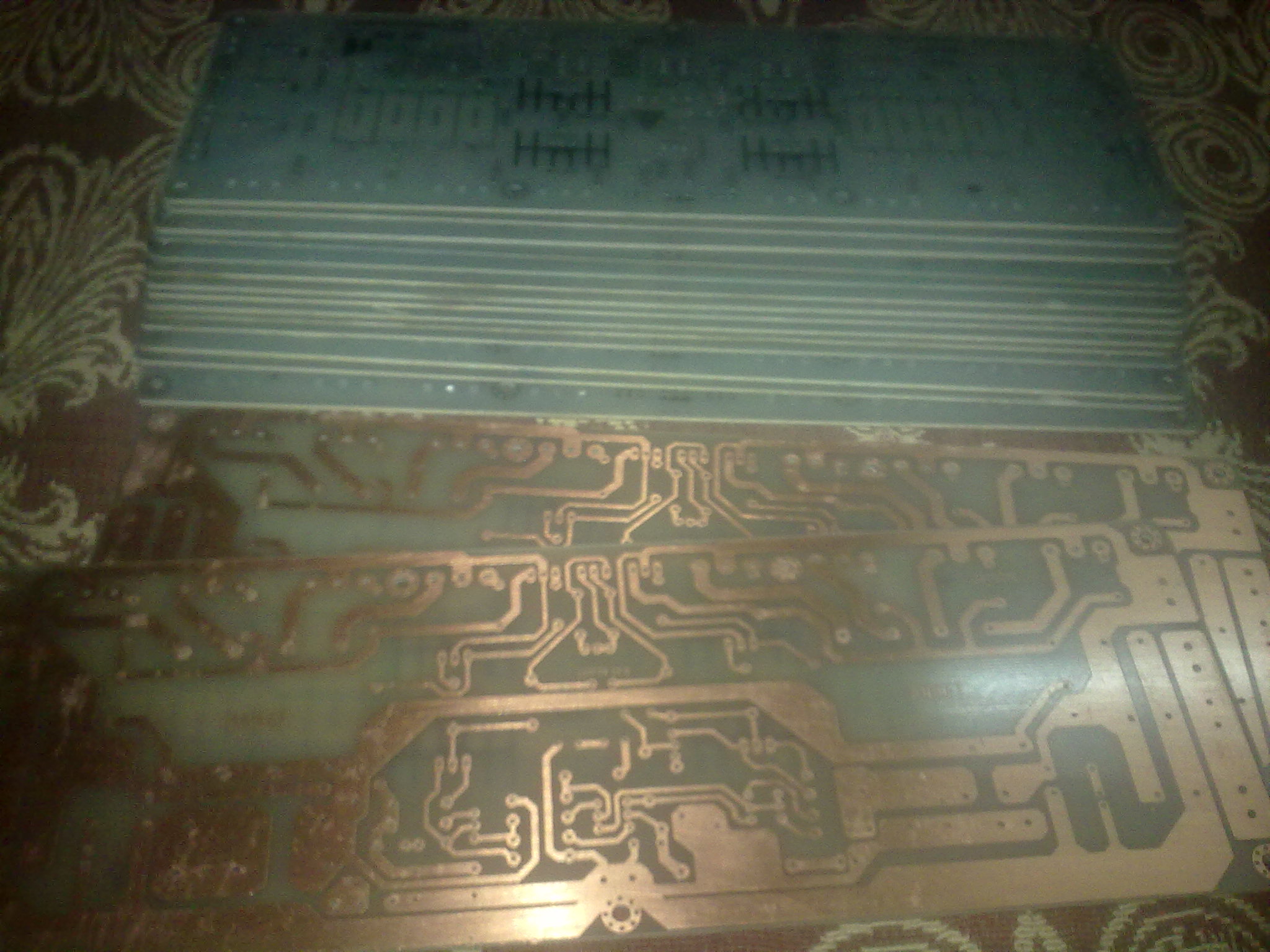

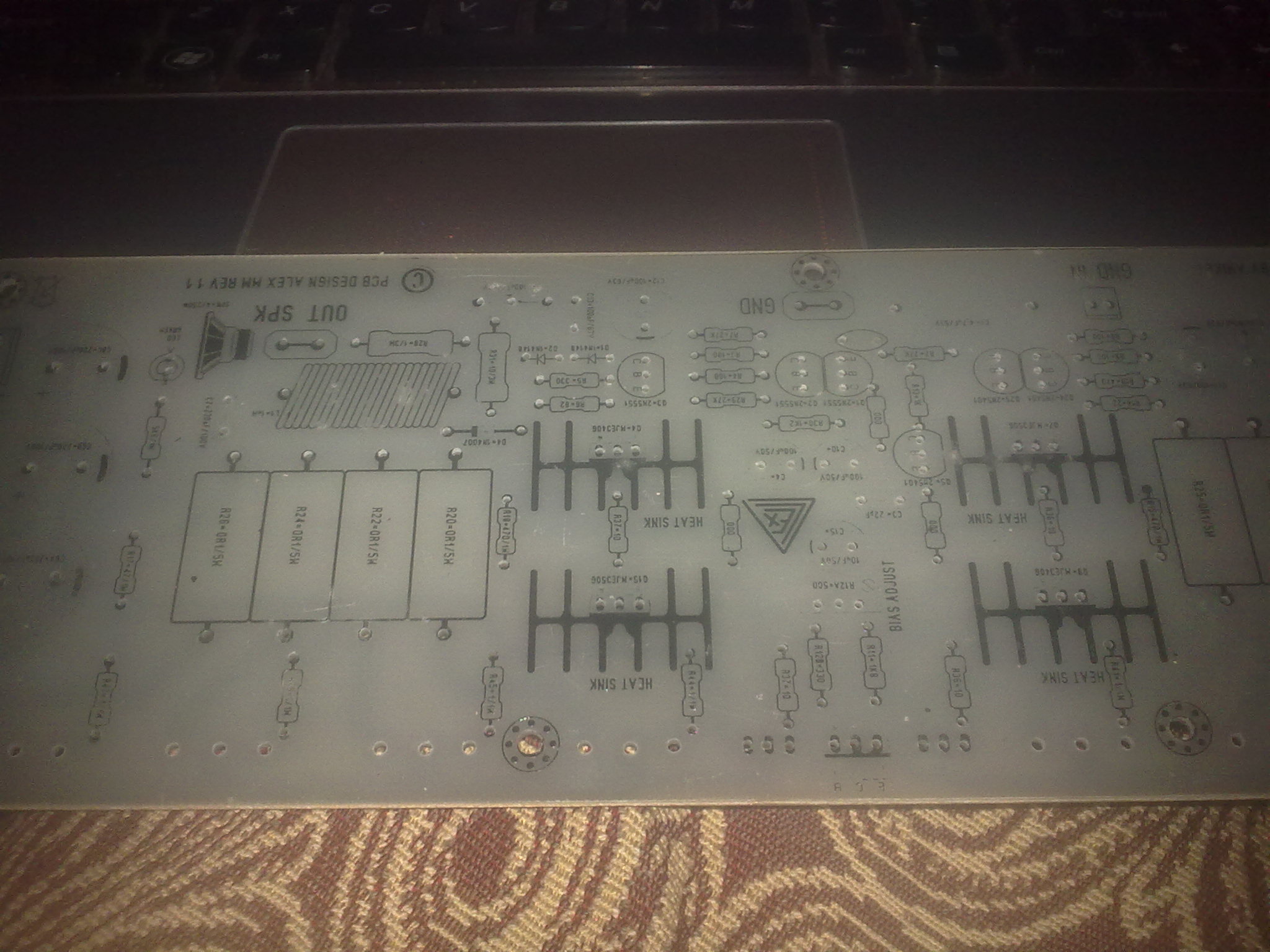

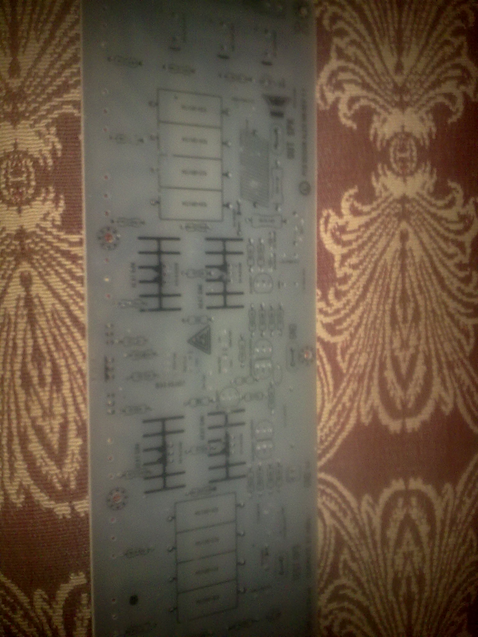

Bought the parts and got some PCB's manufactured. Now, would order a 42-0-42, 15A sec.(1250VA) transformer. Also, need a good airy chassis. Would start populating the boards and post the pics soon.
Aniket
