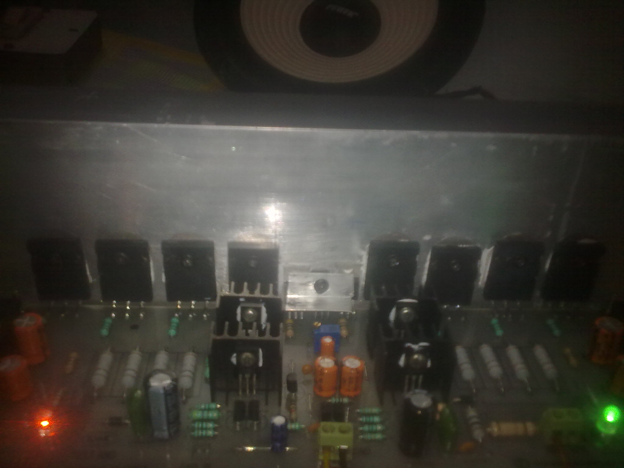

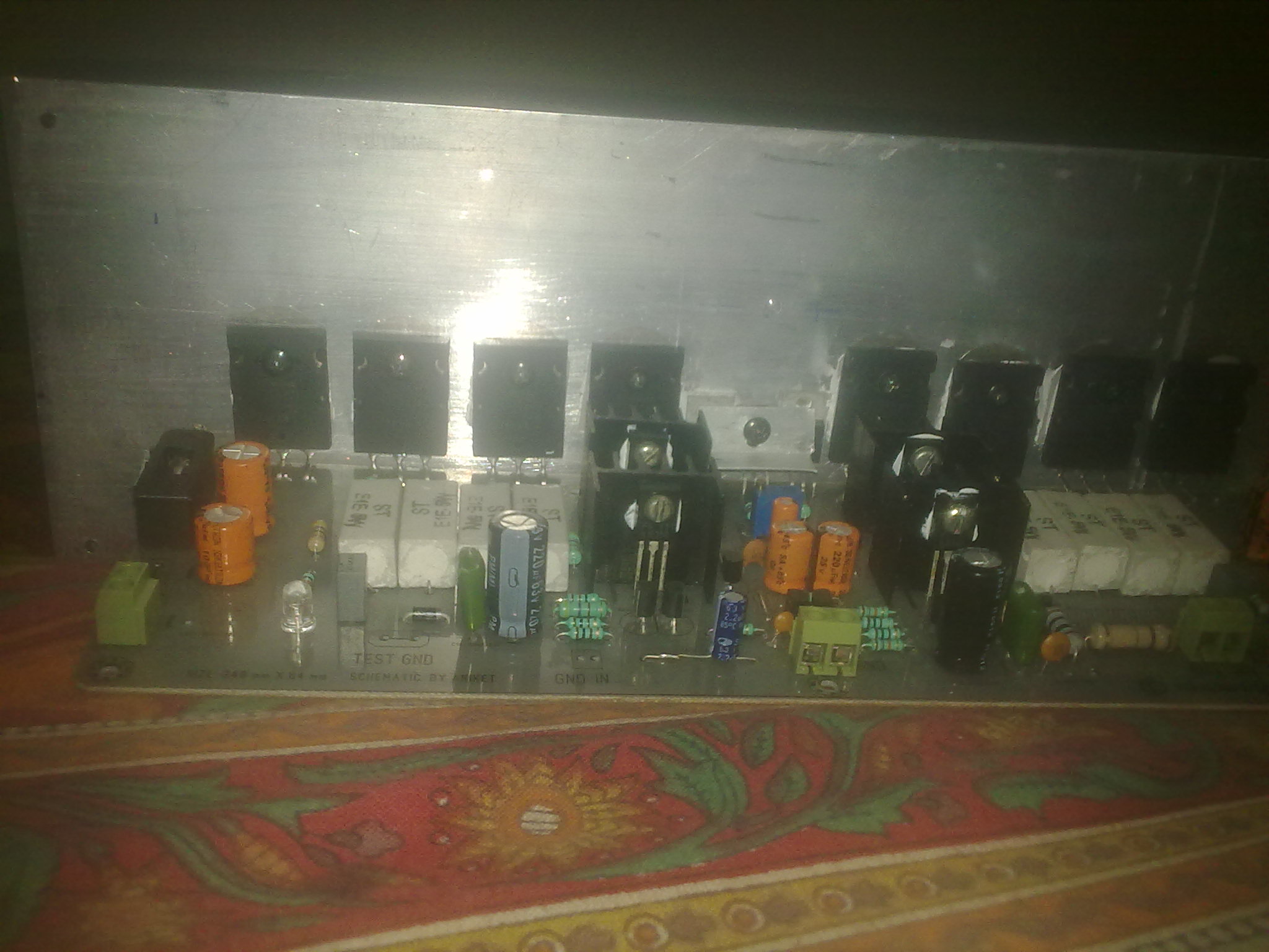

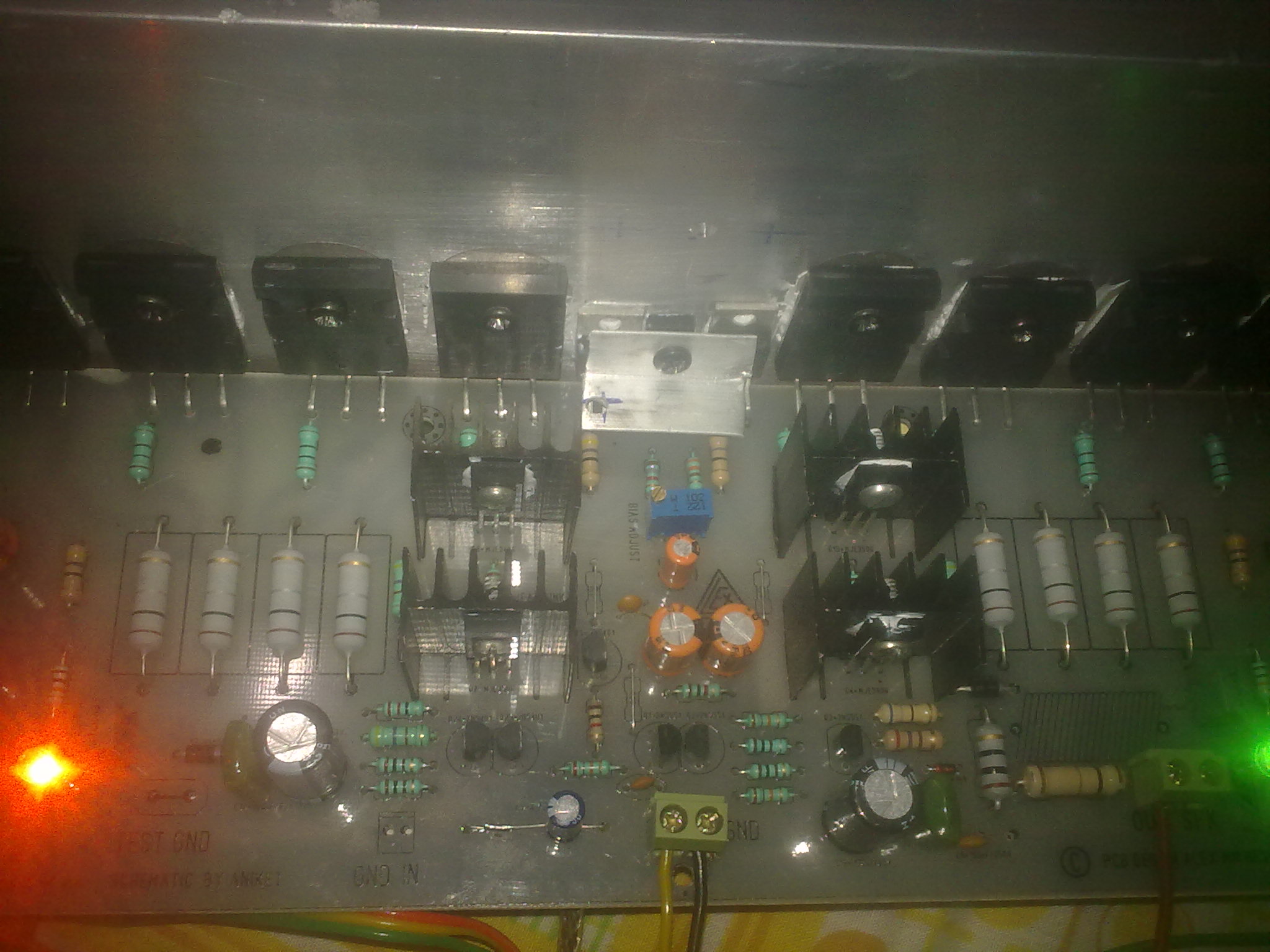

As for 2n5401/5551's, i have replaced them with BC546/556. left them in place. Good.

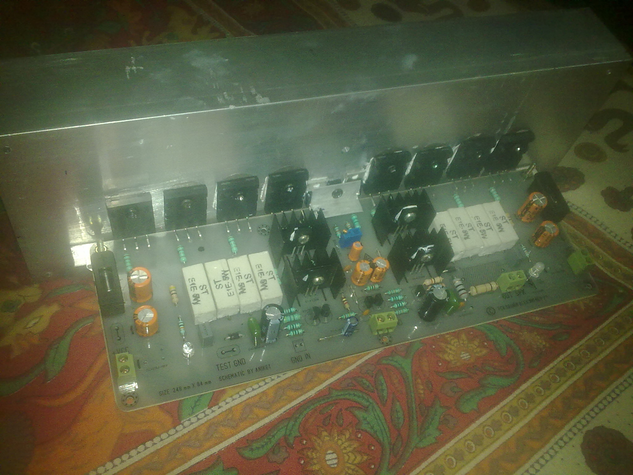

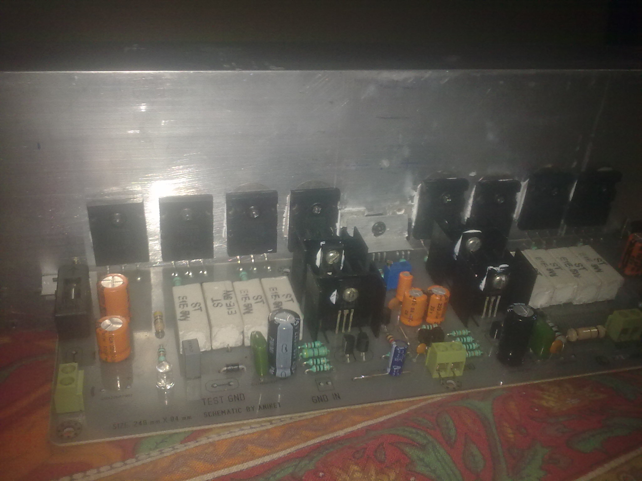

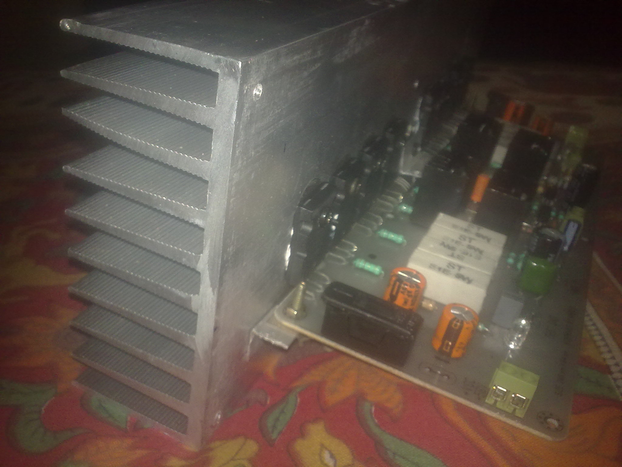

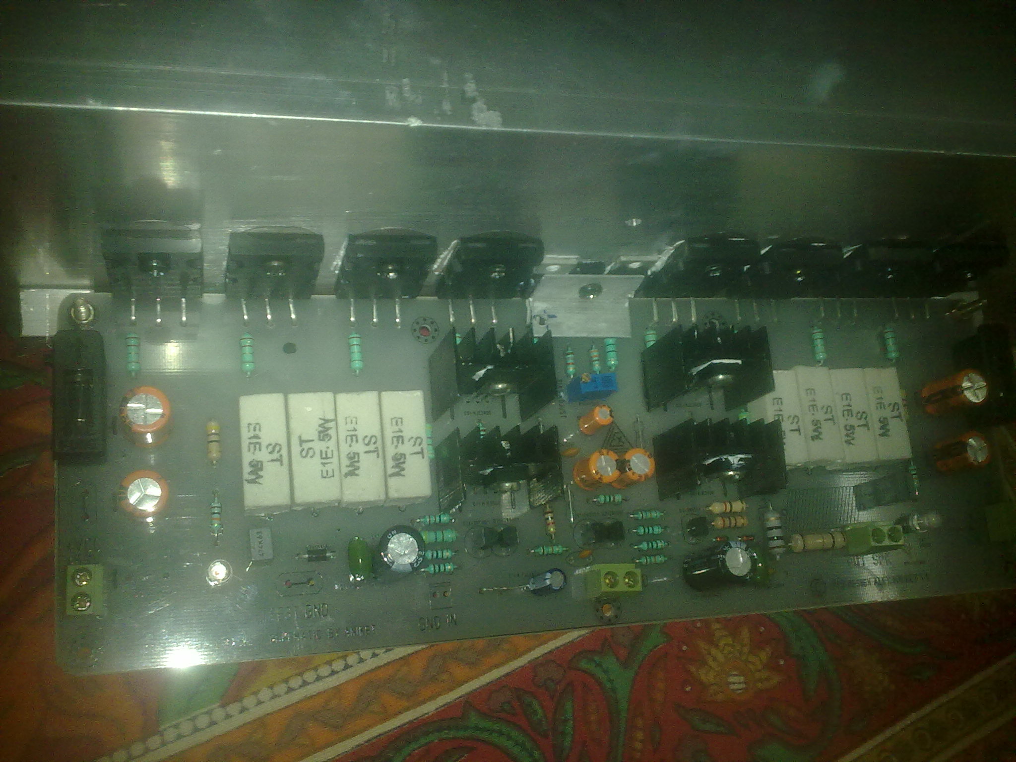

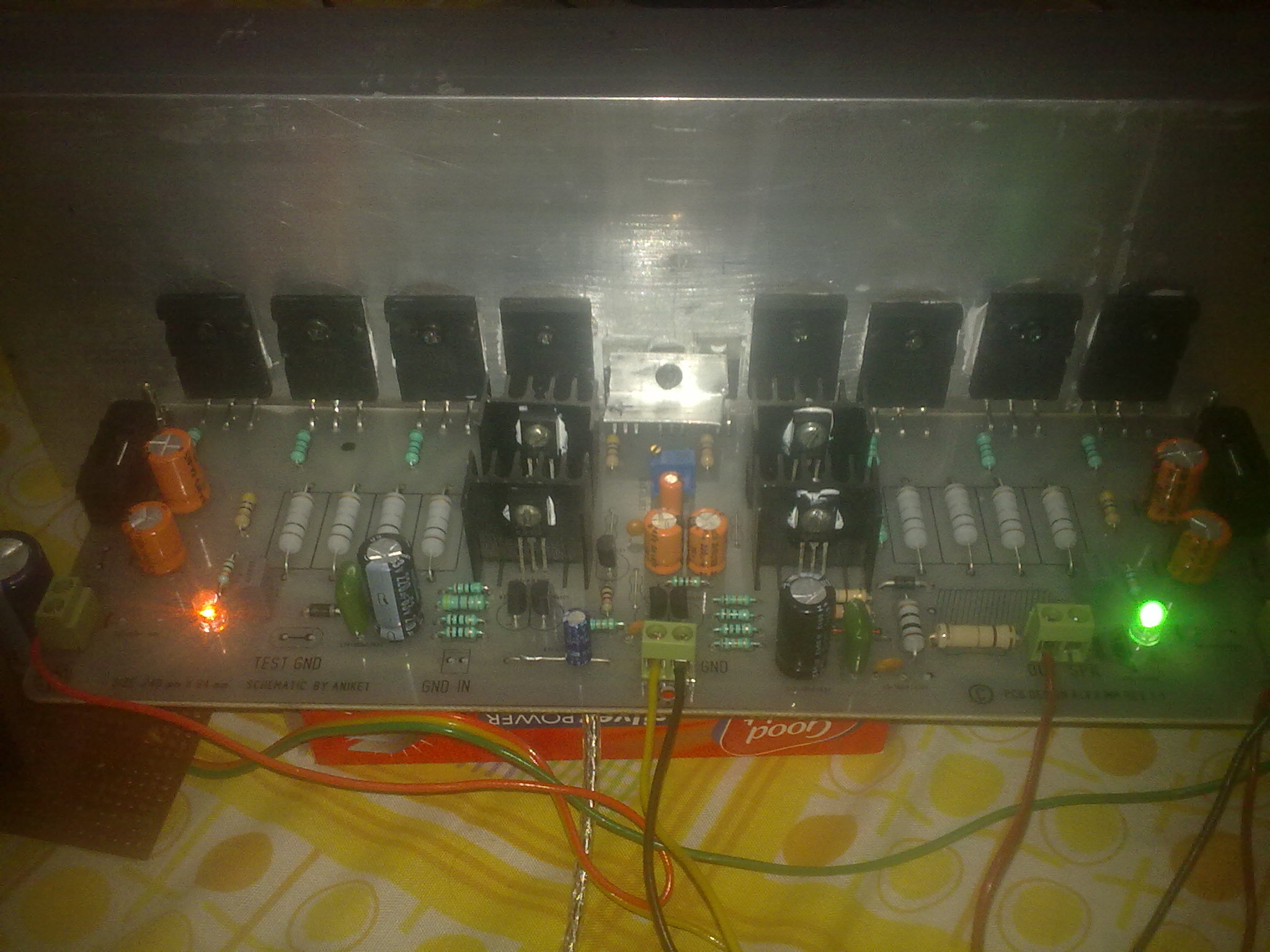

Now, i installed all power transistors and drivers on the main heatsink. Pics attached.
with all 4 pairs of power transistors, there's a problem with biasing. I could not set bias. Earlier i used only 1 pair for testing, i could easily set bias, with the multi-turn trimmer. but it plays music clearly. but there's a problem crept in.
1. i used the same +/-17V supply i used earlier. powered it up, every thing's fine, checked DC offset -2mV and -1.5mV on channel 1 and 2 resp. bias trimmer setting/position intact like i tuned earlier with 1 pair(set at 50mA).
2. now there's 0mV across each emitter resistor, even if turn the bias trimpot, no change, i used a 1k here, but as soon as it is reduced to about 300~330 ohm, bias climbs up instantly showing 110mV across each emitter resistor, and output transistors starts to heat up.
3. I turned it OFF. set bias trimpot at max. again emitter resistors show 0mV across them. played some music, then again bias climbs up at about 60~100mV across emitter resistors. repeated this several times but again same results. as soon as i play some music bias climbs up and transistors start getting hot.
Is the amp oscillating with all 4 pairs installed, i used 47pF miller cap for a start. also there's some difference in voltage across emitter resistors, like one shows 65mV, 2nd shows 58mV other shows 61mV.
also i haven't connected inductor in series with the output.
both channels show same symptoms.
please help !!!

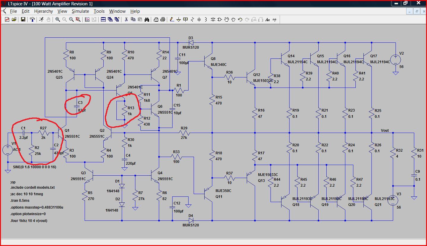

For a start, repost the final form schematic, I no longer which one is your working models, you've posted a few of them. Without any instruments, please.
In my particular case, since I also use Multism, you could send me the msm file, so I don't have to redraw it. Send it to:
dvv@beograd.com
You have been impatient and ran the basic design by us here in record time, you must understand we don't all come here every day, it takes time for it to sink in. Now you are paying the price.
But, not to worry, we were all like you many, many years ago, all this has happened to all of us at one time or another.
In the meanwhile, replace D3 and D4 by 47/1W resistors and try again.
Also, try removing R13, you don't really need it. Just connect the collector to the ground, assuming the ground for it is "clean ground". If it isn't, use a piece of wire underneath to connect it to "clean ground".
And increase those ridiculous 1 Ohm output transistor base resistors. 1 Ohm does nothing for anybody, your bottom value should be 2.2 Ohms at the evry least, and with that type of fast high Ft transistors, start from 4.7 Ohms and go upwards.
Driver base resistor should be at least 47 Ohms, and probably 82 or 100 Ohms.

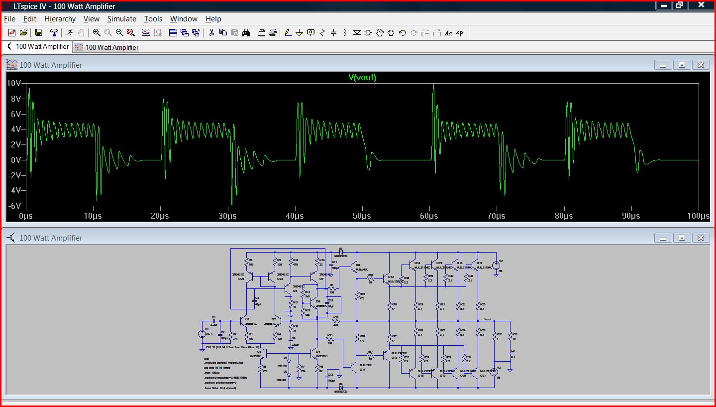

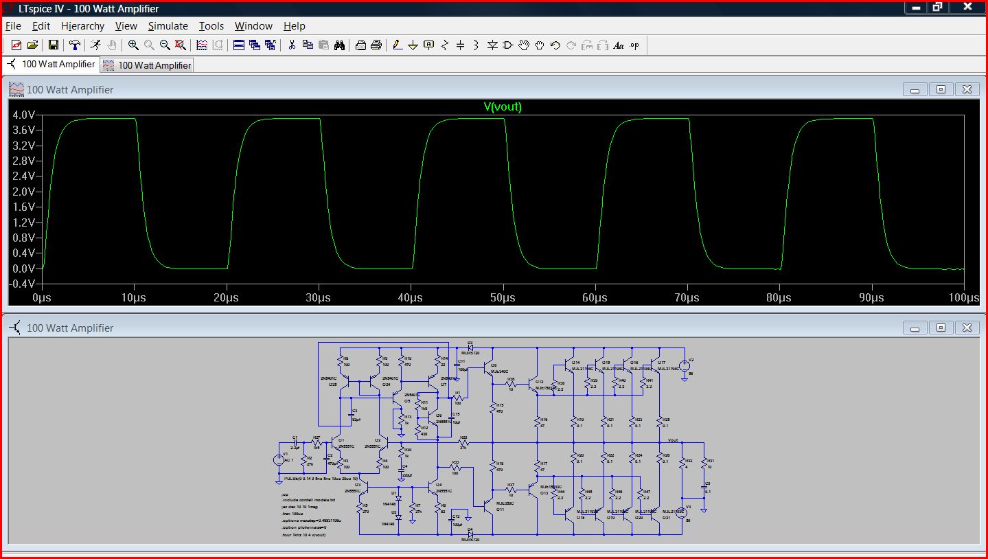

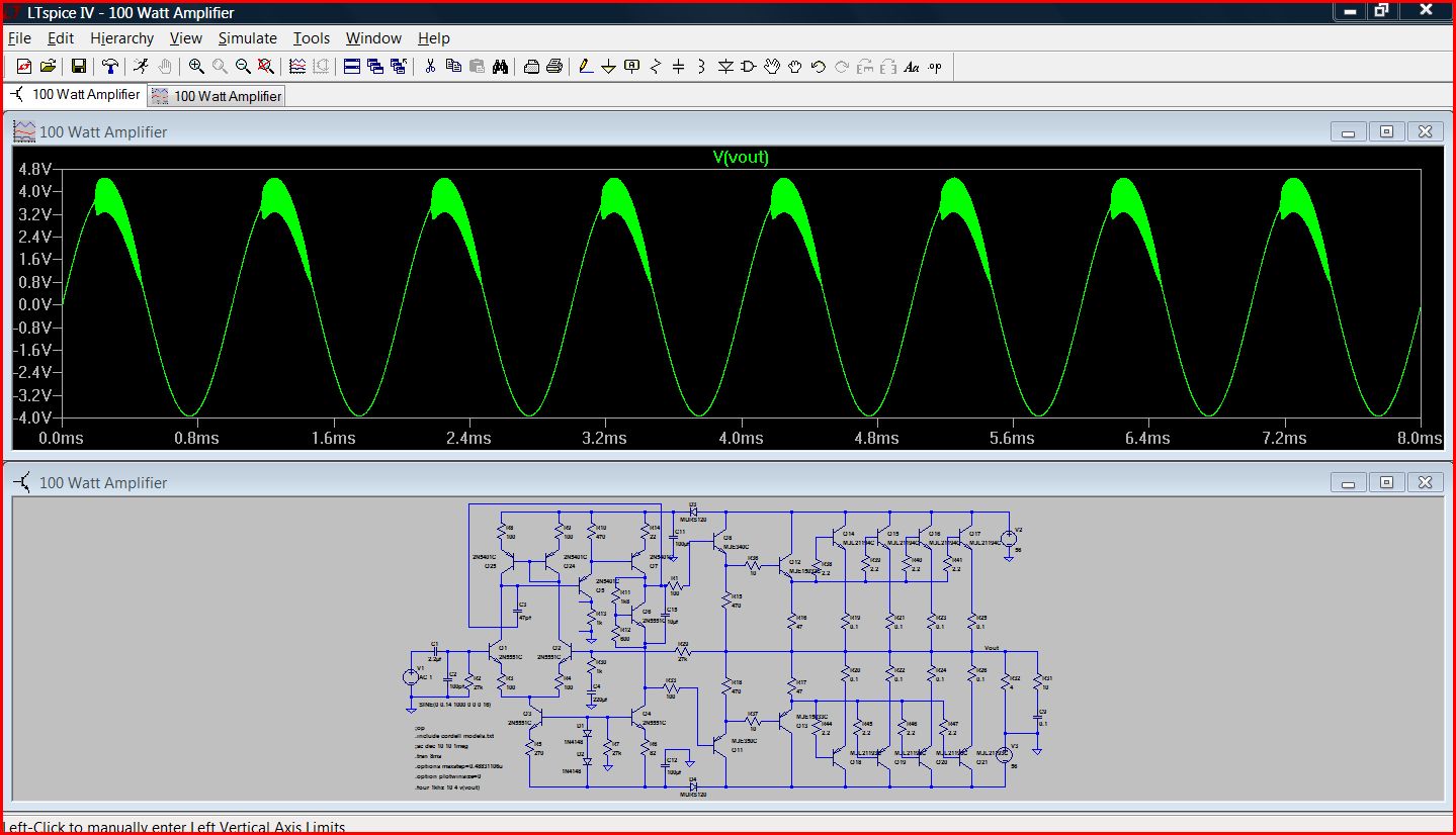

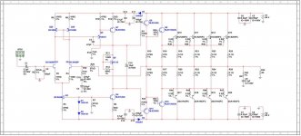

Exact working schematic is attached. simulation file also.
i had increased base resistors to 2.2R earlier before powering up for the first time.
it was working fine with 1 pair of output transistors, but what's the problem when all 4 pairs are placed??? why it's behaving like this.??
All transistors are placed correctly and are insulated properly.
Confused..
Confused..
Confused..
Thank you. I'll probably have to redraw it anyway, it seems you have version 12, mine is an older 10.3 and will probably not take it in, but that's all right.
As you line up output transistors, you put their capacitances in parallel. Hence, you need to look hard at the base resistors.
For High Ft transistors (Ft of 15 MHz and upwards), you will need base resistors of AT LEAST 4.7 Ohms, and I have seen as much as 22 Ohms. For example, John Curl used 12 Ohms in his HCA 100W amp. Harman/Kardon uses 10 Ohm resistors in parallel with RF chokes, Marantz uses 22 Ohms in some upmarket models, etc.
2.2 Ohms as you used them would probably be quite enough for older generation power transistors, with a nominal Ft of 4 MHz, such as Motorola/ON Semi MJ and MJL series like 21193/21194, MJ 15xxx, etc.
Also, your emitter resistors are far too low values. They are bias spreader resistors, and a low value of 0.1 Ohms assumes at least about 150 mA bias PER DEVICE, if not more. At 110 mA bias, you will need 0.22 Ohms, at around 90 mA bias, you need 0.33 Ohms, and so forth. It's fairly complex because you need to take into account the ehating up of the output devices, emitter resistor values are defined by calculations - please refer to Bob Cordell's book on this topic, he is very clear about defining overbiased, optimally biased and underbiased
My point is, you can't just stick in a low value and hope for the best. Low emiiter resistor values will produce less THD, but will go wrong elsewhere. In my view, your amp is currently underbiased, and very possibly unable to bias properly. To make amtters worse, you left out a trimmer in your bias circuit, and you now have a practical lesson why that is a bad idea.
Doesn't mean the problem cannot be solved, of course, just means more work than absolutely neccessary.

Aniket, in your final circuit a couple of posts back a couple of things stood out. The input filter is ill defined relying on the impedance of the source and also loads the source capacitively. Also R13, the 1K collector load resistor seems an unlikely inclusion.
I threw the original circuit into simulation and found it unstable as you can see, even at just 1 watt and 1khz . A couple of "off the cuff" changes resulted in a great improvement. The bias current also altered the "instability" greatly.
The squarewave simulation was at 50Khz.
The final 50 KHz squarewave sim is with the altered circuit.
@Aniket
Did some simulating, and here's what I found:
1. Signal generator has no known output impedance - it should have been equal to the output impedance of the preamp, or standard 600 Ohms;
2. C1 would have done better being something like 2.2 ... 10 uF;
3. C2 (220 pF) is hanging on in the air for dear life, so to speak. It has no preceeding reistor to give it any meaningful corner frequency and relies on the source output impedance for that. Assuming a low source output impedanse of say 120 Ohms, the corner frequency would be around 6 MHz, meaning it is quite useless in practical terms. If it had a say 1k resistor preceeding it, and the cap value was say 390 pF, it would have its -3 dB point at around 200 kHz, quite high and low enough;
4. The current generators Q3 qnd Q4 should have been separate by a resistor, value 470...1k. This would ensure smoother operation and less interaction. Also, D1 and D2 should have been bypassed by a say 22...47 uF capacitor, if for no other reason, than just in case;
5. I would have eschewed D3 and D4. Diode pumps, as such circuits are called, and notoriously finnicky and can bleed one to death on occasion. simple say 47...100 Ohm resistors would have been much preferred. Also, cap value of 100 uF is too low, they should have been 330 or 470 uF;
6. R1 and R33, predriver base resistors, are not really necessary if they already exist in the driver and output transistors. Can't hurt, but are an unnecessary complication;
7. As mentioned several times on the forum, MJE 340/350, while being good transistors, are band limting the amp. The following driver transistors have an Ft twice theirs, as do the output transistors. A poor choice;
8. R1(1k), attached to the collector of Q5, is connected to which ground? The power supply ground ("dirty") or the signal ("clean") ground? Why do you need it (just asking)?
9. Why have you not installed a feedback diode across the VAS, in parallel with the Miller capacitor? Does wonders for the sound, but it has to be a fast one (e.g. BAV 20) ...
10. Emmitter resistors (R19-26) are way too low for two key reasons. The first is that they require a LOT of bias current, from 150 mA upwards per transistor. The second is that, according to zour writing, this amp will be used at parties, so it is reasonable to assume it will be driven hard; some addition feedback would be welcome under such circumstances and relatively low load impedance, especially if it should drop lower than nominal (as it surely will, the question is only where and by how much);
11. According to my simulator, you have a solid DC offset under all opearting conditions, it never goes below 150 mV, and, under extreme conditions, climes up to 3V. This is unacceptably high and your speakers will NOT like it, and there are no means of correcting it;
12. Under conditions signal zero, load 4 Ohms, your bias appears to be some 230 mA per transistor. At 56V, that means your power stage is dissipating 103.4 Watts under idle conditions. While good for the sound, this is bad for your power bill and very bad for your heat sinks, which are not likely to hold out for long, and this heating up may explain the rather large offset;
and so forth. The point is - back to the drawing board. Also, Alex may have to redo his artwork to include some components, fortunately small and few in number, there should be space according to the photos.
Before proceeding any further, I would like you to think hard on several issues as per the notes above.
IF you are willing to do that, and obviously if Alex agrees, you have a choice:
A) Use the existing boards with added changes and hope for the best, or
B) Add some completely new circuitry to make it safer to use under duress. This would include building in overcurrent, overvoltage, excess heat and DC circuitry, which would, in all truth, complicate things quite a bit. This also means completely new boards.
To help you realize what I'm putting on the table as choices, I will send you two schematics, one of existing but modified, and another of what I am proposing. Obviously, if you go for what I propose, I would extend any and all help I can, and really, it's all much easier than it looks. And it leaves you with knowledge to use it over and over again, in any other later project.
Lately, I have been experiencing unsurmountable problems with uploading pictures onto the forum, I have yet to discover why. Therefore, I will need to send it to you directly, for which I will need an e'mail address of your choice, just let me know it at my private address dvv@beograd.com.
P.S. That 1 Ohm resistor (R26) in parallel with the 1 uH inductor is also uselessly low in value; replace with 4.7 Ohms/2W.
problem solved
Thanks all,
amp works good with more than a few modifications.
1. increased the value of C3 to 100pF from 47pF.
2. increased the base stopper resistors to 10 ohms and driver base stoppers to 47 ohms. all resistors matched.
3. changed the emitter resistors to 3W type. the 5W resistors installed earlier were different in their values, like 1 showing 0.12 and other showing 0.16. so changed them to 0.1R 3W matched resistors.
4. increased the VAS current to 7mA by reducing R6 to 68 ohms.
5. done with the changes.
i had already installed the bias trimmer before even powering up for the first time. a fixed resistor is only shown in the simulation.
connected the amp to the same +/-17V supply i used earlier, without any load and input connected. checked output, shows -2.5mV. fine. checked voltage across 1st emitter resistor, shows 0V(bias trimmer was turned to max resistance). gradually turned trimmer clockwise to tune bias. at about 60 ohms, voltage across 1st emitter resistor is 7.5mV, that equates to 75mA bias current. fine. checked across all emitter resistors on both sides, each shows 7.5mV across them, except one which shows 7.4mV. fine. done with the bias setting. kept the amp on idle for about 30 mins. Checked bias again, it was constant at 75mA per output transistor. all good.
then, connected a speaker and laptop as audio source. good sound again. kept it running loud for 25 mins or so, checked bias again, constant at 75mA.
again connected to the speaker and laptop and listened to some bass songs. bass is really punchy and tight, good control over cone movement.
carried out the same procedure for the other channel also. both the channels working fine now. DC offset is -2.5mV and -8mV for each of the channels.
I am happy, amp is working great.
soon i would get the power transformer 40-0-40V15A AC. searching for a good airy chassis.
Aniket
