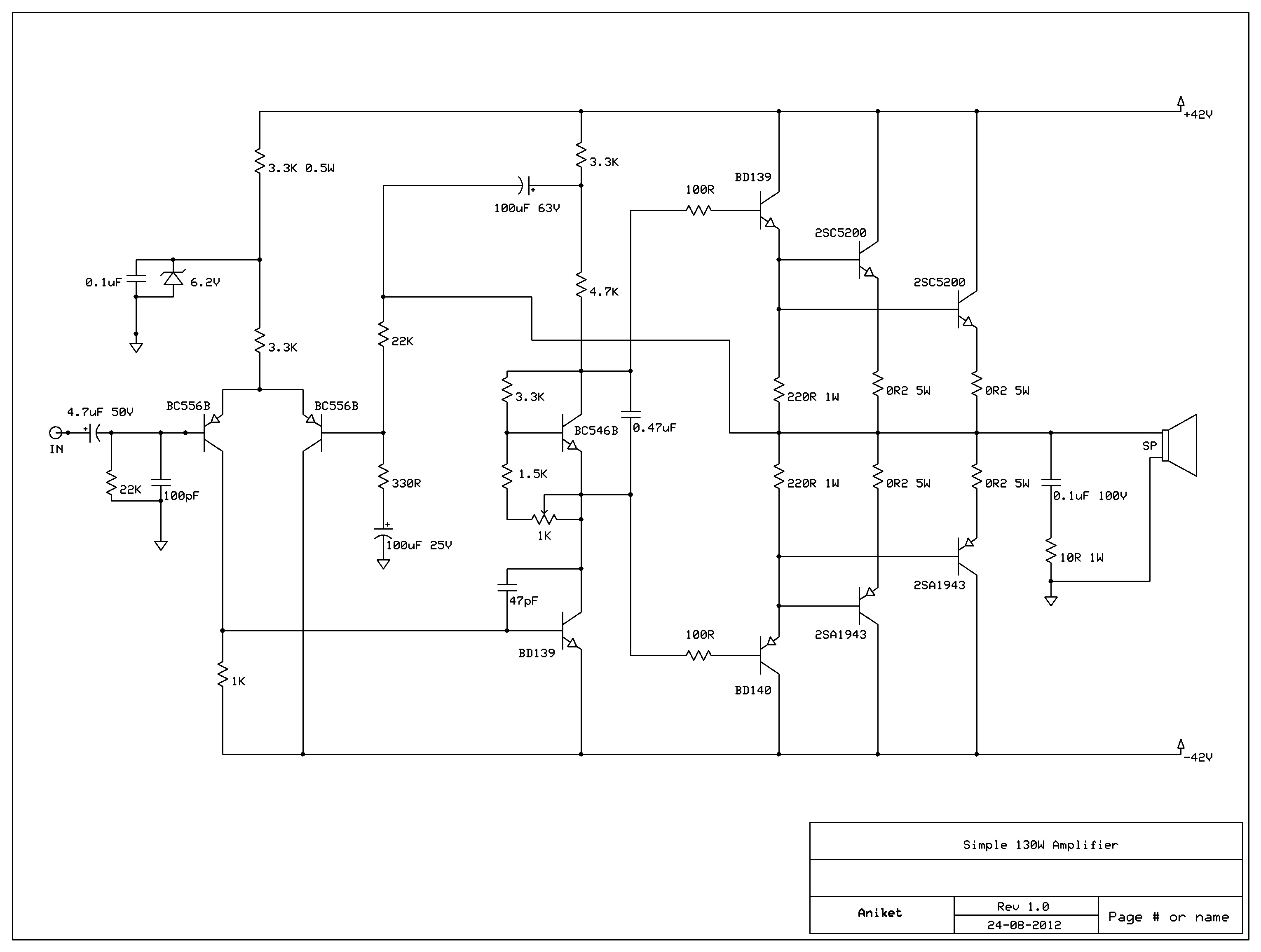

Firstly, my speakers are rated at 400W@4R(a 12" pioneer 400W 2ohmDVC sub and a 50W 4" tweeter), so, I need a 250-300W@4R amp. I am gonna use it mostly at home with moderate listening levels. I listen to all kinds of music, but I am kind of Bass-head, so sometimes volume is cranked high. Also, it would be occasionally used for partying in a medium sized hall.
Secondly, I am currently using my old faithful 130W amp(schematic attached, also pics earlier in the thread) and I dont want to modify/tweak this amp, I am happy with it as it is. It has been used continuously for 5-6 hrs several times at max. power and it sounds nice and has proved reliable. So its often pushed hard , but this amp is underpowered for my speakers. Attached are links for the videos of my speakers banging with this amp.

Regarding the schematics you have posted, they are all well known designs, but from like 35 years ago. Trust me on this, we have come a long way since then, much has been learnt and done, partly due to the research of many a good man, and partly due to the fact that semiconductors have become dirt cheap in comparison with 35 years ago. Quite simply, we can use a lot more of them without feeling the price crunch, and it was this that redifined the minimum approach.
Rather than have me extoll virtues of modern design, I strongly recommend you obtain a copy of Bob Cordell's book. It's an ABC guide to designing amplifiers, with detailed and clear explanations and, in many cases, with all the required maths and procedures for this or that.

Dear Sir Dejan, thanks a lot for all your support. I am a computer engg. aged 24 with a keen interest in audio electronics since childhood.
My speakers are rated at 91dB/2.83V/1m. freq response 20-220Hz for woofer and 500Hz-25kHz for tweeter-95dB sensitivity. 3.5 cu. feet ported enclosure tuned at 37Hz.
As for the book, i have both Bob Cordell and Douglas Self e-books in Pdf.

To cut a long story short, I would suggest that you go for a decent 100/200W into 8/4 Ohms, with say 1.5 or 2 dB dynamic headroom. In return, let it work in pure class A longer than usual, meaning make the bias (quiescent) current not the usual 30-50 mA, but say 110-130 mA. My experience is that you got what was there to get by around 130 mA, nothing left to be gained above that, except for going all pure class A.
Use 4 pairs of output devices, Toshiba's 2SC5200/2SA1943 are a good choice, Motorola/ON Semi's MJL 3281/1302 an even better one. I have tried the "4" versions, the ones with the integrated diode, and frankly, I was not pleased with what I got (I have been using Motorola power devices since the mid 70ies). The problem is finding the real deal, not fakes, it's a problem we all have.
