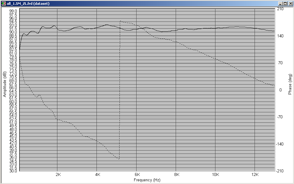

It's funny how looking at the same thing in a different way can give a completely different perception. To my untrained eyes, looking at my speakers response with a linear X axis looks much better (especially when limiting the freq to 13K...
I tried it because of the comments about linear phase, and whilst I don't think that my speaker is exhibiting linear phase (if I understand properly what that means) it gives me a different view of things.
Can anyone post a plot of a speaker that does exhibit linear phase so I can compare

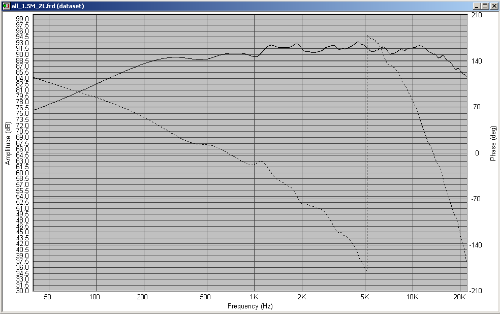

The plot below is from 100Hz to 13Khz and was measured using holmimpulse. I limited to this freq range mainly to get more "room" at the lower frequencies, but also because it looks more impressive without the droop that starts at about 14K since I can't hear past 13K anyway for me it is fine...
The second plot is the same response plotted with a normal log X axis.
What I'm wondering is whether the difference in slope for the mid-bass vs the tweeter is driver or crossover dependent, ie is driver selection the critical thing, or the crossover design? I'm leaning towards crossover since the sim for a 4th order shows the slope being steeper for the mid-bass unit.

Probably more driver dependent.
In general terms you will see an average slope over the woofer region and average slope over the tweeter region (if a 2-way) and those slopes are proportional to unit delay and dominated by the driver's physical depth. Crossovers, if well done, will give a smooth link between the units and likewise a smooth phase transtion. With higher order crossovers, though, you will often have an 180 degree + phase transition to give best response.
