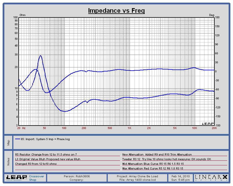

Hello David
1 - transient information is being discarded - quite important I would think when we're talking about music . The "flat frequency response" you refer to is a steady state measurement.
I am have a bit of trouble understanding what transient information is being discarded. Could you please clarify?
2 - the total system output (sum of driver and crossover responses).
Here is a measurement of a clone system I built using 24db acoustic slopes. Speaker in my avatar. Looking at the measured response it meets the +/-25 deg from 80Hz to 18kHz requirement. Would you classify this as a linear phase design??
Rob:)
