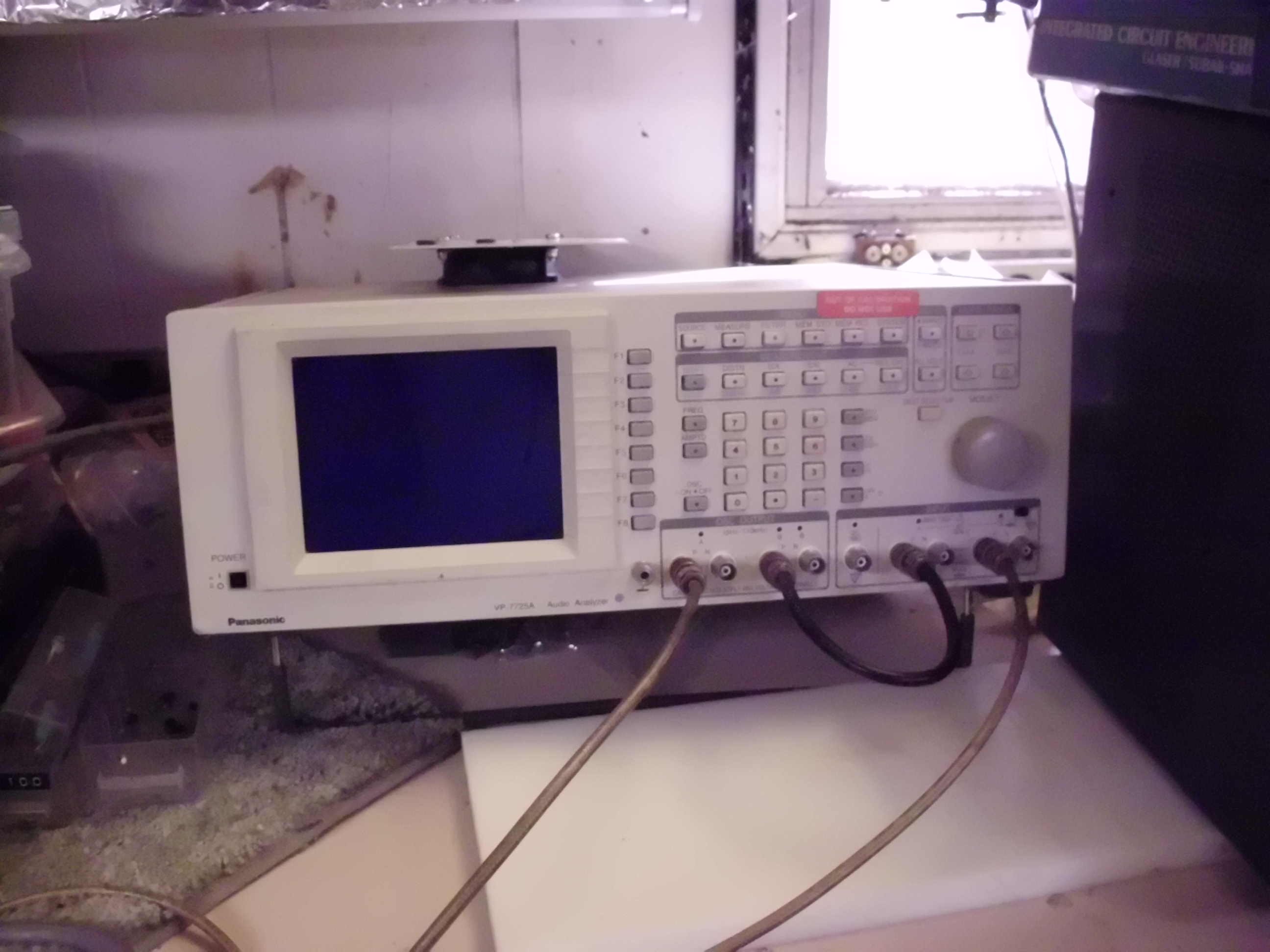

The issue is that I apparently over voltaged the input of one of the two channels. It is spec'd on the front panel at "25v" on one of the two balanced inputs and "160v" on the other. Of course I used the lower voltage one. Of course. That's because I am highly qualified to run exotic unrepairable test gear. Highly qualified.
I'm certainly open to the 7722 or whatever model schematic too. Send it this way.

If you want to ship it my way I'll be happy to explore it and maybe fix it. No promises or time frame commitments but it would be interesting to check out.
Tektronix will also repair it and calibrate it in a timely manner. Call them (West Coast Time). They are not expensive, I found out.
I think the 7725 is the better unit, BTW. But, its your call.
I have test equipment coming out my ears... but the 7725A is one worth my buying.
