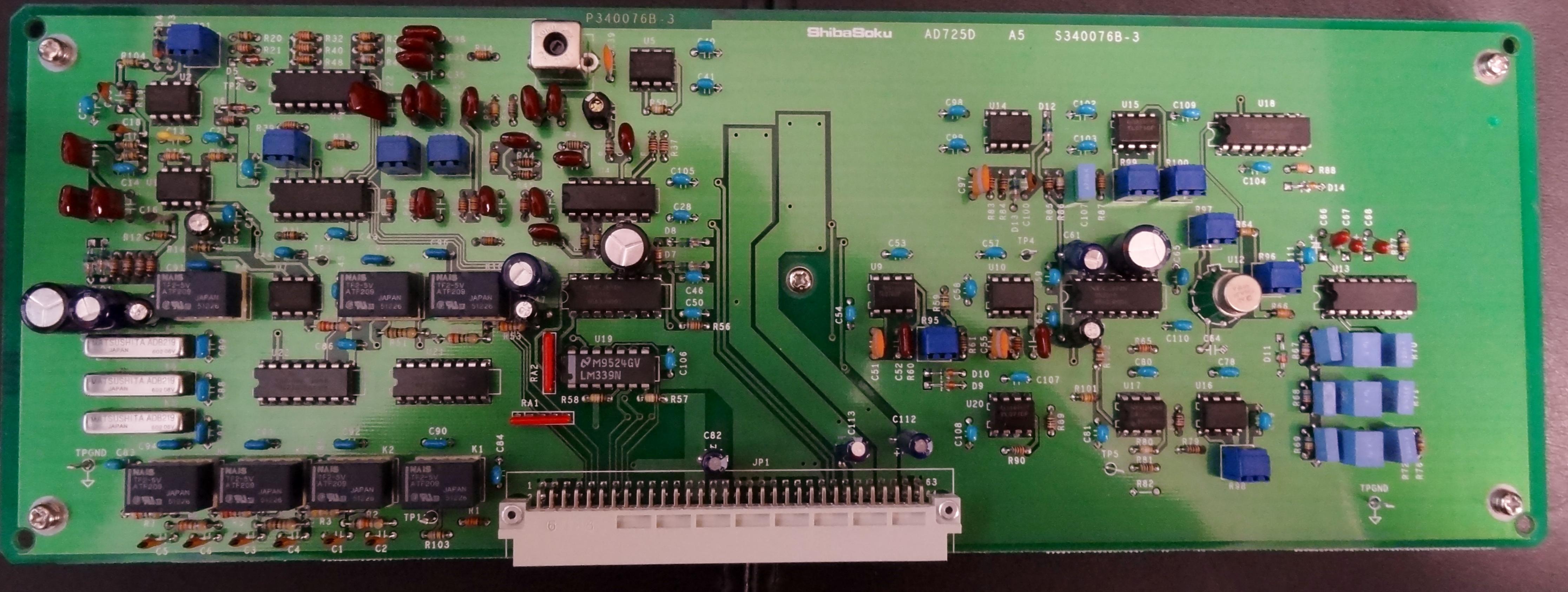

I am looking at the drawings..... they seem to have changed the board numbers on mine... for example board A5 is S340076B-3. A3 is a Twin-T circuit... so it says on the pcb.

Richard:
I think they did a major rework between this unit and my unit and your much newer unit. The fundamental design is probably the same but many of the circuits may have been changed to deal with parts availability and different features. Yours has two inputs and balanced interface and GPIB. Mine has a single unbalanced input and parallel remote control. Very different at that level. Similar ultimate performance but different surroundings.

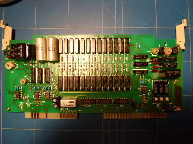

Unfortunately I haven't reverse engineered the analyzer monitor output schematic.
Like 1audio's unit mine only has a single ended input and guessing from the IC date codes was manufactured around 1990. I have attached a photograph of board A5 which is one of the bridged T stages.

Thanks for the picture. As you say the 725D has been completely revamped. My guess is that your A5 Board has the distortion residual HPF and LPF filters and RMS to DC Converter which on the 725C is Board A6 which again looks different apart from the collection of capacitors in the bottom right of the board and the metal can TO-100 package. Even the mother board is different with the 725C using PCB edge connectors and the 725D a dedicated connector.
I did an internet search for a 725C manual but was unsuccessful. ShibaSoku have kept a very low profile in the UK. I had never heard of them before visiting this forum.
