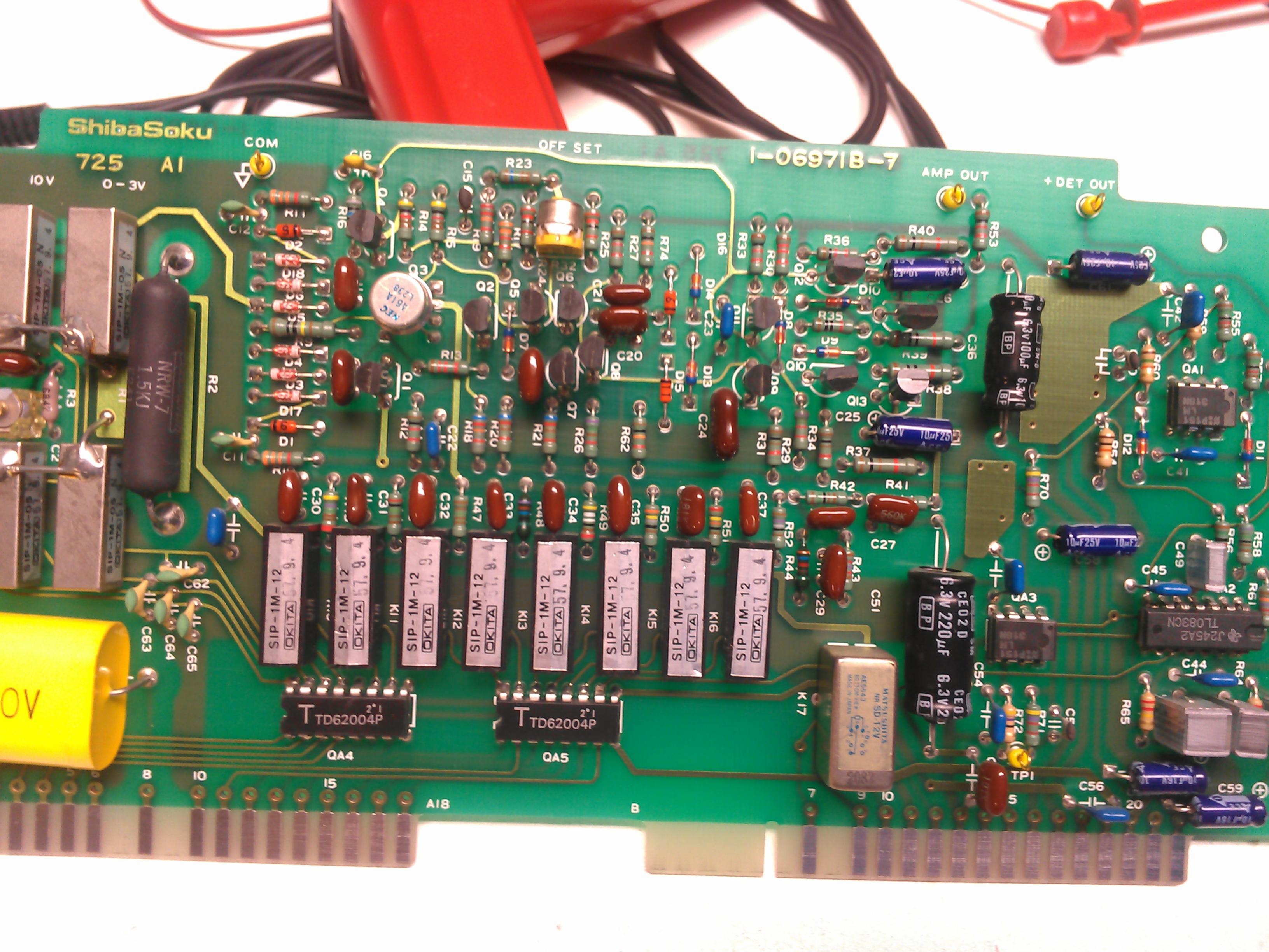

More answers for those that are interested-
The sample clock runs at 64X the input frequency at 1 KHz and below. Above it runs at 12.8 X and then at 25 KHz the clock is 32.652 KHz. At 100 KHz the clock is 130.6 KHz.
The ADC's available when this was made were not particularly exceptional but this seems like the hard way to do it. My FFT (Rockland/Wavetek) which is contemporary to this instrument uses a single chip 8 bit ADC good for 200 KHz sampling.
There seems to be no nulling circuit. It seems to tune each of the three notch filters based on the frequency counter. The notch seems to have a flat rejection band about .5% wide or less. This means that the tuning circuit can't introduce harmonic distortion. Its nice to be able to use unlimited numbers of relays. I think after the first stage the opamps are not significant distortion contributors. There is an NE5534 on the first filter PCB. LM318's afterwards. It uses several TL073's. At first I thought that was a typo but they are real, just vanished from TI's datasheets a long time ago. It is a dual opamp with offset trims for both halves.
Even with these ancient opamps I'm getting the equivalent of -115dB THD+N in a 30 KHz band with the matching generator.
The manual will be interesting. I think the direct tuned notch filters times 3 is the real magic here. The rest is good execution. The input amplifier is good but no real breakthrough. The input NJFET pair buffers into the bipolar differential with current mirror loading. They have made an effort to keep the voltage across the JFET pair constant as the signal swings. This will reduce input capacitance and probably make the input more linear. Then the rest is just good practice. I know I have seen this before somewhere.
The amplifier circuits in the AR590 seem to be the same, with the same complement of devices, except the JFETs are singles instead of a dual.

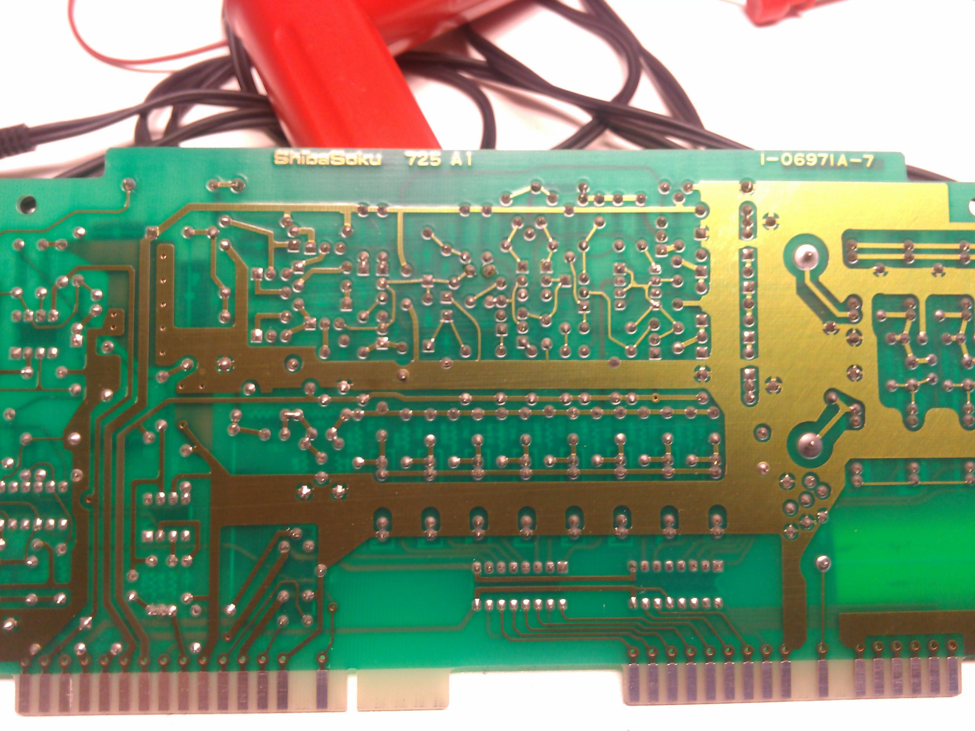

Below are pictures of the front and back of the input PCB.

All good stuff. Very helpful.. collaborates other tests here. The view I have of the notch -- it is probably in the neighborhood of 0.1% to get the accuracy it seems to have on 2H and 3h that i have focused on.
Those devices (especially the TL0xxx type opamps) are the ones i want to change but not for distortion reasons but to lower the noise so that at the monitor output of the residuals, we can get harmonic readings to an even lower level without noise obscuring the harmonic levels.

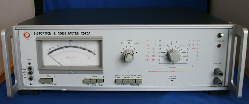

Anyway....two days ago I got hold of an AWA F242A auto nulling D&N test set....it came out of the local airforce and looks quite unused.
It seems to be very microphonic on -80dBm range level meter function...I will open it tonight and have a look.
Part of my reason for grabbing it is to use it as a pre usb soundcard notch filter for spectral measurements.
Anybody have experience/advice/improvements regarding this meter ?.
AWA F242A User/Service Manual.pdf
Thanks in advance, Dan.

The unit you bought looks to be a good candidate for a notch filter. If its cheap enough and saves time by not building something, thats great for me, too. I dont have any experience with that one. Let us know how well it worked for you.

I was referring to the service manual that 1Audio grabbed.
I am building a test/compare interface box, then I can try it out properly.

Thanks for finding the information on the uPA61A. I searched the internet with no luck. I also had trouble finding the TL083 which I had never come across before.
It completes my schematic. Thanks also for the pictures of the board which at first glance look identical to mine.
