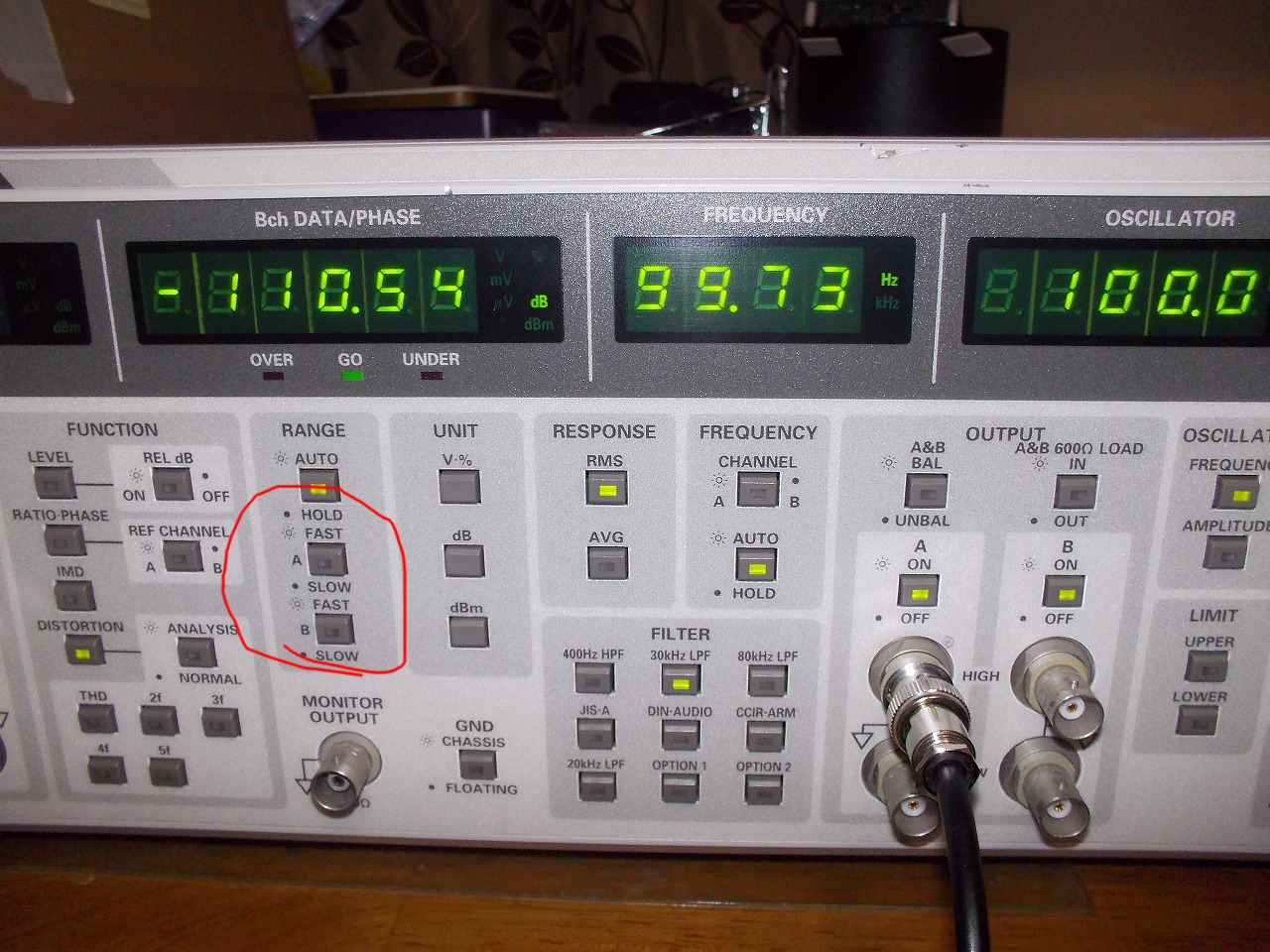

At low frequency, I must push range A/B button to change detector speed slow.
I was taken a lot of time to trace circuit and found it today!!!Aaghhhhh
I once tried to fix it slow mode soldering jumper on boards and succeeded yesterday.

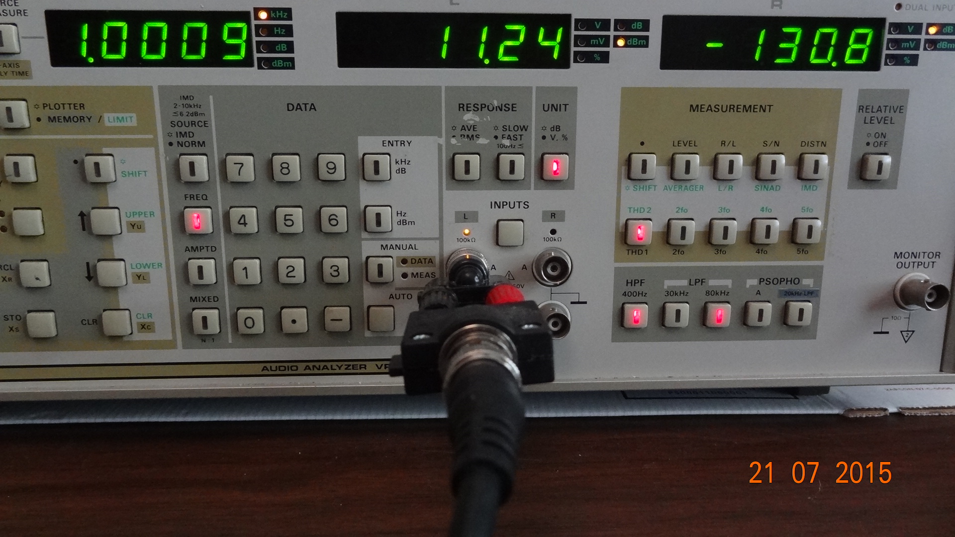

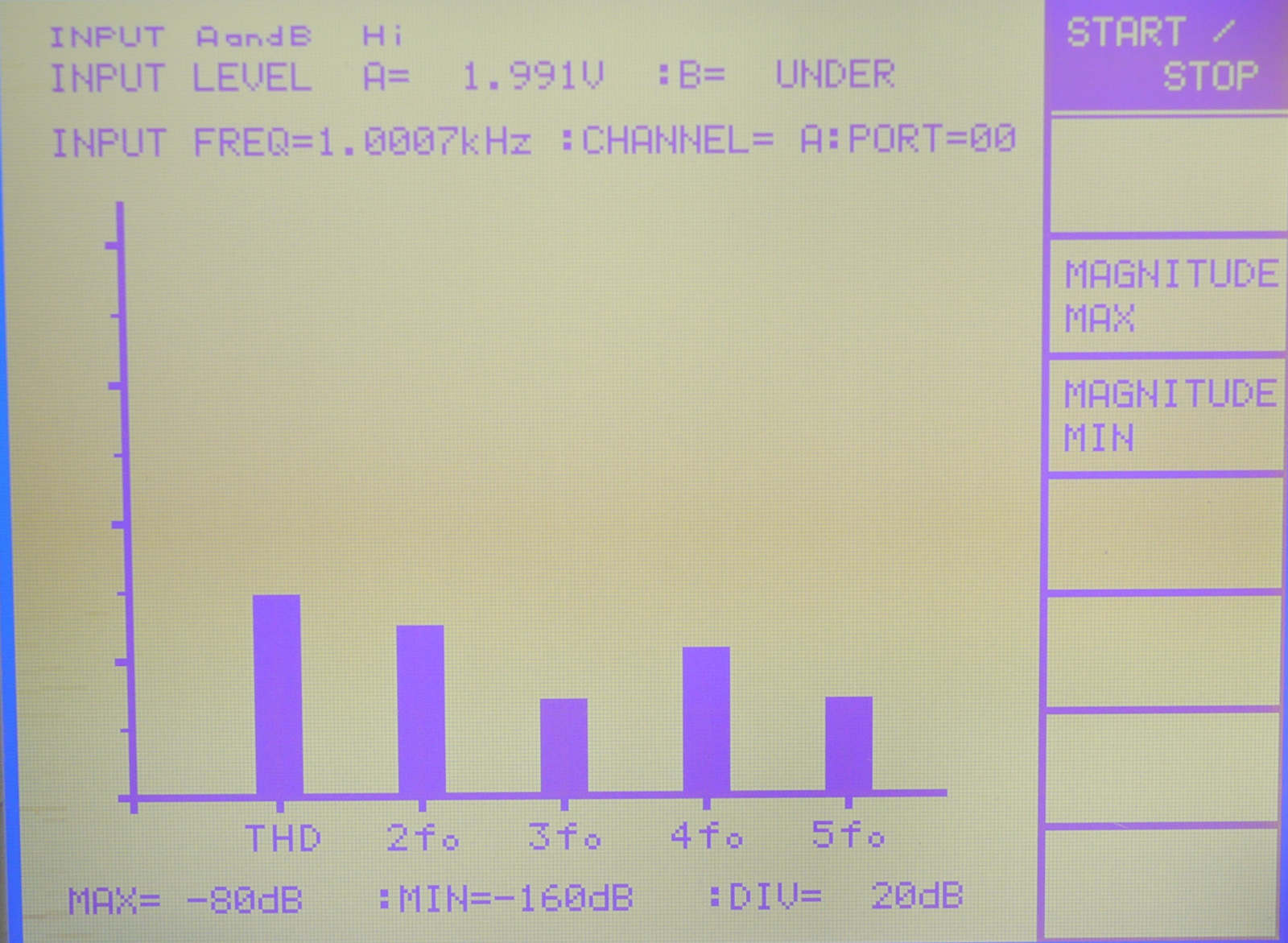

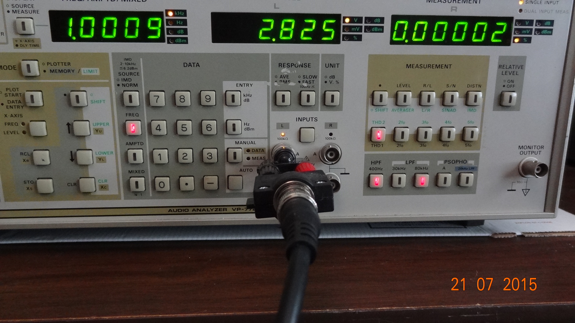

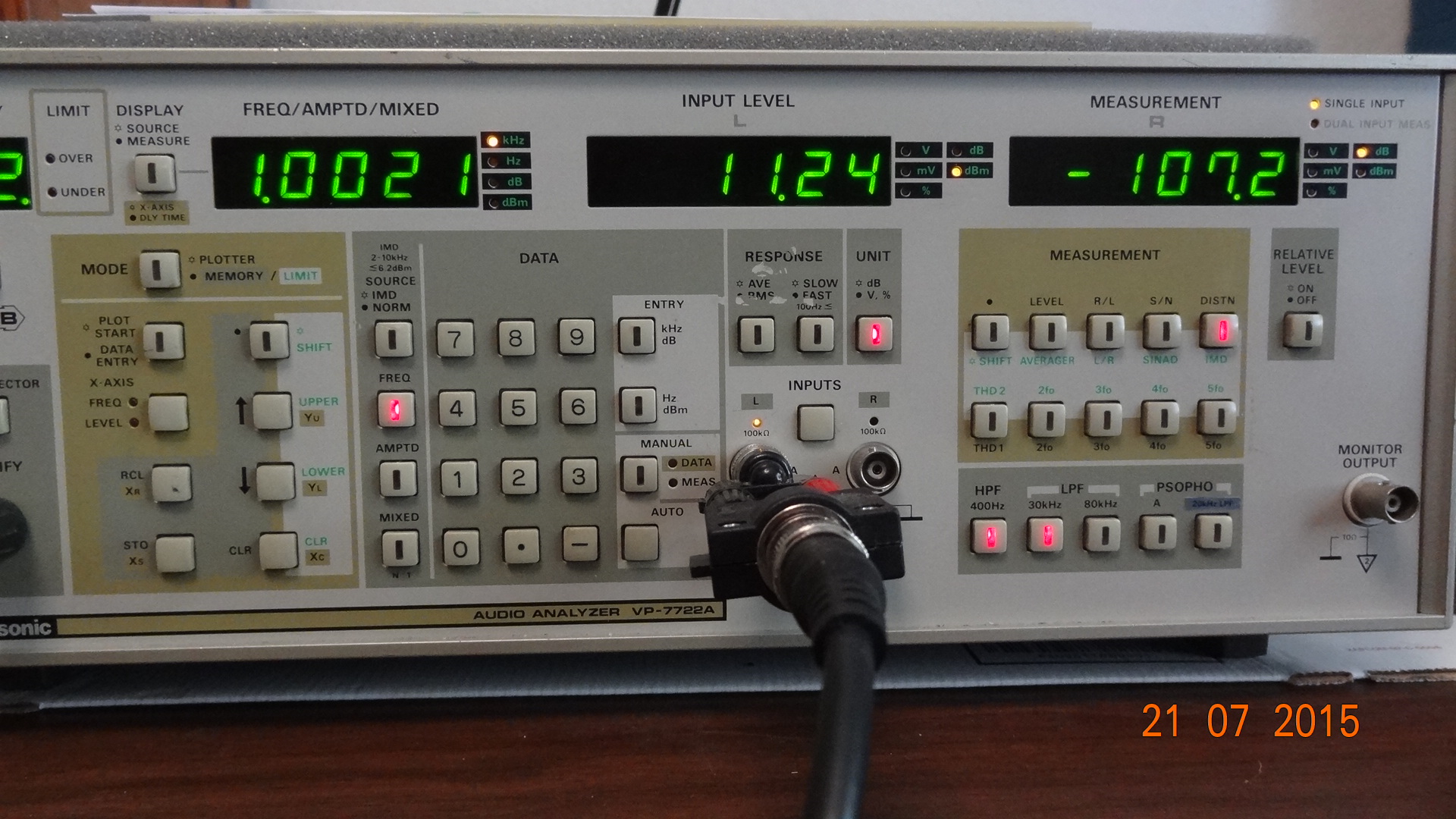

Maybe we can include several other brands here when they use the same over-all design concepts/topology as the ShibaSoku .... namely the Panasonic industrial models, such as the VP-7722A
Inside it is much the same build and look as these shown here so far. Costs are reasonable, especially considering they include an ultra-low distortion generator. Greater availablity, and schematics are available and easier to get than ShibaSoku.
Modifications and improvements should work for them as well.

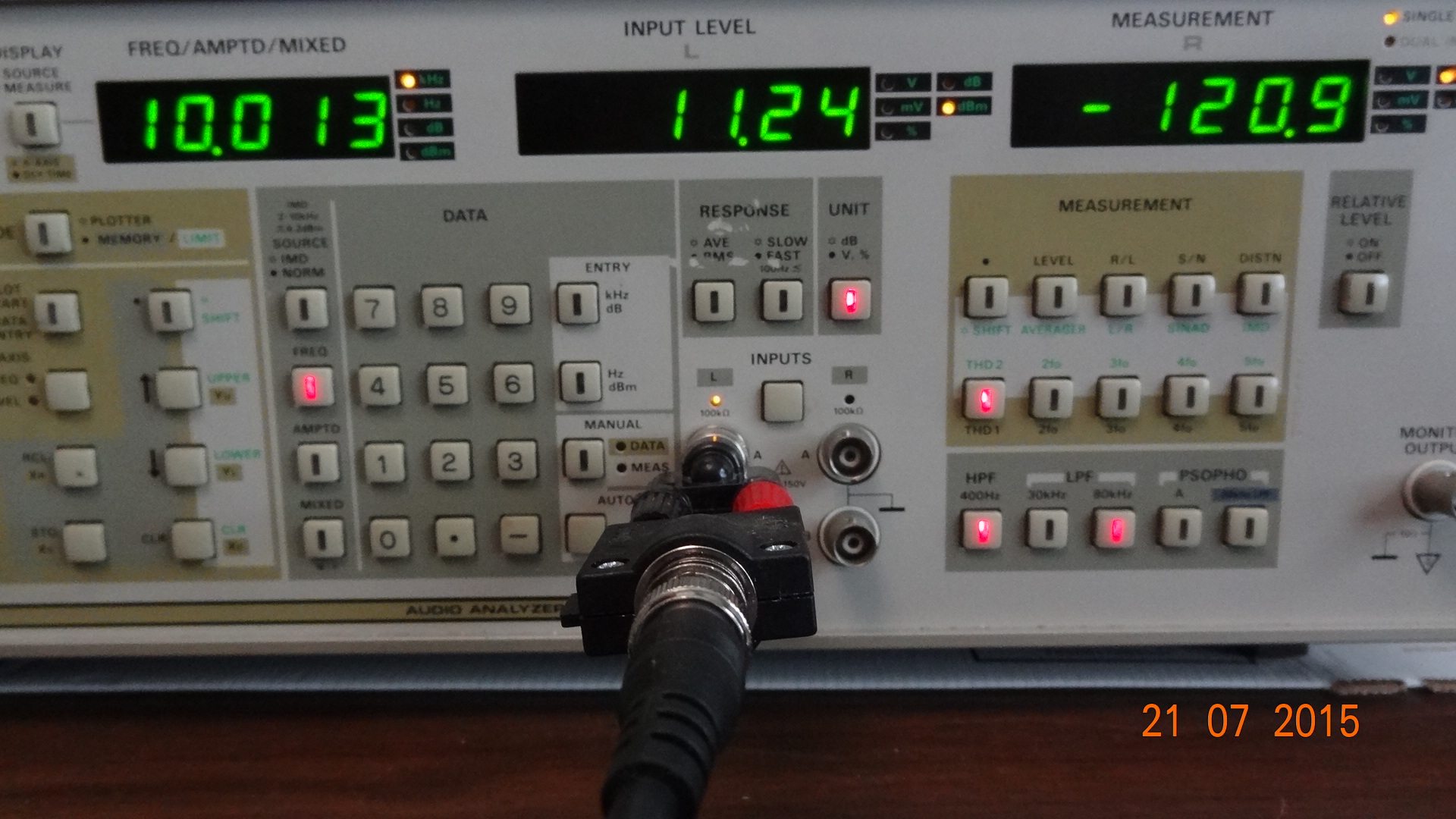

Here is the front panel display shown measuring its own generator.
View attachment 494919 1KHz THD
View attachment 494920 1KHz THD
View attachment 494921 10KHz THD
View attachment 494923 1KHz THD+N
Whah choo tink? same same. Got potential as alternative ShibaSoku.

I noticed some pictures you posted, the VP7722 is working on MANUAL mode.
Do you know how to change the range when VP7722 working on manual mode?
Sometimes VP7722 working on MANUAL MODE would be more stable. Press the MANUAL Key near by NO. 3 key twice, then "meas" LED will turn on. I try most the key but no response.

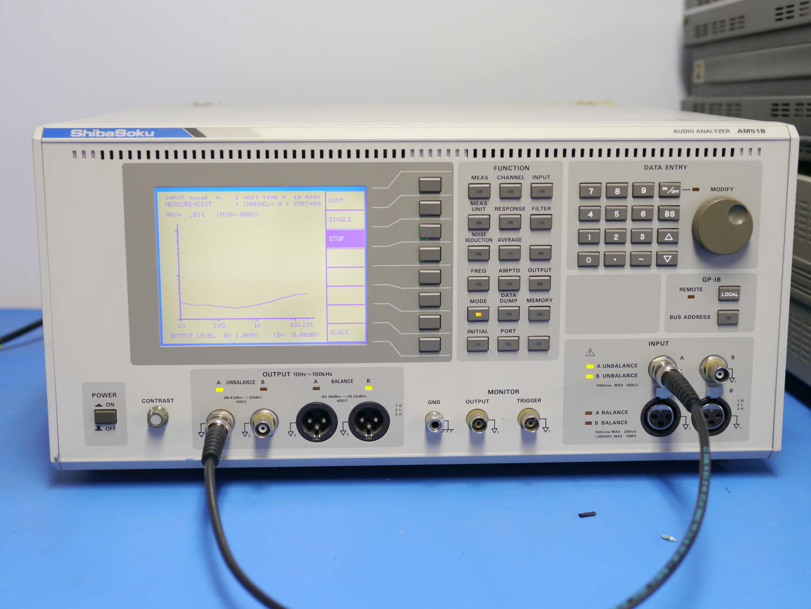

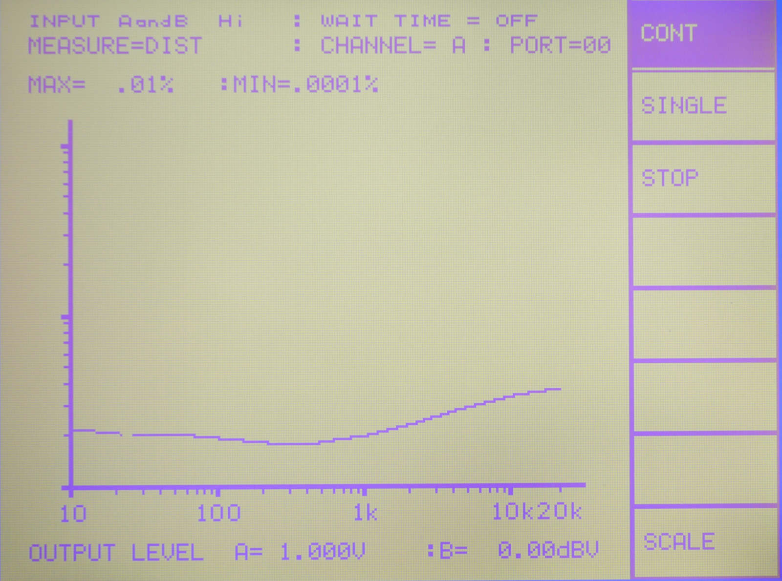

Just a small teaser on the ShibaSoku AM51B, I'll do a full teardown when I get the chance.
Interestingly, my old 725B beats it in terms of THD+N by a bit, the residual of the AM51 is ~0.00020% (-114dB) THD+N @ 2Vrms, 1kHz/30kHz BW. Oh well, it specs -105dB, it just shows you how great the 725's really are.
On first impressions, it is a nice unit, maybe too nice to mod....nahhhhh.
ASACA corporation does the servicing of the ShibaSoku audio gear now (they got eaten up I think?), I managed to get the AM51B user manual from them, very friendly bunch.
Unfortunately, they said the 725B is too old and they don't have the service manual any more.
