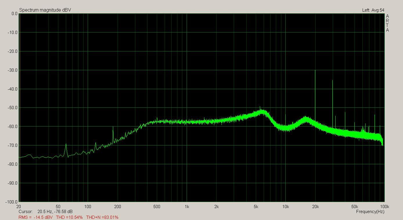

Here's what you can do with a bit of frequency tweaking.
You can get your units in a lot better.
-100dB - 0dBV FS
The Twin T board keeps the notch of the first BEf between -30dB and -40dB depending on the frequency. Shibasoku is putting 5Vrmd into this filter. At that level -30dB is enough to raise the distortion of the buffer op amp at the output of the TT. So the distortion rises a bit at the peaks.
There may be some loss at the second harmonic with the BEF so perhaps that is compensation? (Seems like a long shot.)
There was absolutely no shift in the harmonics when doing this adjustment.
The harmonic stay exactly the same. A test at various frequencies confirmed this.
No change.

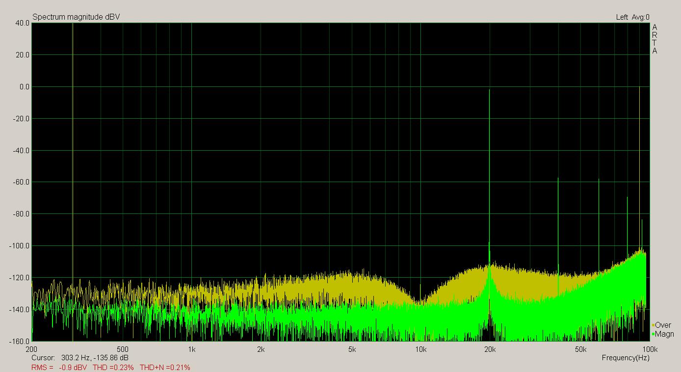

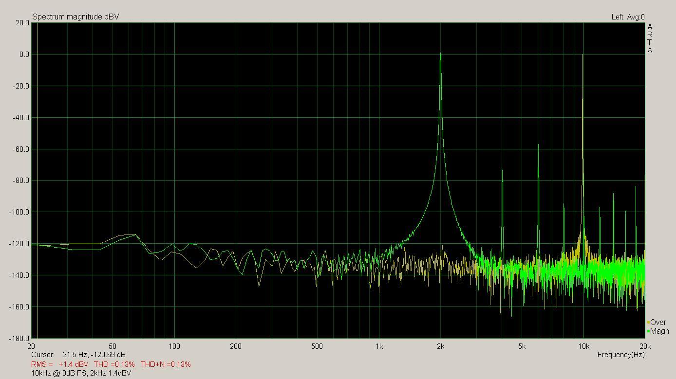

here is a test of the notch BEF filters. The probe i s on an output test point for the third BEF.
The total gain at this point is 26dB. 6dB at the input amplifier and 20 at the input to the second BEF. The test signal is 1kHz and the 725D has tuned to this frequency. The sampling is switched to Hold mode to prevent the notch frequency from changing.
A 10kHz signal is input and I added an attenuator at the Emu0204 input and normalized the 26dB gain to 0dBV FS. The signal is then tuned to 2kHz. As you can see the gain is 1.4dB @ 2kHz.
I've included the 10kHz as an overlay and displayed the 2kHz.
The second pic is the notch of the three BEF.
I don't see any issues at all. These filters are performing at spec with a darn good notch.
The error is all on the up side. The shoulder peaks at 2.7dB @ about 2.78 kHz, 1.5dB @ 3KHz, 0.8dB @ 4kHz and flattens out to 0dB from 5 kHz up.
