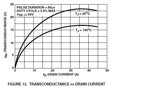

Tyimo said:My question is: what is the output imp of the SEWA power amp.
Believe or not
Output impedance (without the speaker load) is the paralleled
resistance between 1/gm(transconductance of the fet) and the total resistance below the source.

So, am I right: OTA output imp will be with 10R source load and IRFP150 Gfs14 ca. 70milliohm??
How can I calculate with common source amps?

I can see no value
in the datasheet, called 1/gm
and no curve using this term, either
'Forward transconductance' of IRFP150N is 14 S ( 13 S for IRFP150 ) at 25V 22 Ampere
Datasheets dirctly from International Rectifier:
IRFP150 or IRFP150N ... take your pick!
http://www.irf.com/product-info/datasheets/data/irfp150.pdf
http://www.irf.com/product-info/datasheets/data/irfp150n.pdf
As for output impedance of OTA, Mad_K guess was 0.25 Ohm
and should be lower for Seven Watt SEWA
lineup

I meant guess or measure the transconductance Gfs (gm) IRFP250N has 17S @50V/18A. Let's guess it has 3S at 15V/3A. Output Z would be 1/3S // CCS (very large number) // 1K (bleeder) // 8ohm (load) = somewhere around 0,3ohm.
To measure the output impedance:
Apply a 1KHz sinus for 10V output into your scope. Attach a load (10R for example). If you are measuring 9,5V across the load, your output impedance is what makes this voltage drop
Edit: your formula is correct Tyimo
