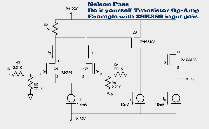

I know
many use trimmer to balance JFET input pairs.
you can see this in absolute top class audio amplifiers, too.
At least when talking BJT, bipolar like BC550C etc,
I know that it is important to share current EXACTLY 50%-50%
from the tail, from the current source.
( see Douglas Self investigations and papers )
I see many other say the same thing - make sure have same current in both input transistors.
I cant see no reason, why is different when using JFET.
I also see that those into high quality JFET input amplifiers
alway use a close matched pair.
And most usually they do this the easy way
- but to a little bit of extra cost:
Buy some 2SK389 = Two close Matched JFET in same package!
If you compare the cost when buying 10 pcs K389 (will give you 10 very good amplifiers!)
with the cost of Chassis, Transformer, Power Supply electrolyts and Heatsink
..... it is really nothing
... semiconductors are always the low cost
in an amplifier .... if you count for a complete amp.

I attach Nelson Pass figure, showing a typical input differetial
for making your own discrete JFET Op-Amp.

You can not adjust unmatched paralelled mosfets with a pot. You should match paralelled devices. In a pinch one could put resistors in paralell with the source resistors, but I wouldn't design for it.
When designing a balanced version I would use a pot instead of the lower resistor in the bias setting divider to get correct dc offset. This way you can get rid of the output coupling caps.
Yeeesss! This is what am I saying! A trimmer in series or instead of R10 (10K).
