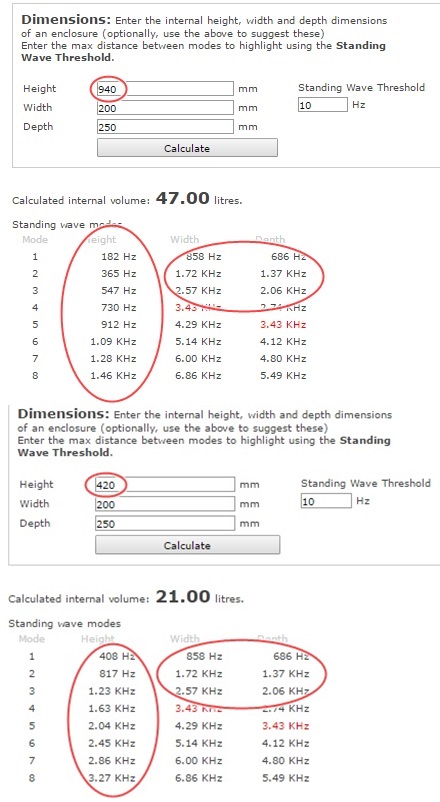

Well, by halving longest dimension, the lowest mode is eliminated. But with an oblique wall, all vertical modes will also be attenuated a lot. Look at attachment, simulation does not allow oblique walls.

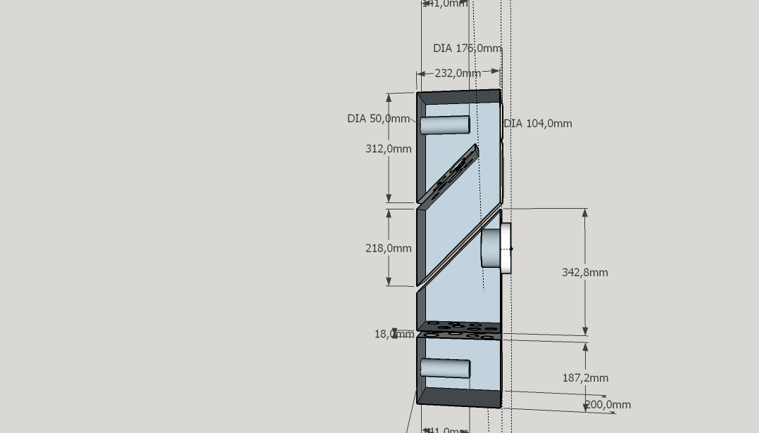

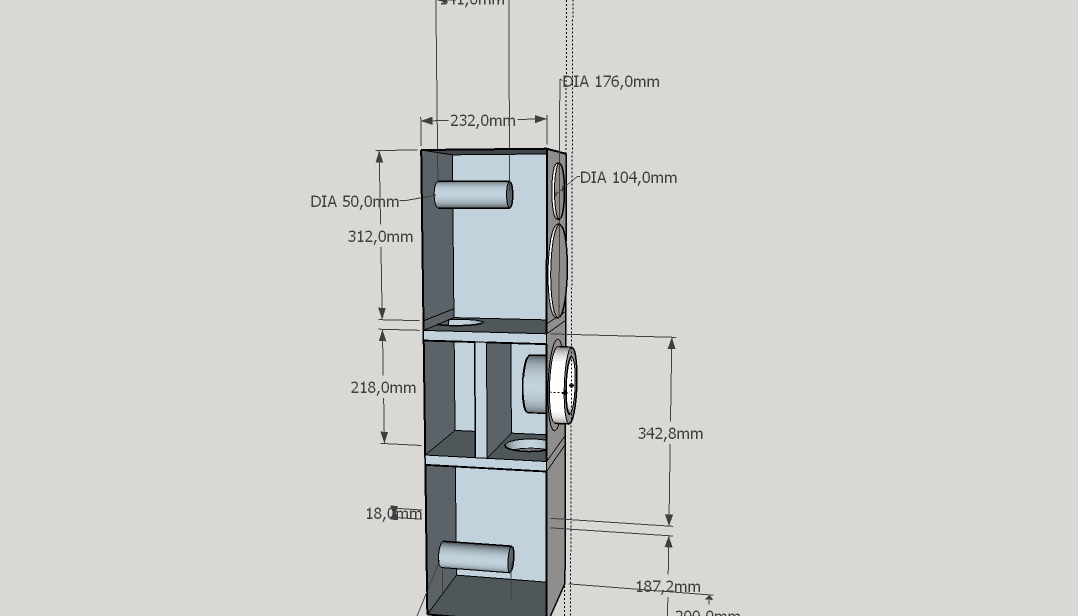

The inner dimensions should be something like this. I added the holed braces (one for each compartment) I was earlier talking about .
The "drivers" (circles protruding from front) are of course just mocking driver placement in the image. In reality there's going to be the baffle between the inner volume and those drivers. The holes in the baffle for woofers will be 146 mm in diameter, naturally not the 176 mm which is the woofers' outer diameter. Same thing with the tweeter.
I also got the reflex ports a bit wrong in the image: port length 141 mm starts from the outer surface of the back panel, not from the inner surface of course. So the ports will protrude 123 mm (141 mm-18 mm) into the enclosure, not 141 mm.
Brace placement I did pretty randomly just to mock them out. The essential thing in the inner dimensions is of course the divider placement to get volumes for both compartments right. The overall inner height used here, 878 mm, is somewhat smaller than the total inner height of the box, 964 mm, so I'll have to add something at the bottom of the box to reduce total volume. I might just be able to fit a separate little chamber at the bottom for XO.
The brace placement I'll have to consider better later, for there might be possible benefits for box mode reducing. Brace and port volumes I subtracted from inner box volume when calculating the dimensions.

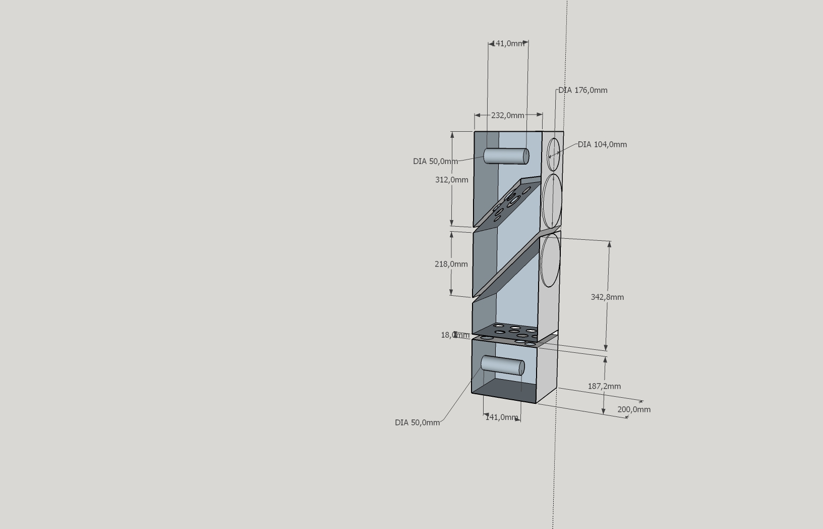

You're welcome. Have a look at Troels Gravesen's Ekta Grande.
Maybe this will help you get an idea of how things could be done
better in regard to placing braces. Your slanted divider looks as
wrong as hell to me. Will you be able to put stuffing to the wall
of the divider close to the driver?

Some speakers with asymmetric inner dimensions and shape
About Coincident Speaker Technology
Speakers
Sonja? Gallery - YG Acoustics
Of course one divider is not enough for cabinet support. And also damping material should be used to attenuate standing waves. There are two problems to cope with - internal standing waves and panel vibrations.

I had time to test the lower woofer dimensions on the sketchup, and it's clear now that the slanted divider won't work as is. There's just too little room behind the lower woofer, the magnet will be practically touching the divider (image 1).
I made a rude sketch (not calculated dimensions, and the sketch is also missing braces) of another idea the enclosure could be divided and have both woofers close to each other (image 2). Because the lower woofer is still at play at ~1000 Hz I would have lobing issues if they're farther apart.
On the other hand, if I placed the lower woofer clearly lower than the upper one, that might help with Allen effect at around 140 Hz where the classical floor reflection dip appears..
I'm also seriously starting to consider just making one compartment at 45 liters or so for both woofers.
At any case, I'll be using at least two braces in addition to the possible divider, and also filling in the cabinet and maybe some damping for cabinet panels.

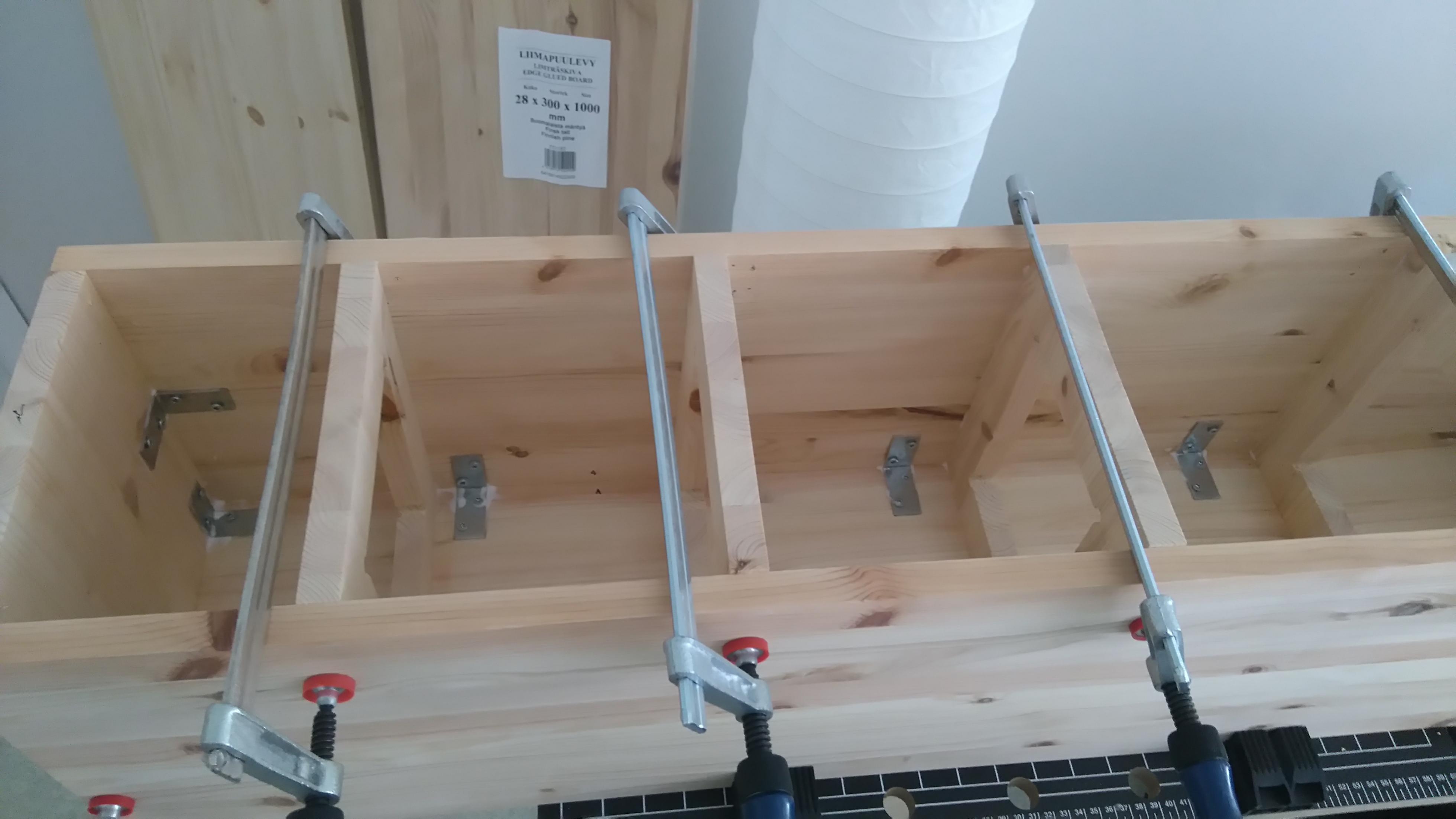

I'll use two or three horizontal braces. Probably three. I'll just have to buy one more panel to cut braces from.

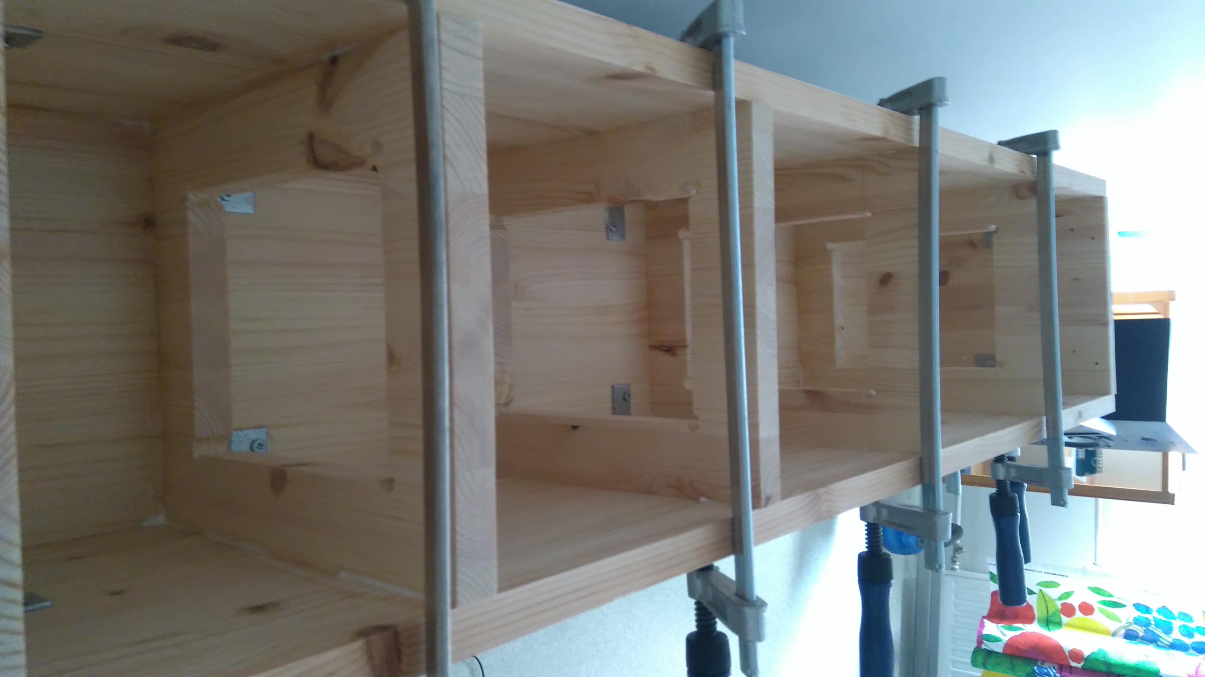

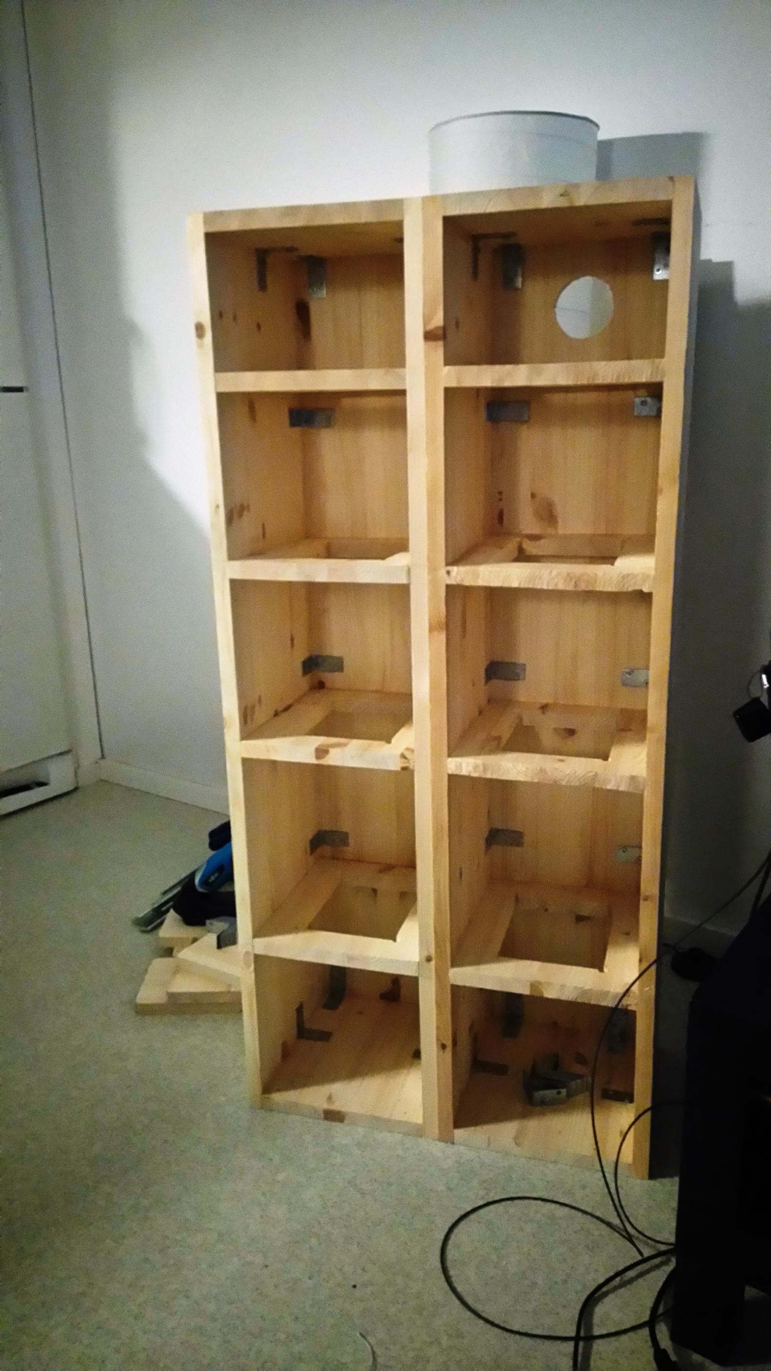

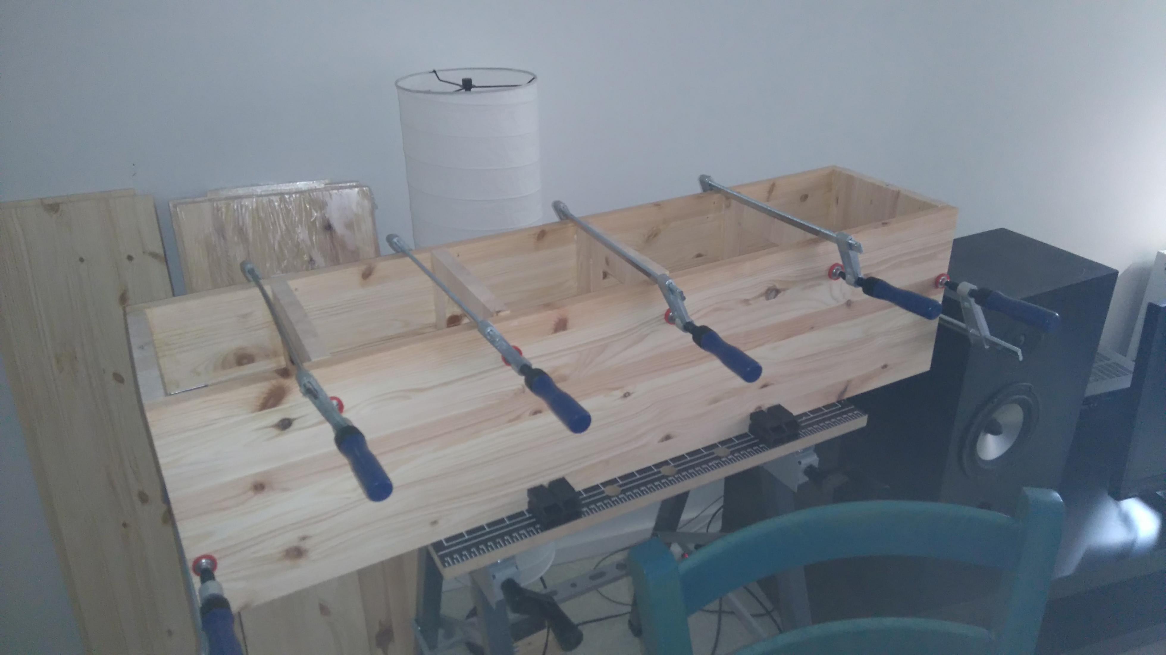

The first cabinet is in the making. I chose to go with four horizontal holed braces. Some of the panels were flawed, so I'll have to wait for the vendor to replace them before I can glue the second cabinet.

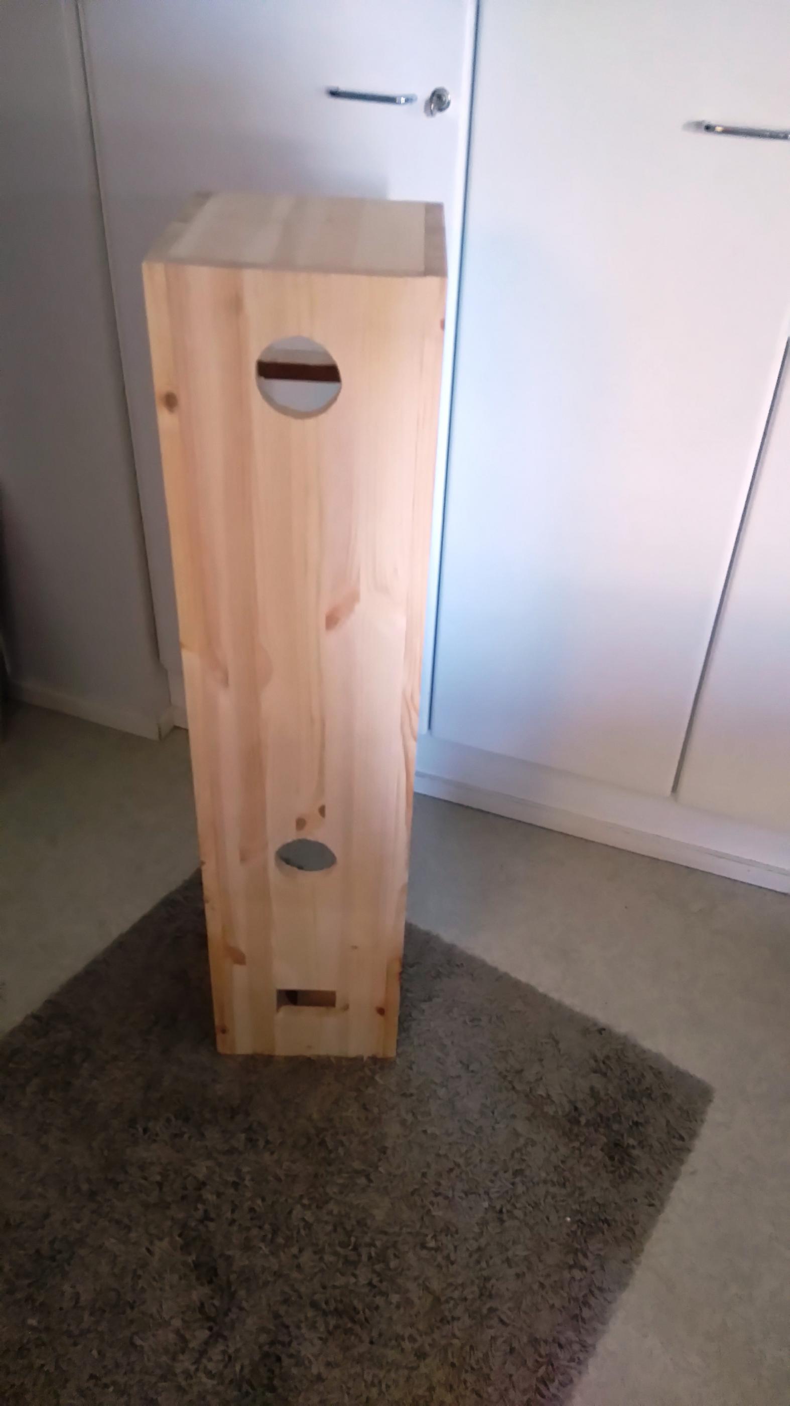

Both cabinets have been made, although without baffles yet. Reflex ports and terminals have been bought. I'll make tomorrow holes for ports and terminals at back panels and hopefully manage to complete most of the baffle holes and flush mounting insets for drivers. I'll also have to visit a hardware store to get some bitumen roofing felt for damping.

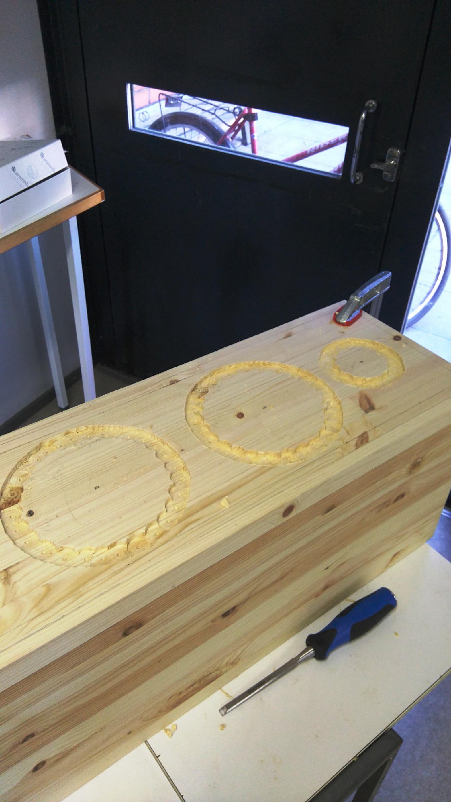

I've rough cut all openings to the cabinets. The insets for flush mounting were a pain in the proverbial to make with a forstner bit and a chisel! I've still got a lot of finishing work and fixing with putty to do.
I also faceted the upper edge of the baffles, for I gathered they cannot be easily filleted with hand tools. Sides are yet to be filleted.

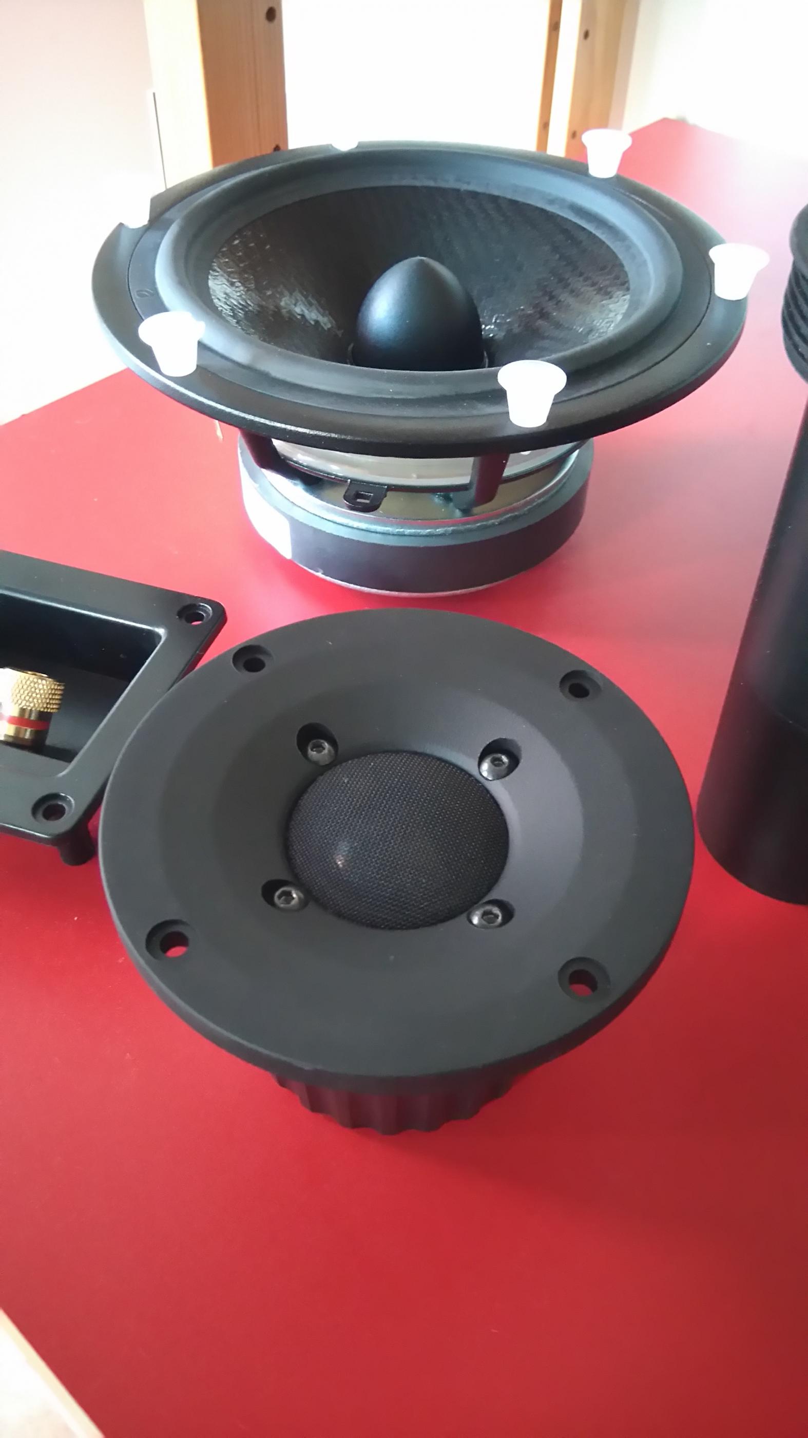

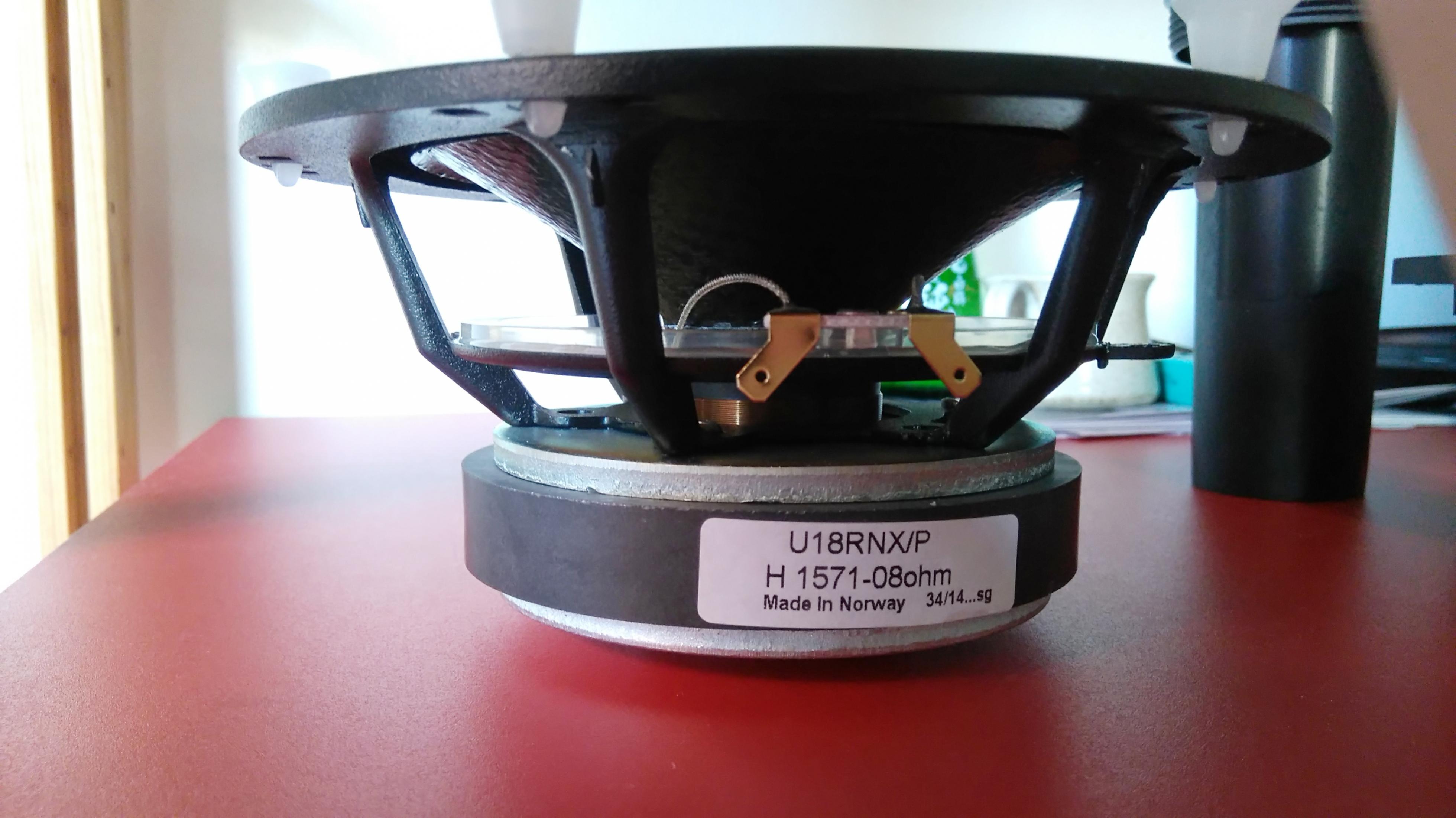

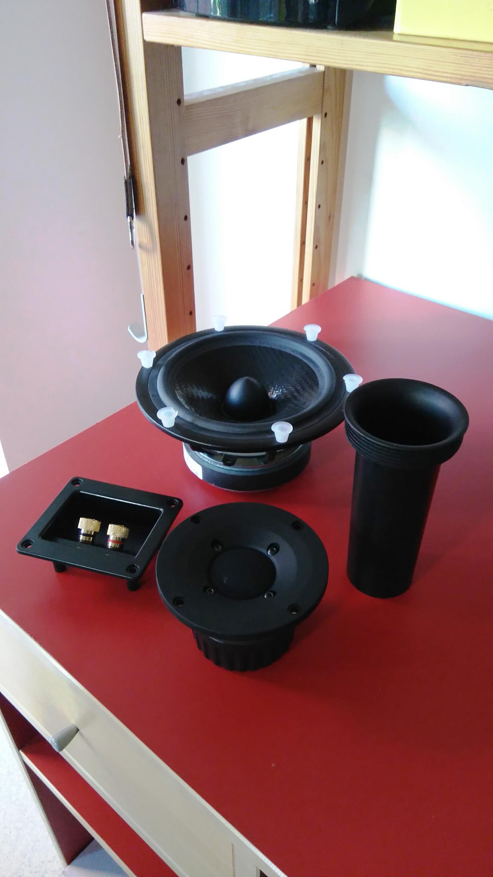

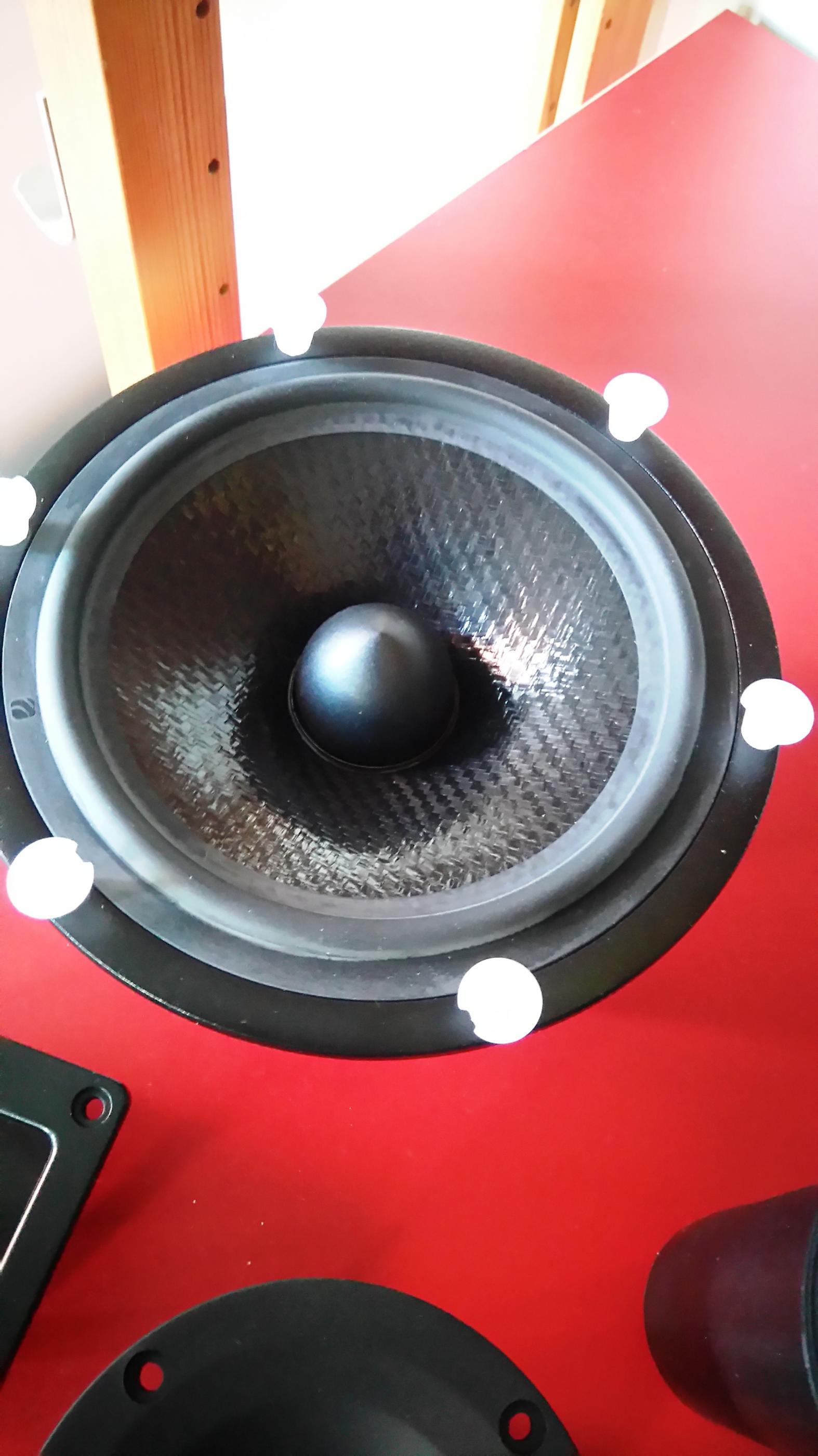

The drivers are here, save the fourth woofer, no word on that yet. I'm pretty impressed by the look and feel of them! I'll post impedance curves for the drivers soonish. It's interesting to see how close the woofers' Fs's are to each other and to the specs. The images also feature the reflex ports and speaker terminals I decided to buy.

Cabinets are looking good and that woofer is darn sexy.

That woofer IS sexy, and IMHO that tweeter too.

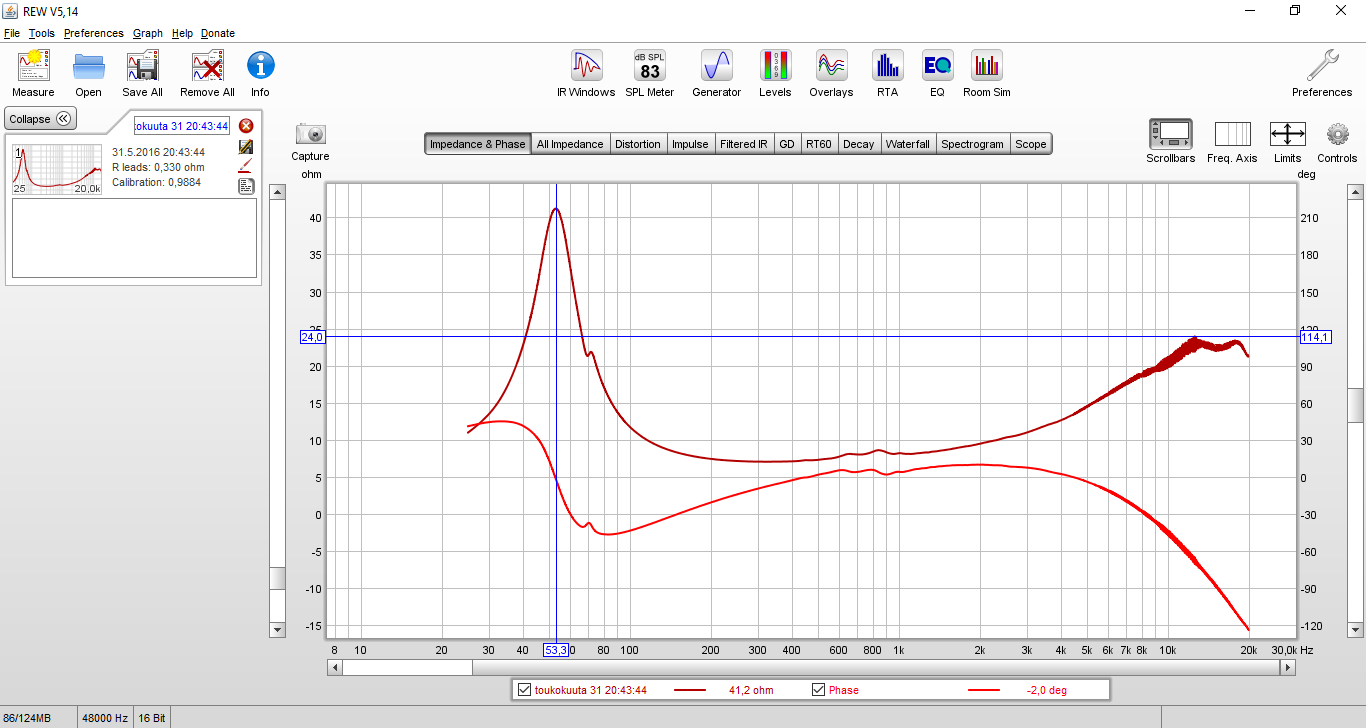

i wonder if its a scandinavian thing? t/s parameters are sopposed to be small signal parameters, but scanspeak seems to spec the Fs at more than a couple of volts, but the published impedance curves seem to small signal. pick any ss woofer and you will see the discrepancy in the published impedance peak vs. fs.

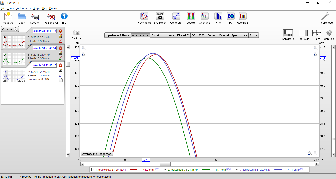

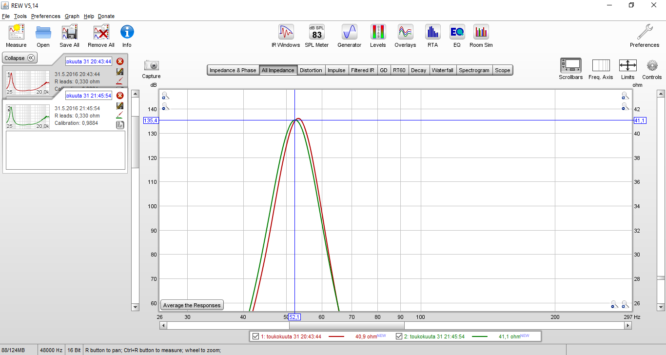

I hope the engineers from a neighboring country will prove trustworthy and the Fs won't be too much off! I'd say "neighboring Scandinavian country", but geographically Finland isn't a part of the Scandinavian peninsula, although usually affiliated (and I affiliate myself) to the Scandinavian countries. That of course means that I'll blame "the bloody Scandinavians" if the drivers will be off.
A little audio signal seems to be doing something, the Fs is creeping a bit down. I'll see and post if I can provoke any further change in the Fs in a few days term. Otherwise I'll have to see if I'll have to make any changes to the cabinet volume while I still can.
Is this free-air measurement or installed in cabin? Usually free-air is higher freq. Bass tuning is not so picky as you think, so I have read!

Both of the measurements are free air, woofer standing on a table on its magnet, wires attached.
The tuning is already under the Fs (38 Hz tuning for 43 Hz specified Fs), but if the Fs stays above 50 Hz or so, I'll have to rethink the cabinet volume. Some of the other T/S parameters are such a pain to measure that I don't know if I'll calculate/measure any new T/S parameters for the woofers. For what I've reckoned playing around WinISD, UniBox and BoxSim and my current speakers in real life, a few liters and Hz won't make or break anything, just change the overall balance somewhat.
i dont think they are lying so much as used to different measurement conventions. if they wanted to lie they would alter the z data to match.
i typically go by the madiaound recommendations as a starting point. you can also examine the Klang Tong Nada kit. i think thatin use, the specs will prove closer that we would guess.
