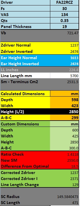

Now that is one solid cabinet. Is a bib not suitable for this driver?
I understand a BIB for it is BIG.
dave
Not if you live in a church...
Sorry I though ten was too big. I didn't realize even 8 inches where too big. These are 4 and 6 inch drivers design I guess now. Hey guys I am starting a tqwt restoration for my mum. One of my best built failures but I think I know why they did now. They might be what you might call a cyburg needle. There very close to that design with a fe103 acr. I am going to start a thread and post some pictures . Hope you guys can see the mods I need to make to make them work.

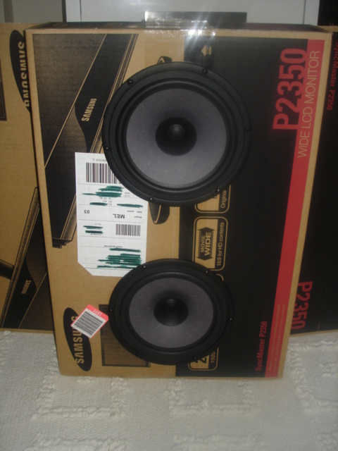

Hi all, my first post over here and spotted reference to the Breezer design. Has anyone has built it at all? I'm interested in the K&T enclosure and filter design if anyone has it? I've asked K&T but they only supply it with the drivers, which I've already got.
My FA22RCZ drivers are built into the 60L Seas sealed enclosure. At present it's using the 0.82mH/6.8 Ohm filter, but I wouldn't mind more bass and less beaming? I might also try the Troels Gravesen light bulb idea in front of the whizzer?
My only past speaker building experience was a pair of little Zaph Audio 3" Tang Band FR near field monitors. They sounded great and I now regret selling them on. Off axis they could throw an excellent image.
