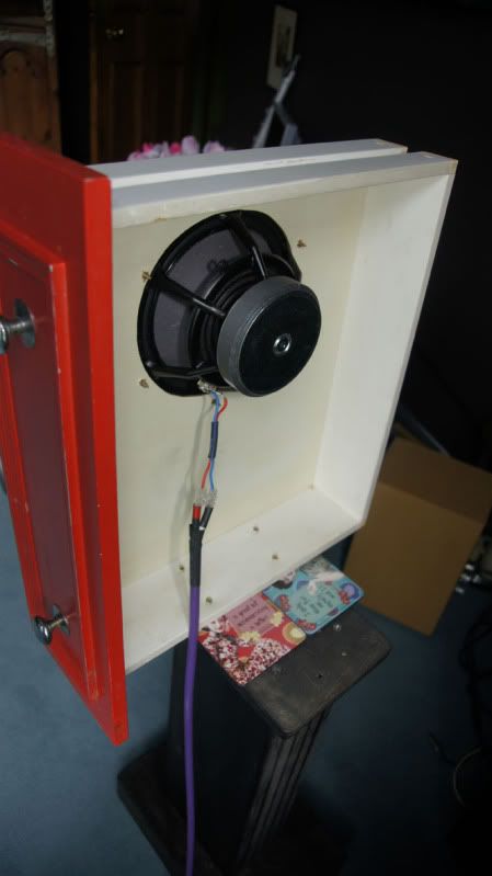

Hello, I think what you suggest sounds the best way. What about xover ? I have placed mine temporarily in some kitchen draws, not made me overly popular at home :eek:
I am running them with a big sub in the corner of the room for the moment to help with the bass. I would be interest to hear of any one else's experiments with OB single drive units without crossovers !

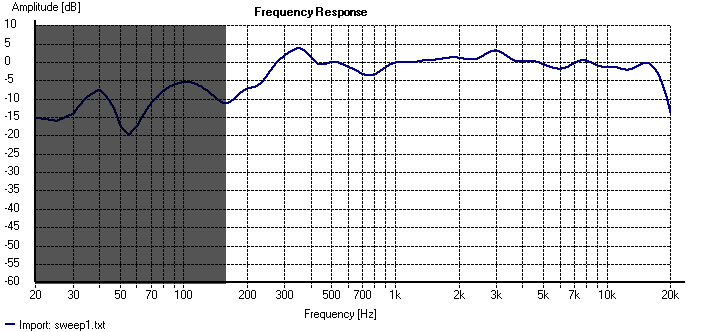

Here is the FR of the Seas FR in the "Drawer Baffle". The shaded area down low is where the sub was coming in to help, before it was adjusted.
Not bad at all for a single driver stuck in a drawer.
That looks really pragmatic... great idea!

I'm surprised that no one has commented on the FR plot I posted of the driver in the drawer. It's really much better than the factory plot. Why is it so much better? I know, but want to see if any one else can figure it out. (Hint: There is no EQ or crossover)
Administrator
Joined 2004
OK, I'll "Spill the Beans"
The reason the measurements that Marcus took in his lounge look so much better than the factory graphs is - Application.
The factory FR shows a big high end rise that is typical of many FR drivers. But the measurements we showed were done at the listening position, and Open Baffle. Seas probably did their measurements on a big standard baffle, too - but they show only the front radiation at 1 meter from the driver.
Once you get back into the room a bit and start getting sound off the front and the back of the driver, things start to balance out. There isn't as much HF getting to you off the back, so the balance starts to tip away from the rising HF. Or in other words, the sound off the back of the driver fills in the mids to come up to the level of the highs. In this case, almost perfectly filling in.
As you might guess, this would not work in a box speaker because the rear radiation is (almost) completely contained in the box. You don't get the blend off the back of the driver.
My friend John Busch has also been working with this driver and has found the same thing. It does not need a series inductor to tame the top end when used open baffle. John found this out by listening to it, then the measurements in London confirmed it. It's a great driver.
