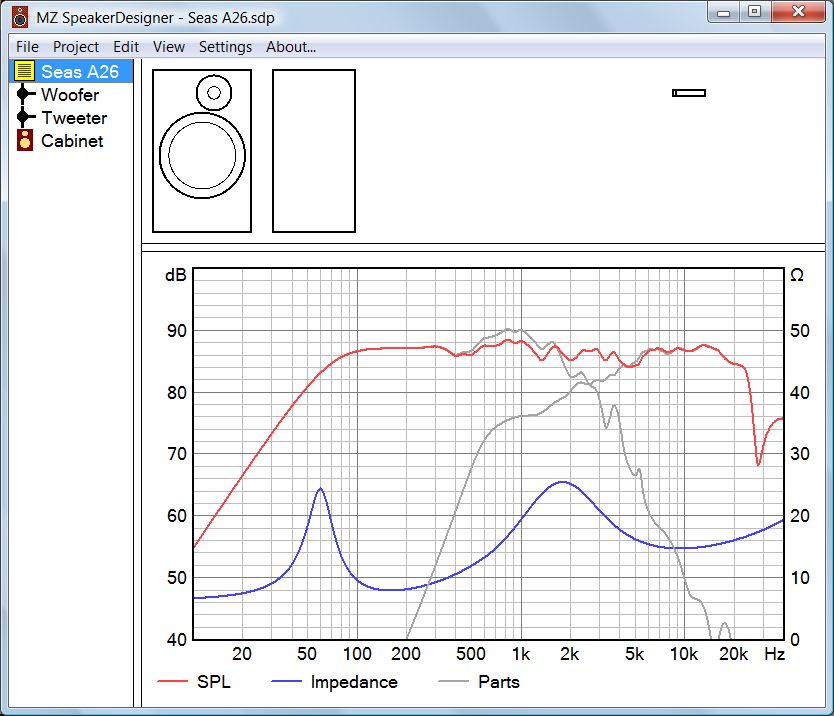

so I was very fortunate to get a nice e-mail from SEAS today :), they sent me the original datas for the A26 woofer and the T35 :cheerful: :
Hello,
We only have the measurements for the A26-kit: SEAS A26 Kit
You can also take a look at the attachments here.
I hope this will help you!
Med vennlig hilsen / Kind regards
SEAS Fabrikker AS
H026174_small
SEAS: The Art Of Sound Perfection
Enclosed were the .txt files that I provide here in a ZIP file. These were exactly frd and zma files, I just duplicated them to get the usable files.
There is indeed a substantial discrepancy with the datas that circulated on this forum so far, so please take care of using only these original datas in the future.

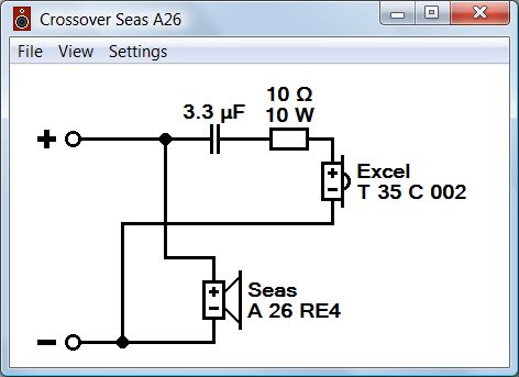

I played a little bit in XSim and it appears that a 1mH inductor in // on the tweeter makes a big improvement.
Without the inductor :
and with the inductor :
Strange that SEAS didn't think of adding it in the original filter!

The woofer of the A26 speaker actually is a bit too loud in the range from 600 to 1100 Hz. The tweeter is of opposite phase there and brings the level down by 2 dB. That's how the original works.
With an additional inductor in the tweeter filter this doesn't happen anymore and the hump at 900 Hz might become a problem. :2c:

Just for fun, here's the FR plot. The complete XSim file is zipped and attached.
