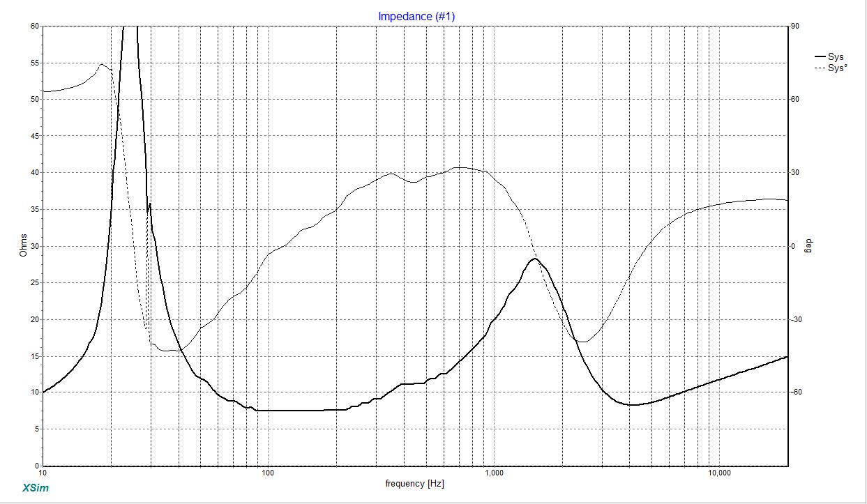

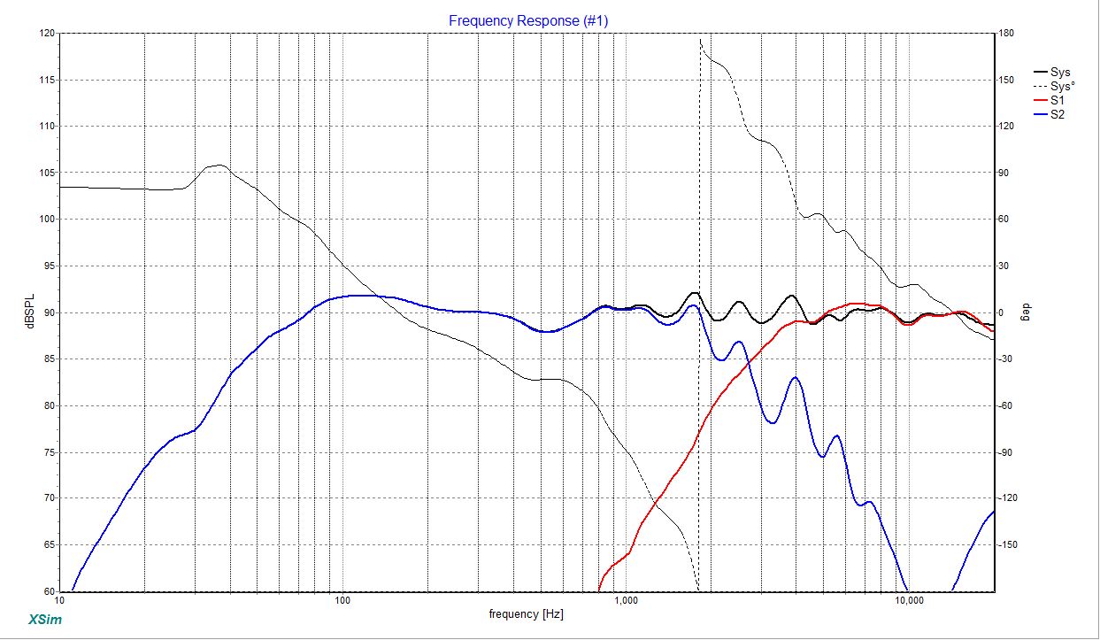

As agreed with Erik, I have completed the data files of post #2 with phase angle that's contained in the zipped file. This is the sim of the original Seas A26 kit units. To fit one's own taste, tweeter padding can be easily modified.

Hi Everyone,
Just wanted to share an XSim model of the A26. It's reasonably accurate, but the raw driver data comes from images, so the impedance is pretty ragged.
Anyway, I though it might be a good reference in case anyone was curious, or a newbie wanted to play around with XSim or what not.
Hi Erik,
can you please tell me from which document you extracted the data?
Actually I just notices the woofer's frd seems quite different from the one which is on seas spec sheet...

Hi apparently the frd file correspond to the measurement found on this page :
Seas A26 - April 2013 - Loudspeakermagazine 2013 | Loudspeakerbuilding
where the reviewer made the measures at 1.5 meter (not in standard conditions). He inculdes the phase too, whereas SEAS' spec sheet doesn't. The tweeter padding can have an influence on phase so it would be more accurate to decrease the A26RE4 sensitivity of about 2 dB in XSim file to account for the real sensitivity measured in std conditions by SEAS.
