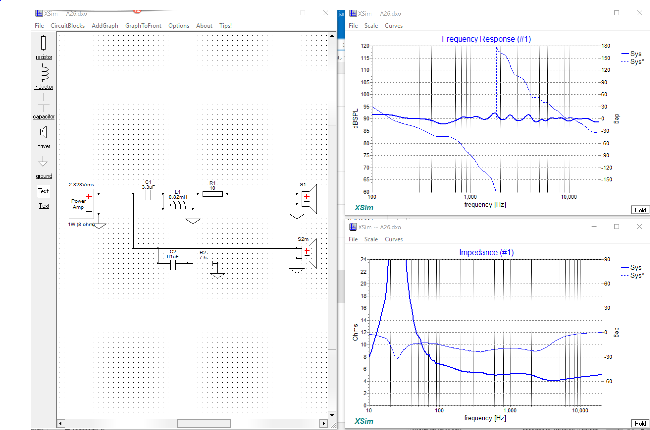

Effect of zobel on A26RE4
After adding 0.82mH to the tweeter, do you think there could be benefit in adding a zobel to the A26RE4? Without zobel the system phase variation is much more severe. The price is reduced system impedance at HF.

I also built a pair of speakers based on the Seas A26RE4, but using the 27TBFC/G tweeters (have a look there ->Seas A26 topic)
I would also be interested in simulating it with this tweeter to see how much morse (or not) it performs against the recommended tweeter.
Can someone explain me how I can model it using this software? Thanks

Because the woofer has no filter, the Zobel is actually affecting the entire speaker. Kind of funky use. The phase is improved, but the impedance is high when angle is high, so that is a benign load. The best place to flatten impedance/phase is in the bass when impedance is low and phase angle is high. Here I don't see much benefit.
Also, the most important use of the Zobel is to improve the LP filter behavior, so it behaves ideally. No such filter, so no such need, but interesting experiment.
