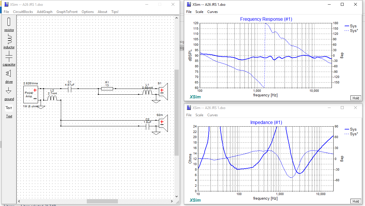

Just wanted to share an XSim model of the A26. It's reasonably accurate, but the raw driver data comes from images, so the impedance is pretty ragged.
Anyway, I though it might be a good reference in case anyone was curious, or a newbie wanted to play around with XSim or what not.

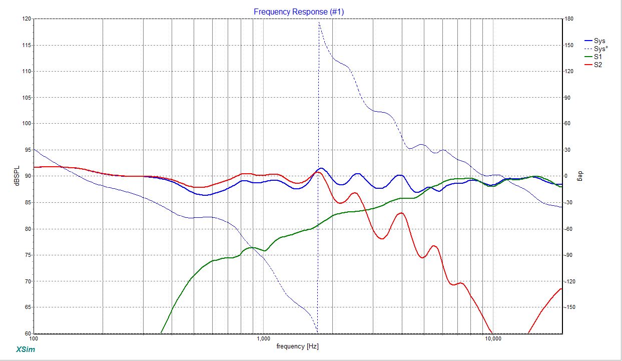

Just for fun, here's the FR plot. The complete XSim file is zipped and attached.
Best,

but what are the 30,60,90° curves.... a 25 cm cone Sd means it beginns to be not pistonic around 1 000 Hz and start beaming jut a little above !
Maybe we could expect than a little 3 db dip off axis à la BBC study between 1 000 and 2 000 Hz is liked ?
Erik, did you ever listened this Kit ?
Aha, Troels would be flaten the impedance curve around the XO points as he did for the Proac D15 .... and maybe uses an AUDAX 35 mm driver... without the 10 ohm resistor in serie !
The four layers voice coils of the A26 driver certainly makes not the best drivers unit around, no ?
Quick improvement by adding 0.68 mH as a 2nd order to the tweeter
Significantly better tweeter power handling, on-axis response,
driver phase still being ok. The XO point is pretty much defined
by the woofer's LP response, the only issue left being the tweeter's
HP and padding.

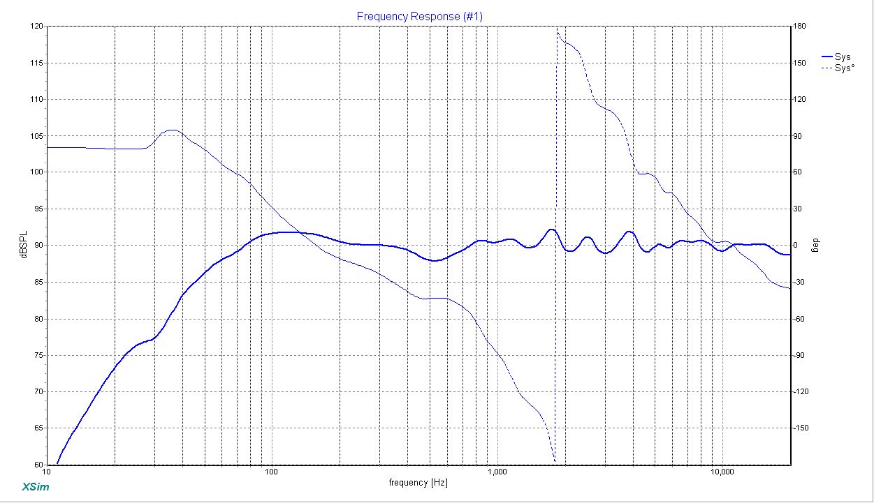

So the acoustic distance used for the woofer was estimated based on the published FR of the completed kit and interferometry. :) In other words I moved the distance until my model matched the published FR. It's easily possible I made a mistake.
Still, I like Lojzek's approach a great deal. I had tried to get fancy, by doing a 2nd order low pass and high pass filters, and that just went belly up. Lojzek's idea to just add a coil is pretty masterful.
So, adding an 0.91 mH coil I get to nearly perfect phase matching at the Xover point, but not the most symmetrical inverted response. However, as noted, this is just in simulation. The actual acoustic distance needs to be known. :)

Next, check your phase. Invert S1 and examine the FR plot. Should have a nice icicle form at the crossover point.
Turn off the system curve, and turn on S1 and S2, with phase to examine phase match directly.
