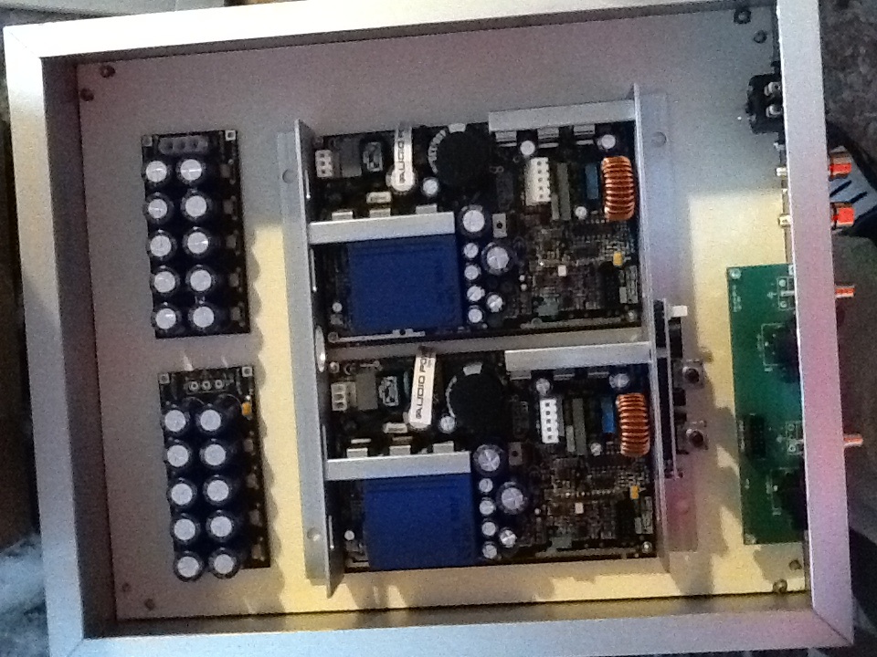

but, maybe, i miss some connectors...as usual :(

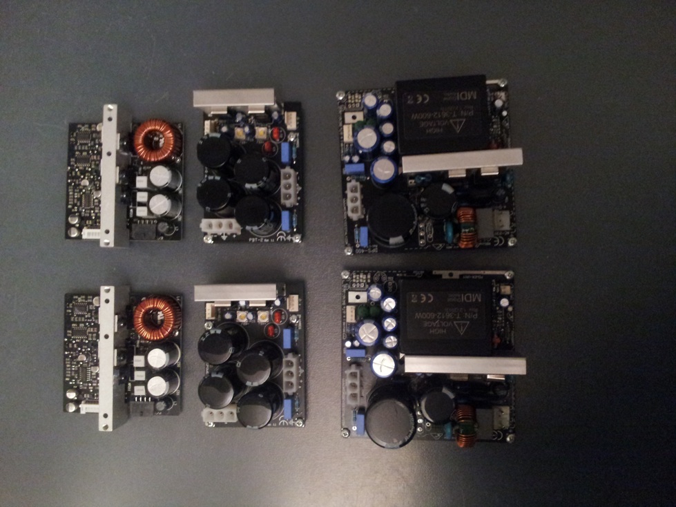

Very ironic..i'm not able to listen to my "transoceanic" mda due to the missed connector and pins..
As usual.....and, as usual i apologize for my poor English
Ciao

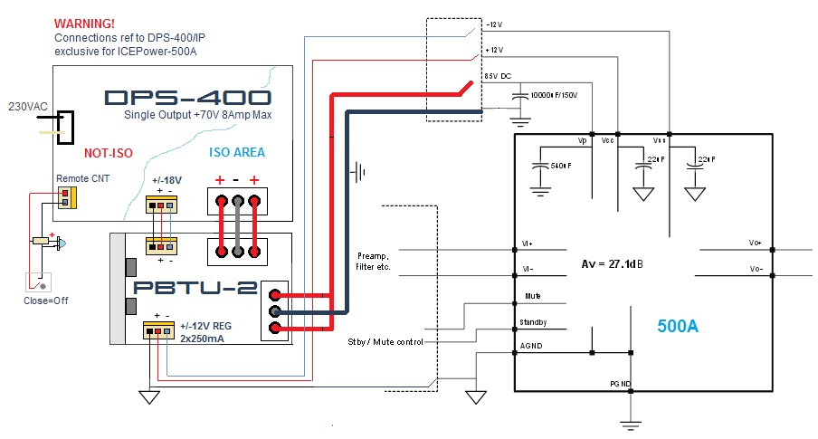

Ok, DPS400 for IcePower ASP500 arrived, now I have to just connect all them together...
Next look for a suitable case.
Hello Danilo, this is the connection diagram for your DPS-400.
I think it is simple, however, are well available if you want, even to the arrangement of the modules.
You should have no problems with noise even if you assemble it on a wooden base for the test.
Regards
