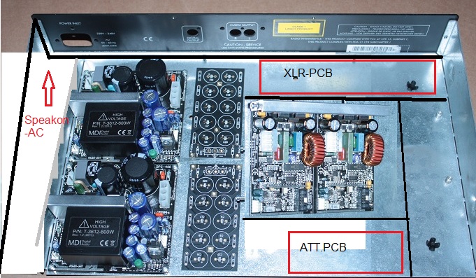

as you know I plan to use 2 DPS400 to power 4VSSA which will be in a 2U box.
would you recomend to insert additional common-mode self between the DPS and the PBTU or between the PBTU and the VSSA boards to "completely" reduce residual HF noise ?

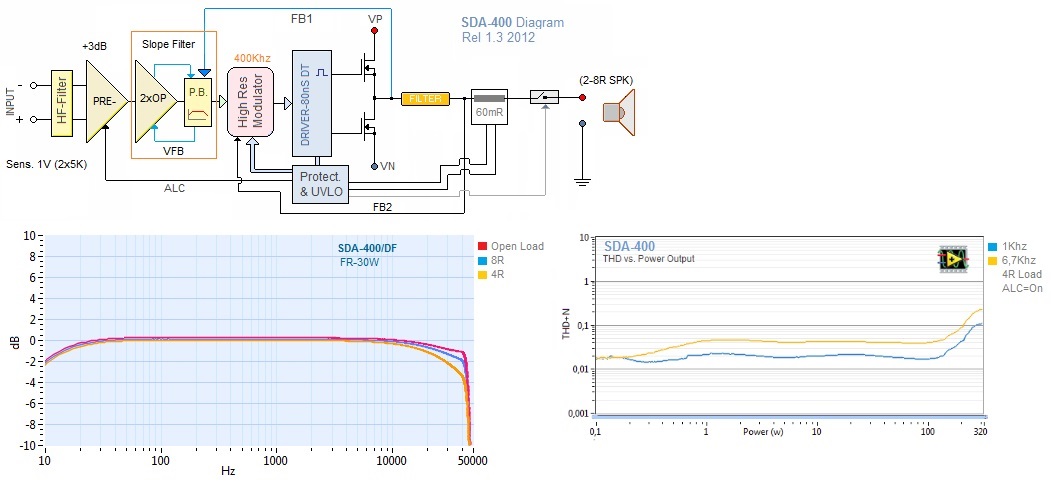

Hi,I plan to use VSSA for mids and highs and SDA for woofers.
can you point on a datasheet, or can you explain if the SDA has a high pass filter or if it could work DC coupled ? I want to do some "motion feedback" and then I would need 0° phase shift, or a few. thanks.
Also is this possible to modify gain ?
finally do you recomend a DC protection or delay at start up ?
this is the block diagram of the SDA-400, as an evolution of the SDA-300 (not in production).
The amplifier is equipped with all the protections, as dc offset guard, speaker short-cut, anti clips dynamic, output relay gold contacts and thermal protection.
Power-up is delayed with LED (3 sec.) As a complete amplifier of market.
Input as DC up to comparator pin.
Not need emi/rfi filter, it's as mute without problem,also is stable (you can disconnect- re-connect load while SDA-400 work in clip region without any problem.
The SDA-400 is widely used in the field of professional PA, since 2005, with 100V line transformer. but the company that requested it, he wanted some special features on the voice, and excellent definition on the high range.
From some years, is used as a tweeter drivers in high fidelity, I think this means a lot for an amp in class D.

Maybe is better you route amps (as heatsink vs. rear case) and put PBTU-3 near DPS-400. I not see a problem in your config, but is better that input board not see toroidal filter.looks possible
have to say, in my case, even a bigger heatsink, just with shorter fins, would have been better, leaving a little bit of the needed exstra space
I tested well this heatsink with sda-400, he delta temperature does not exceed 20 ° in any condition,obvious you can change.

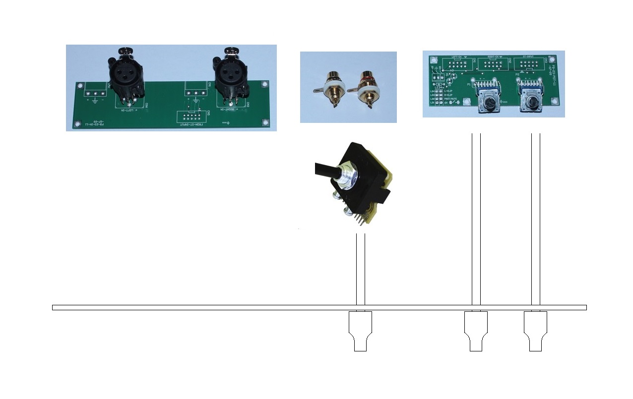

If you want input selector, it's better near xlr pcb.
everything has been well studied , such as the input board and flat cable , to allow a simple and clean connections without noise.
After put some designs that can help you the best possible installation .
will leave the heatsink be
but I need a bigger/deeper chassis/box
the input selector will be placed between back panel inputs and XLR input PCB
tried a deeper box chassis, but that does not change much really
having a small space issue around the mains input plug area, because I want to use Neutrik in/out
may sound weird, but my main problem is that is very little room for using extention shafts to input selector and attenuators
I may have to mount attenuator board directly on front panel

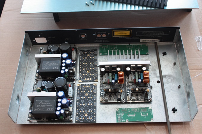

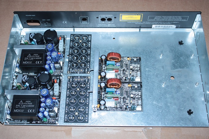

Hi Tinitus,maybe
I not see a problem, try this config.
moves to the front the sda-400 and add heatsink.
Ahahah..now yes.
You can use "L" profile also for dps-400
