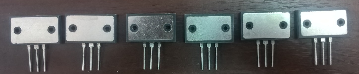

The original sanken's would most likely be HEAVIER. MT-200's are all to-3p's welded on to a MT-200 slug. The to-3p slug's weight would be added to the MT-200's. Those fakes just have a die glued to the mt-200 (no to-3p slug). A sensitive letter scale would most likely show the difference (real thing would weigh 4-5 grams more).
I have broken open hundred's of mt-200's (classic Japanese amp's)
OS
Reactions: 1 user
Original Sanken parts usually have the HFE rank/grade included in the printed marking. For the 2SC2922, it's the last letter in the marking O,Y,P,G. Check Sanken's datasheet for valid HFE grading on specific parts. If the letter is missing on the device itself or not a valid HFE grade as per datasheet, it's a fake.
Check Sanken's website ->SANKEN ELECTRIC : Power Transistors : For Power Amplifier for current products. Most of their current transistors can replace their old discontinued transistors. I would stay away from parts that have been discontinued for a long time. The chances of these being fake are very high.
Originals also have mold markings on the some of the 4 small holes/depression. It could be a number or letter.
Fakes are not flat on the back side. Lay them on a glass or really flat surface and try turning them. Fake MT-200 transistors will turn more than once simply because they are not truly flat and even.

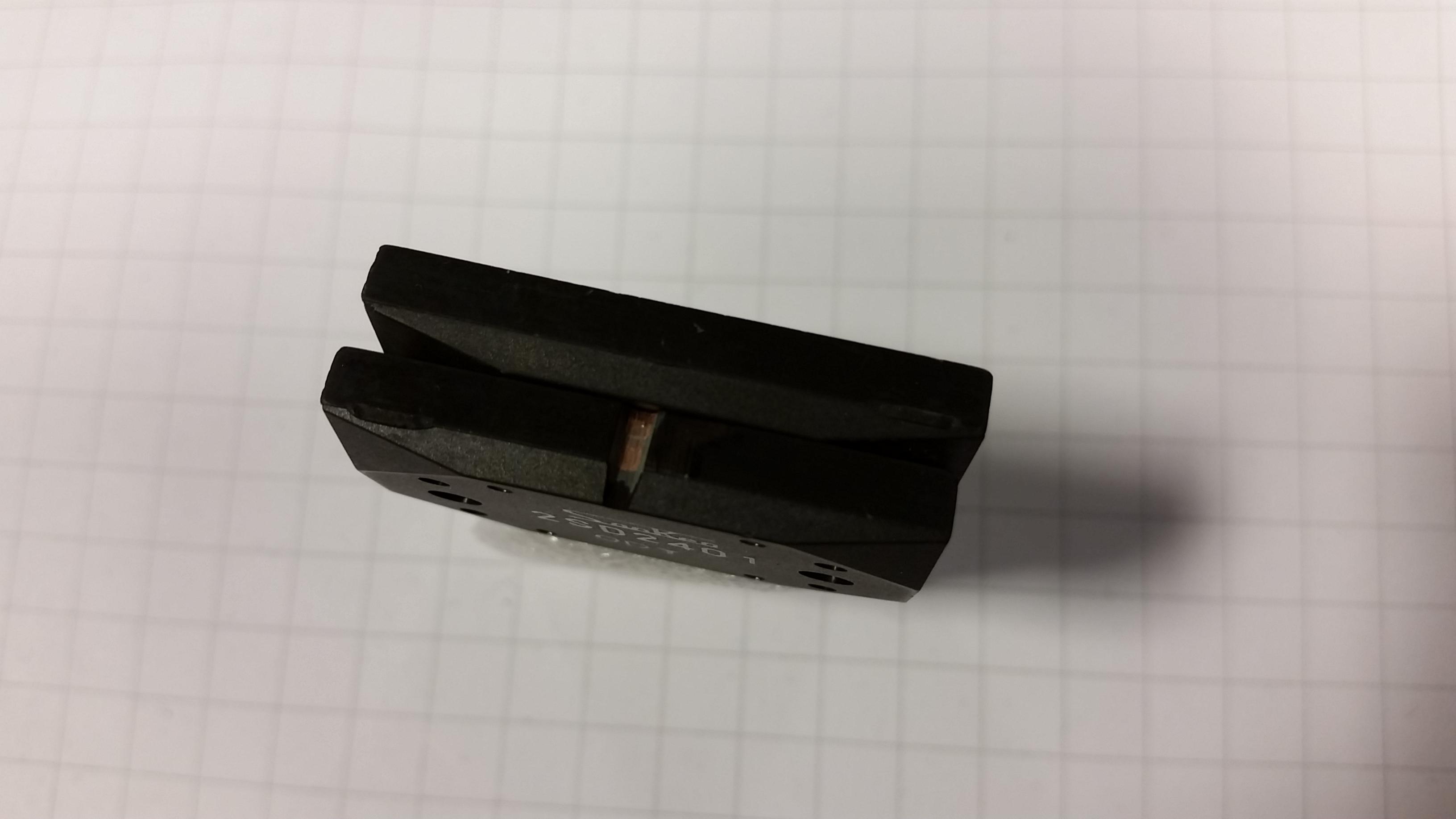

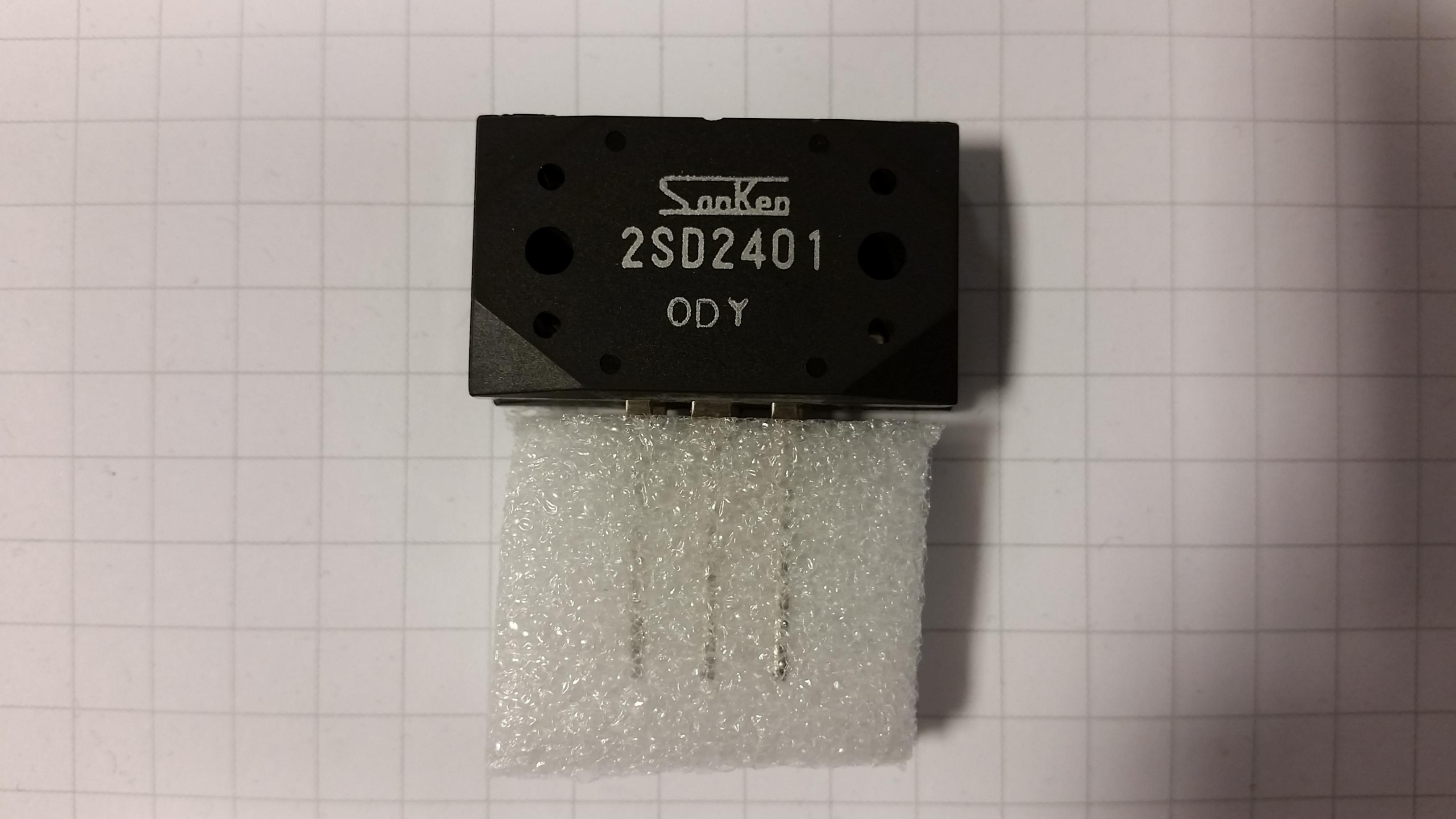

Not the same device as this thread is about, but if I may I would like to tell you that:
I just got 2pcs of 2SD2401 from eama0910, a chinese ebayer.
-Markings look like pretty bad print quality
-I got Y instead of P (P on the photo)
-I measure quite reasonable characteristics
-Cut the casing a bit and guess what...double thickness.
Measuring B-E capacitance at 10kHz 1V gives 6nF, at 0.2V about 0.3nF
I guess 1V is enough for the transistor to conduct and thus value is different?
I was so afraid to order from China that I ordered in parallel from UK.
Transistors from UK look also good.
Photos are of the chinese transistor.
I guess they are genuine then? Or what do you guys say?

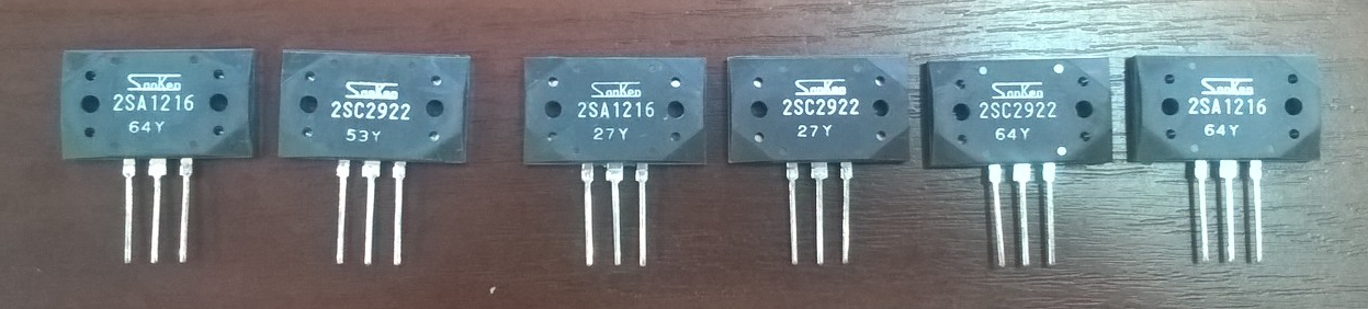

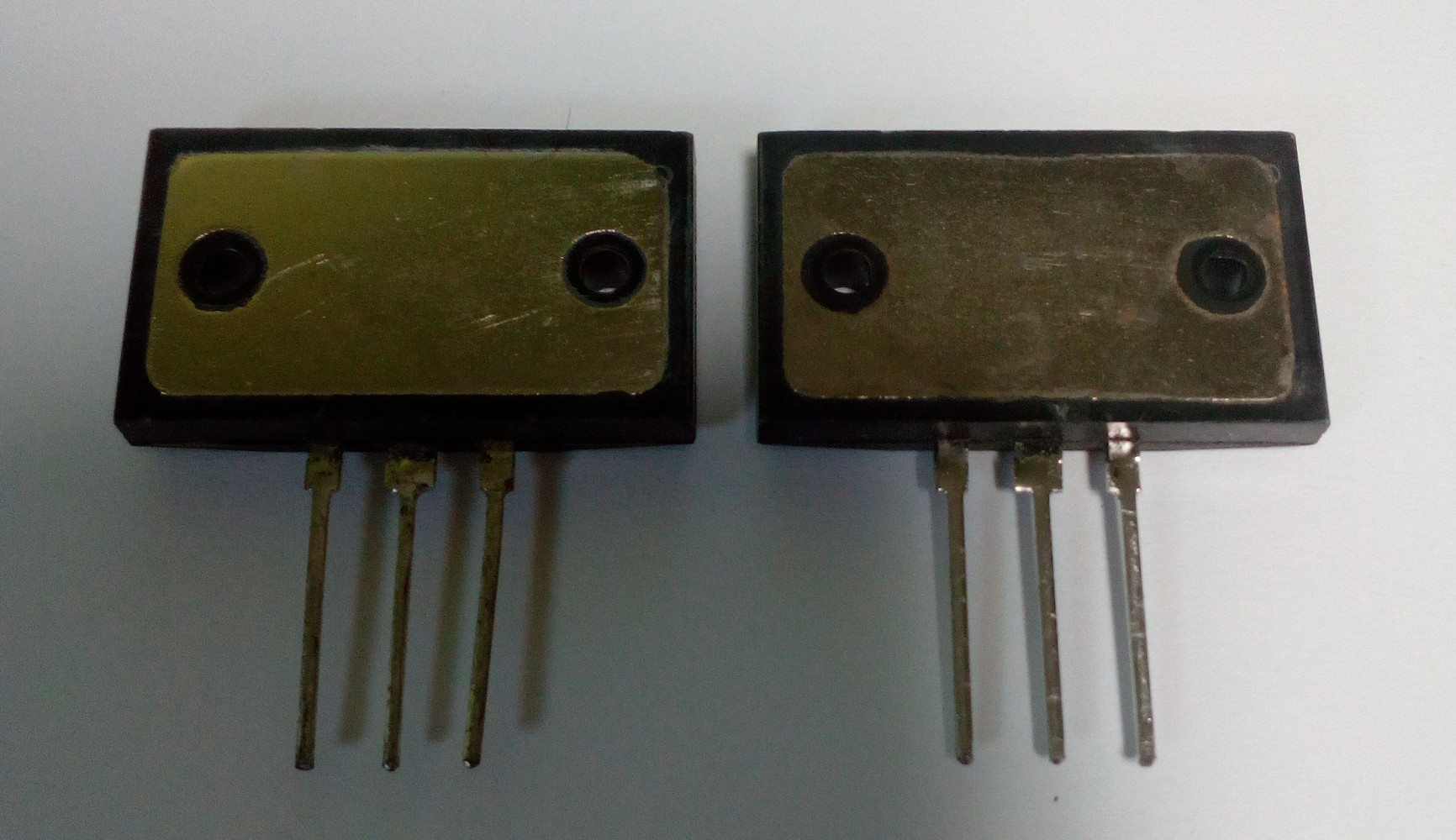

I need to buy pair of 2SC2922/2SA1216 transistors. Unfortunately, they are officially only available in Digikey and they are too expensive. Therefore I looking for other local supplier. I found the transistors here -> 2SC2922 + 2SA1216 tranzystory SANKEN NAJTANIEJ!!! (6221015604) - Allegro.pl - Wi?cej ni? aukcje.. But I am not sure they are not fakes. Pay attention on lot number.
I still have this picture from the back.
What do you think about that? Fake or genuine?
Thank you!
Thank you!
Fake for sure!!!Look at those metal tabs from the back.They are not even straight,very bad quality!!
