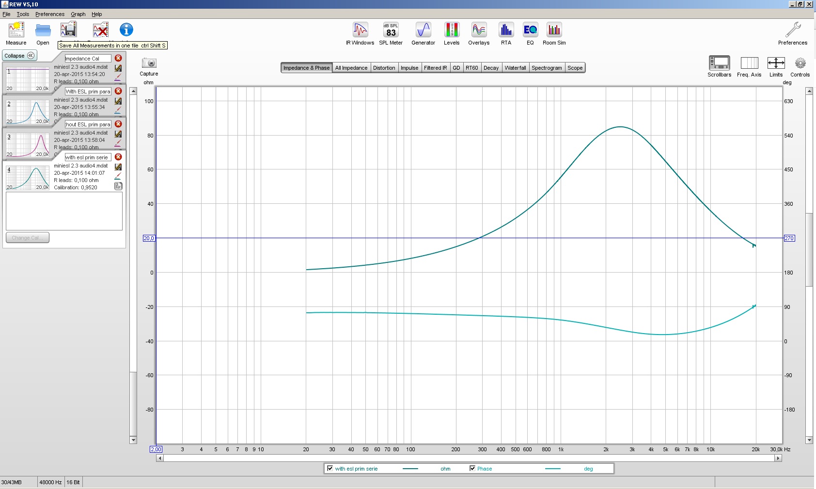

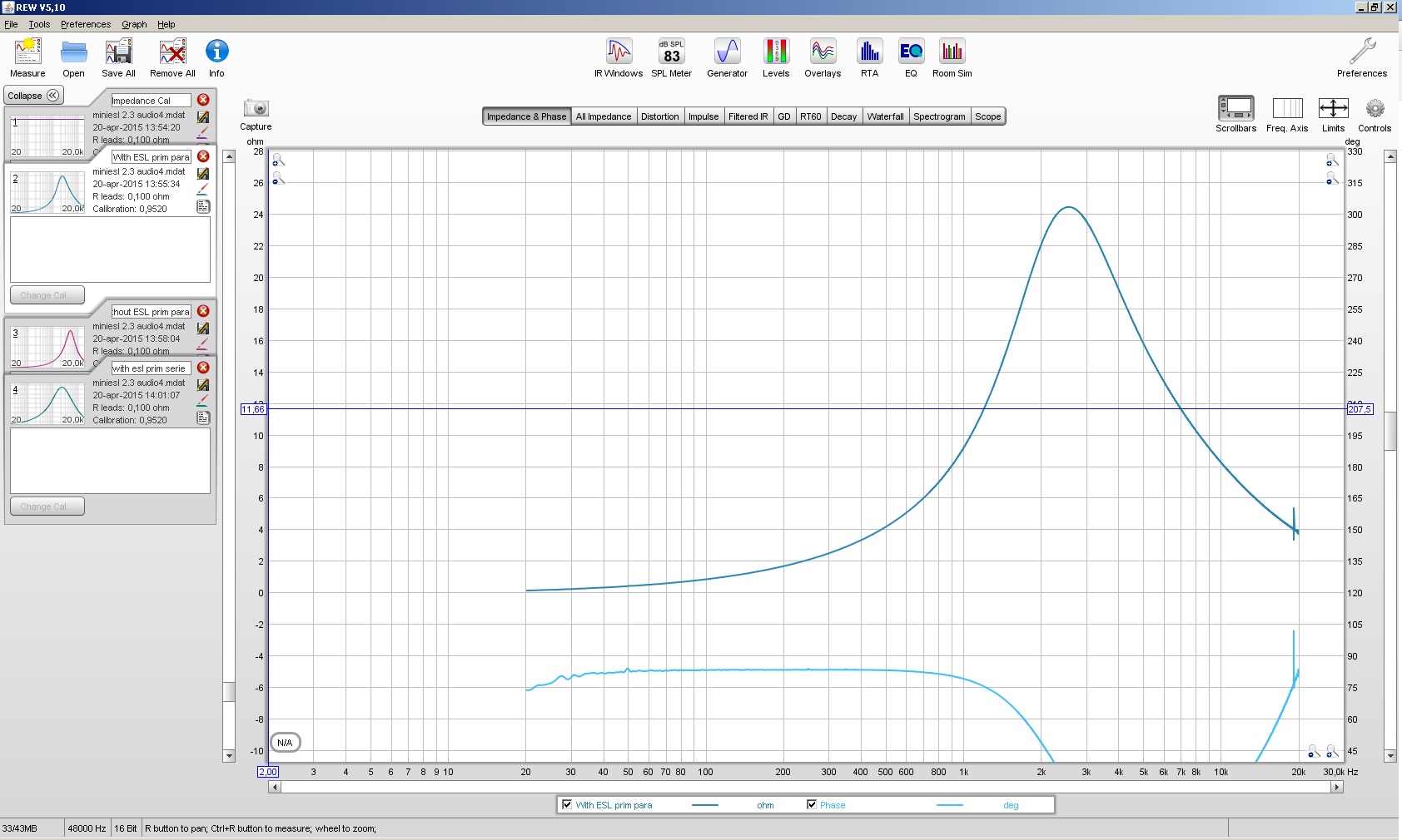

The plot vertical scale should be in (ohms), not (dB).Here are the impedance measurements.

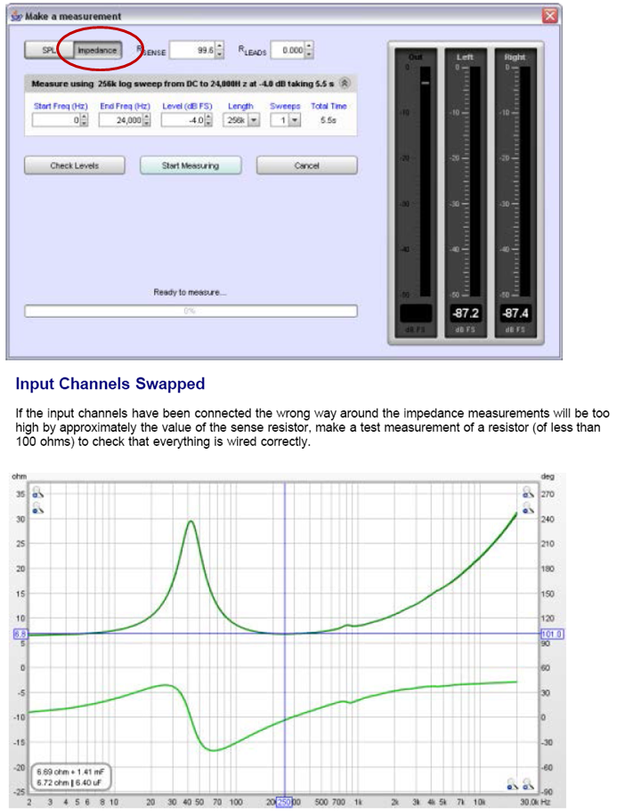

Did you select [Impedance] in measurement window?
Take a measurement of a 2ohm - 10ohm resistor to makes sure the measurement setup is working correctly.
It should show the correct resistance magnitude with phase close to zero for most of the audio range.
Ha! I have never seen dB and ohms plotted together.i can make some screens where it is on the left if you like
Can you show the phase for the impedance curves?
I think you may need to go to the individual impedance measurement tabs to see it.
there we go , just noticed the alt button to make a screenshot only of the window needed instead of a dual screen haha

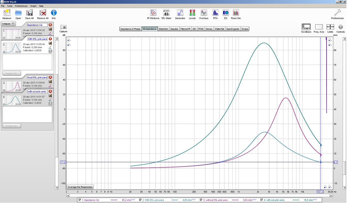

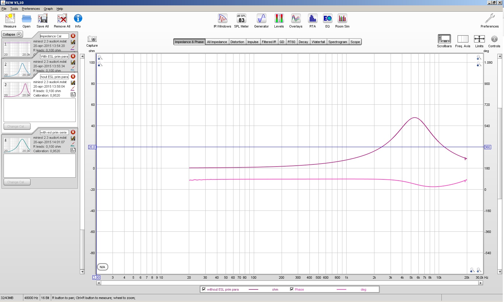

wel here they are, dont forget i scaled them to get the most accuracy as posible so a higher peak doesn not mean a higer value, since the values on the side change as well
1. With esl primary paralel
2. With esl prim in series.
3. Without ESL prim paralel

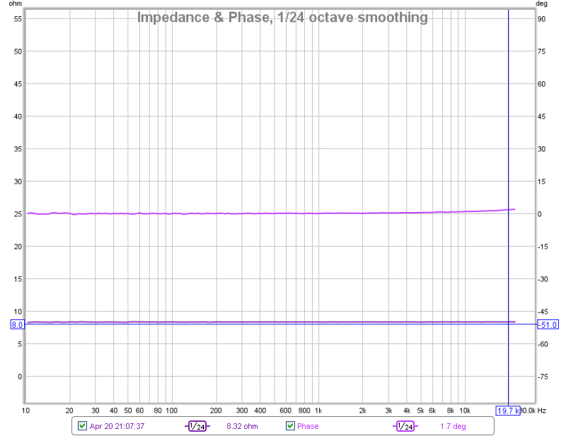

I'm still not sure what to make of the measurements. The general shape of the impedance magnitude looks about right, but the phase is all wrong. It should be (+) below the peak (ie inductive), pass thru zero at the peak and then (-) above the peak(ie capacitive), and finally passing back thru zero at the dip which defines the HF roll off point.See pic #1 for example toroid transformer driving large ESL hybrid panel....here they are, dont forget i scaled them to get the most accuracy as possible...
You might try measuring an 8 ohm resistor and make sure the phase is zero over most of the audio band as shown in pic #2.
If your impedance magnitude is correct as shown in your plots, then the transformers are not the cause of the -12dB/oct roll off in your response.
Perhaps you didn't have the mic calibration file loaded properly when you took the measurements with HolmImpulse?
i will measure a resistor to see what happens to the phase, btw in the calbration one the rsistor stays at 0 degree. but i will measure another resistor as well (dont have an 8 ohm gone be something else in the region of 1-4)
i begin to wonder as well what it might be, i did had the correct file loaded.

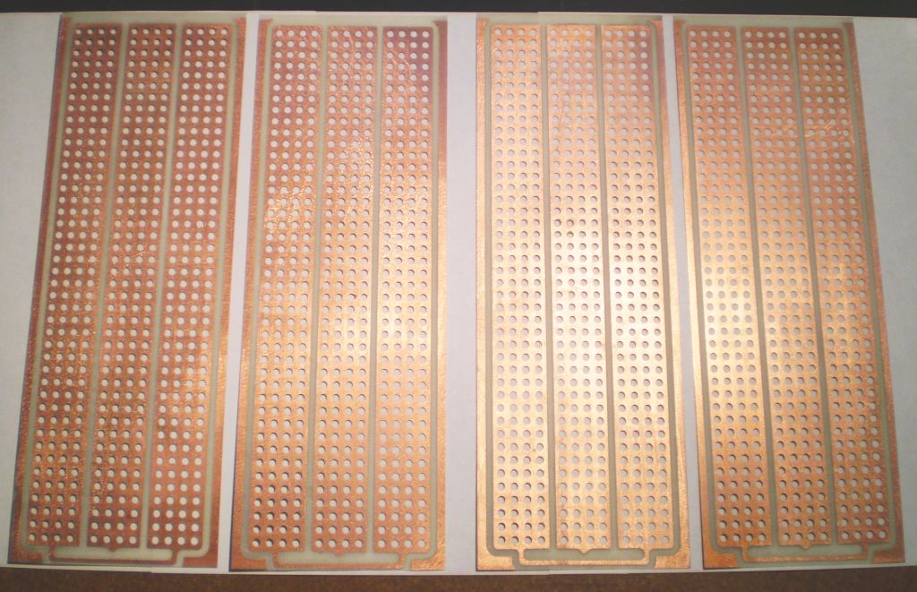

Here is a picture of the PCB Stators that was sent to me for testing.
They look very nice and the repeat ability is pretty good too as long as the boards are stacked going the same way.
I am sure that you are aware of this as you said you are still working on it.
Otherwise they look nice and thank you for sending them to me.
The size is exactly the same size as the panels I had burned up except it is 1/2" longer, it is all good!!
It will even fit my new TIG rod frames as well, just need to make some support pieces and it is a bolt on unit!! He,he,he
The active area as measured is 810mm X 2600mm with 516 3.5mm holes in three sections of 12x43 holes.
I calculated this to be a 23.5% open area as 4963.92mm^2 / 21060mm^2.
Due to the size of the holes this shouldn't be to much of an issue, we shall see once I get them running.
I think that one of my painted mesh stator version's had a fairly low open area in this range as well.
Cheers!!!

Geraldi am glad you received them in good order! did you burned one membrame already ? you must flip the copper to the outside , ooooh i now see you only have it there as comparison haha thought well thats fast , burned already . the open area i used was based on a panel from the brand solosound, although they used even larger holes. always likes the efficiency from that panel and never noticed anything weird from the low open area, so i adopted the same open area.
they used 0.8mm - 1mm pcb, dc spacing of 1mm and a whopping 5.5Kv bias ,
also yes they are not exact mirror image i noticed, its not the cnc that failed rather the CAD program or CAD user when you put them on top of each other they are indeed exactly the same just not when you flip one

Yes, I figured it was an error in your program setting as one set of holes is about 1mm off center with the other two sets, No biggy!! He,he,he,he

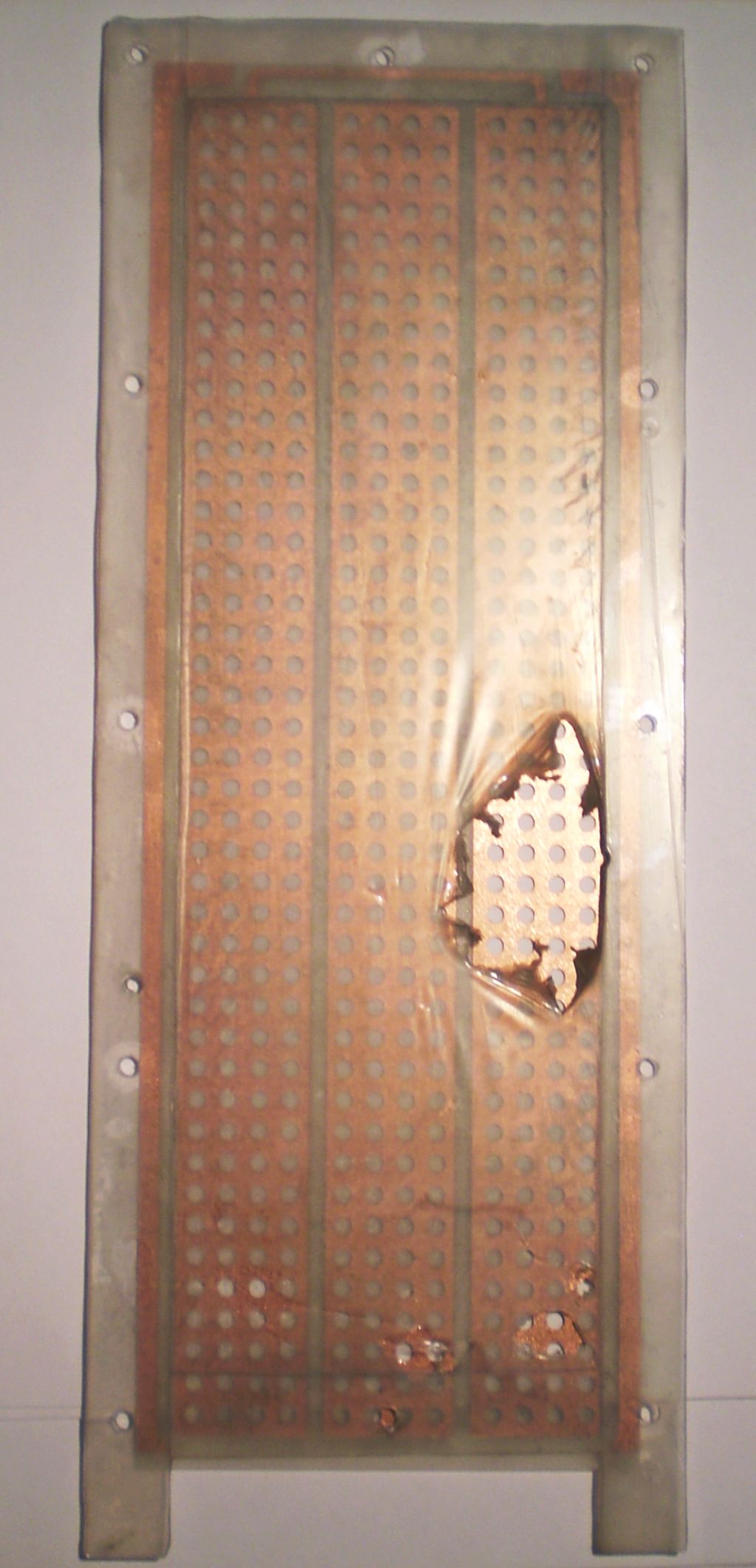

That burnt diaphragm was from the panel I had burned up and was just sizing it up.
I will show you the progress as a go, I am going to build special a set of frames just for them and see if I can push that bias all of the way up like the last ones.
But without burning them !!!
