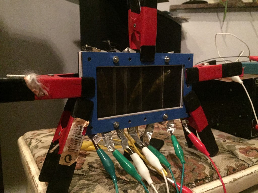

Here i could not resist in making a recording of the contraption playing.
its a 5 stacked with 0.5mm dc spacing.with 3 micron foil. the stators dont have coating but still cna play pretty loud. crossed at 600hz, a bit to low, but better luck next time. measurement is pretty ok.
i did not get the thing to spark yet... but the whole thing is really picky about good connections. since i use the aligator clips this is sometimes an isue, and will result in arc's and all sorts of nasty stuff

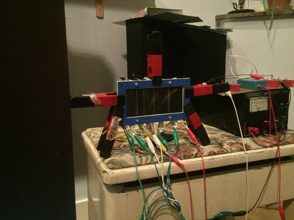

Hmmm ok the anoying peak dip and distortion at ~ 1khz is weird. when i put something in front of the stator (really close) it shifts down and distortion is normal , but its crap agin 50 hz lower. wtf is this ? could it be something with dimension of the panel? i tried the new glue and result was the same.
Thx calvin! thought about that to but was not sure if i had to devide it by 2 or 1/4.Hi,
if there's a dimension of around 17cm and multiples or fractions of that, it'll show as peaks or dips around 1k.
jau
Calvin
hmm well height is 108m mm and width is 50mm. so both dont really work out. still do think it has something to do with dimensions of the foil. there is only one way to find out i guess. Or it is the stator material refkecting some frequency back. but with a stator to stator distance of 1 mm i would expect that to be out of hearing range or at least certainly not be at 1.140 khz,
witch would then be 340/1140 /2 = 0.149 meter = 14.9 cm there is nothing that is close to that size.
only the width will fit in 3 times.
i tried adding a piece of doublesided foam tape to see if the frequency shifts because i make the surface area smaller, and it did.
hmm its anoying if i cant come up for a reason why its there would like to see a theorie that corresponds, not just a solution
One thing certain is that width of 5 and height of 10.8 is never a good idea since both are multiples of a frequency (or at least very near witch could explain the peaks and dips having to humps very close to one and another)

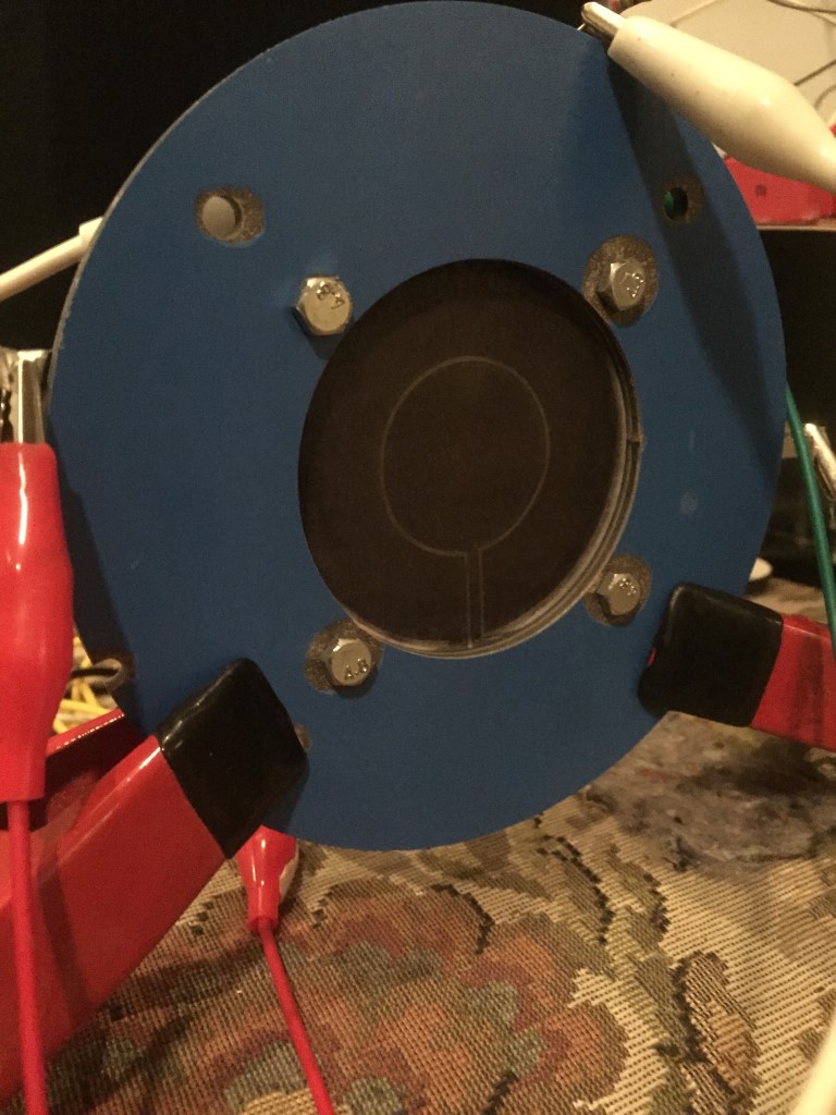

So first panel i made with this mesh since i ran out of the other mesh. but i tested if i could print etch resist on it. then remove the conductive coating to create sigments.
and i am really pleased with the result, pretty straight lines. (will make a better pic with some more light)
I used 1mm spacers this time since it was all i had laying around. but it still is a nice way to test if i could use polystyrene and test the sigment printing. and well it works.
polystyrene is not as rigid as the glass epoxy but because it is sandwiched between 2 pieces of very rigid HPL, the polystyrene spacers that hold either a stator mesh or a membrane, are gettign forced to be flat and stretch the mesh stator at the same time. And yeah polystyrene is like 1/4 the cost of glasfiber and is way way way nicer to cut
the picture is 2 stacks and it is sigmented in 5 parts, between every part is a 2 mm wide isolation line. the sigment to the left is for high frequency etc.
Gained a healthy 9 dB from one single esl to 2 stacked esl membranes. should be no more then 6 dB....... i also could increase bias, so something changed.
I did stretch the membranes a little tighter so might be it was a tiny bit more stable(3 dB more stable). although the resonance is still on 400Hz will post measurements later on when i managed to add some stacks and begin playing with the sigments. i used it now in full range to compare to my version 4.2

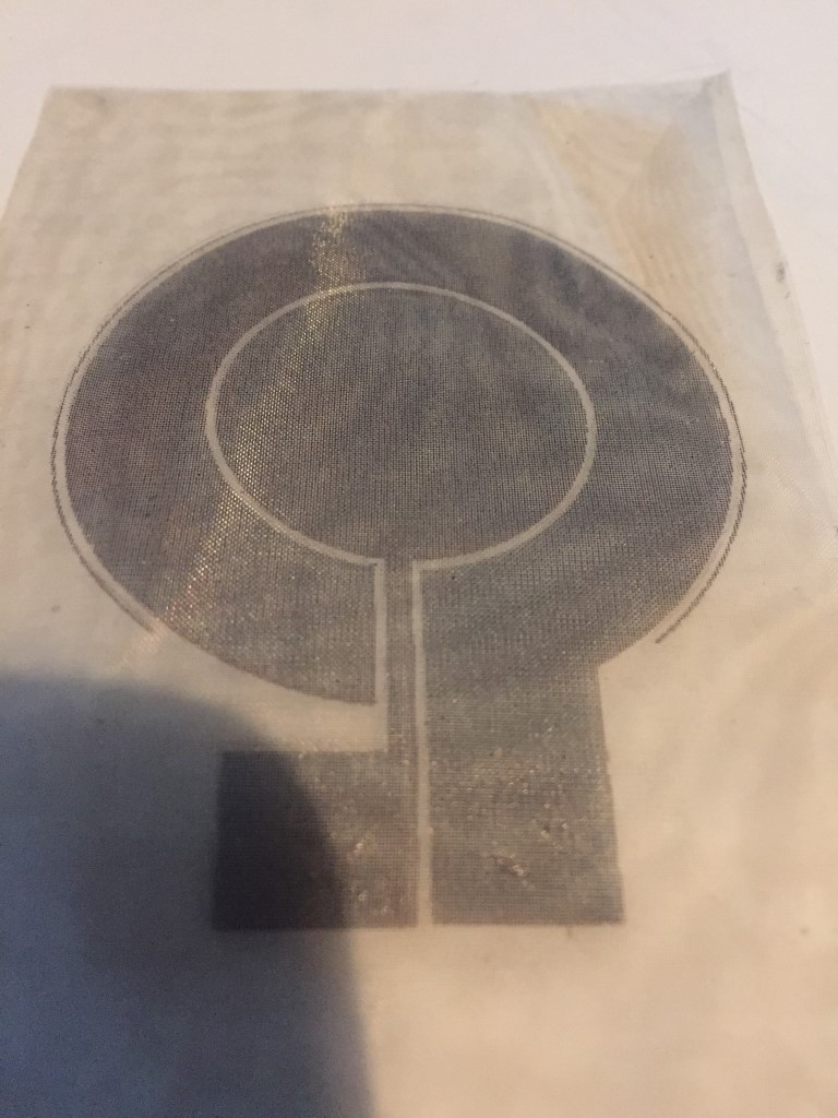

Made a tiny tweeter, produced only 2 stacks so far and did not use the segmentation yet since i need more output first . but i am so pleased with the segmentation on the fabric, i think it is pretty stunning to get these nice segments on conductive fabric with such small traces. i really had a smile on my face when i got it out of the acid
i then had to dry it before i could test if there where any leakage path's at least on my normal meter up to 200 Meg no conductivity (first did not let it dry proper and thought i had to etch it longer until everything was goen ). the conductive traces measured from 0.2 to 0.7 Ohm
