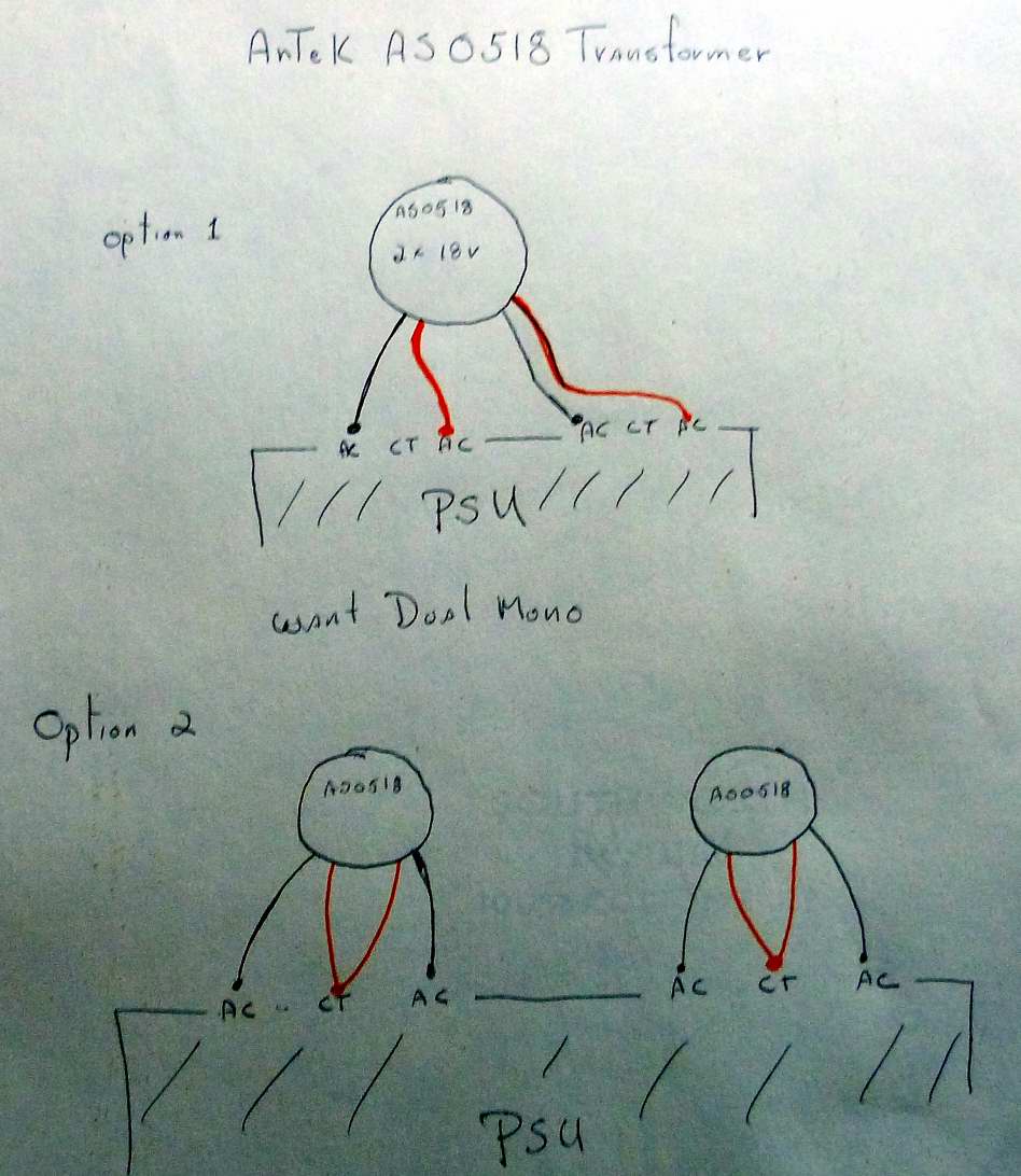

Hi Salas,
I'm just about ready to power up my pre but before I make a mistake I want to run the trafo wiring by you. I'm using an Antek AS0518 which has two sets of 18v secondaries. I plan to run dual mono for the PSU, your PSU has a spot for the center tap in the AC in. Do I just hook the secondaried to the AC in as in option 1 in the attached pic, or do I need to wre the trafo to have a centertap like in option 2 and get two trafos ?
Thanks,
Paul
Thanks,
Paul
Thanks, already have a second one heading my way in the mail.

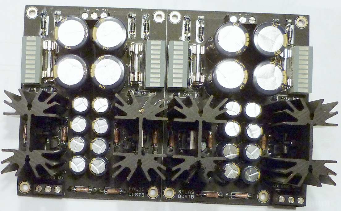

I managed to get my DCSTB power supplies up and running and measured +-17,1 V and +-17,4 V from the outputs without load, so I'm going to leave it there. I also loaded the PSU with 2x66ohm (~2x4,6W) load on one channel and the voltages were rock solid.
At first I had my Q1 and Q3 mixed on the other channel as I didn't notice they were MJE15031 and MJE15030 types. Luckily I didn't break anything, but the voltages were +-27 V on the screwed up channel... Just to remind people to be extra careful following the guide and schematics and not to haste as I did!
According to my measurements the voltage changed from 17,4V (no load) to 17,1V (66ohm), but it was very steady. My load resistors were the limiting factor and they became quite hot as I had only two 33 ohm/3W resistors to use. So only about 5 min loading and allready the resistors were smelling quite bad.

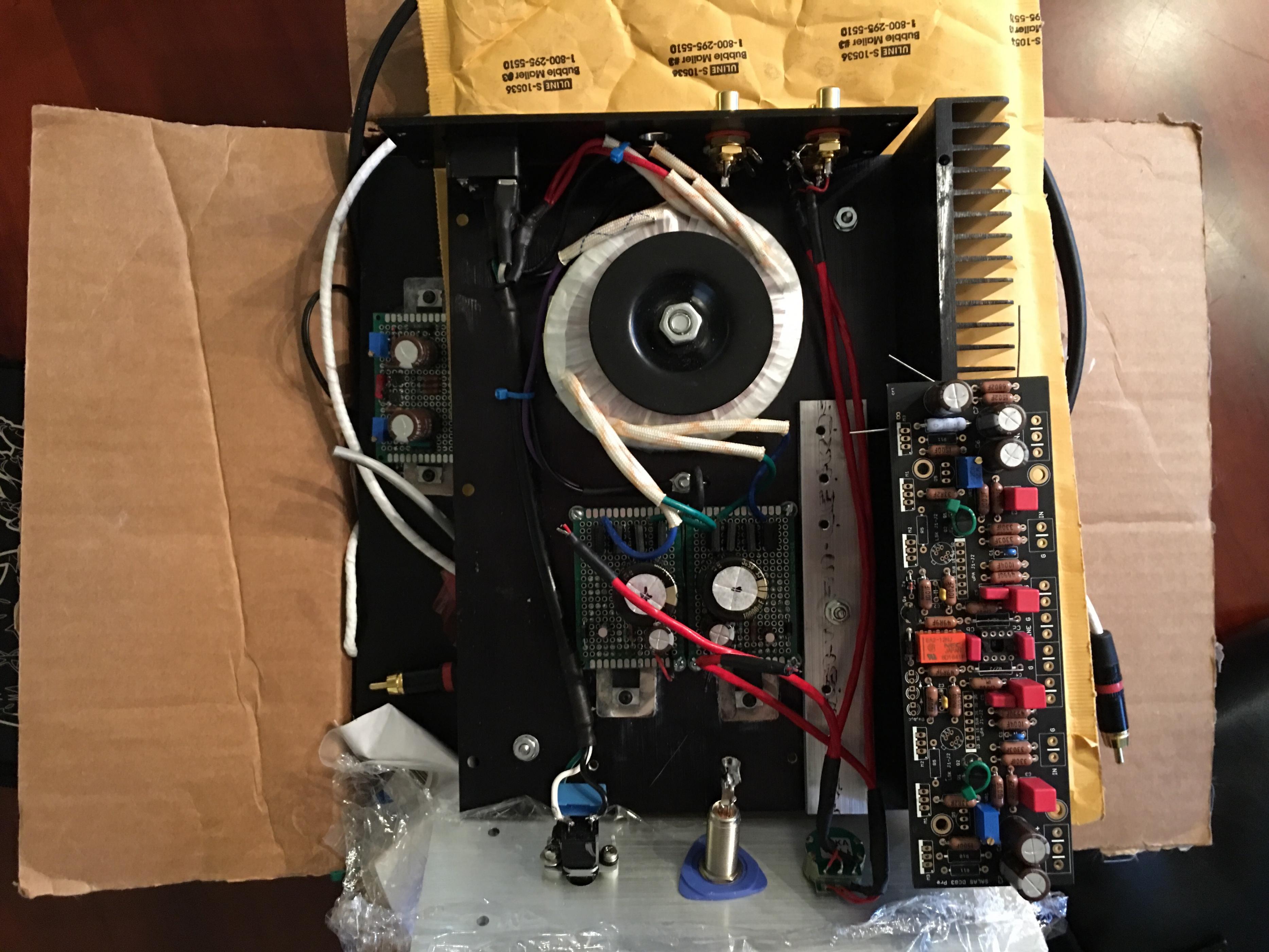

Here is some in progress pics. The case is too small, I know. Psu is lm317/337 followed by a cap multiplier that will sit on the sink opposite of the amp board.
