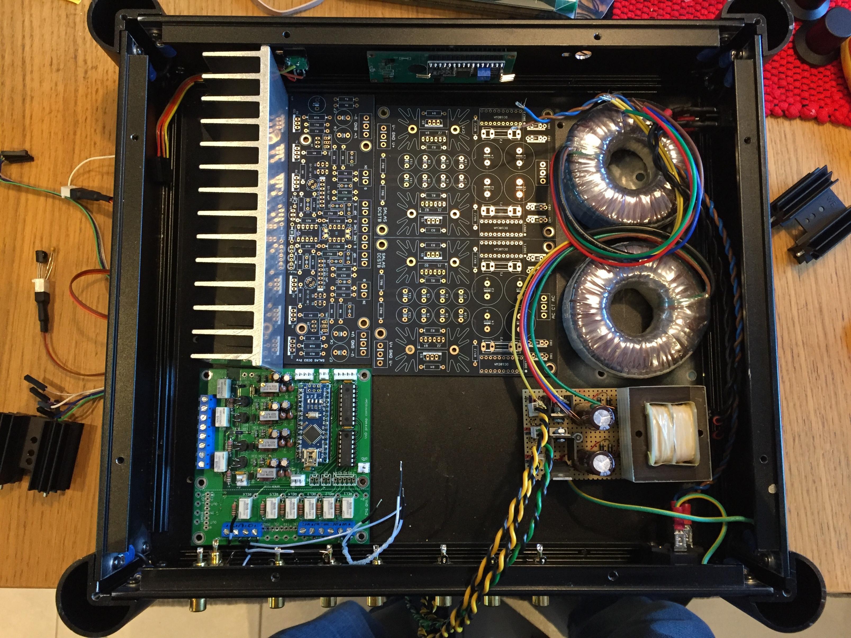

What make is that LDR volume/IO controller you've got - haven't seen it before.

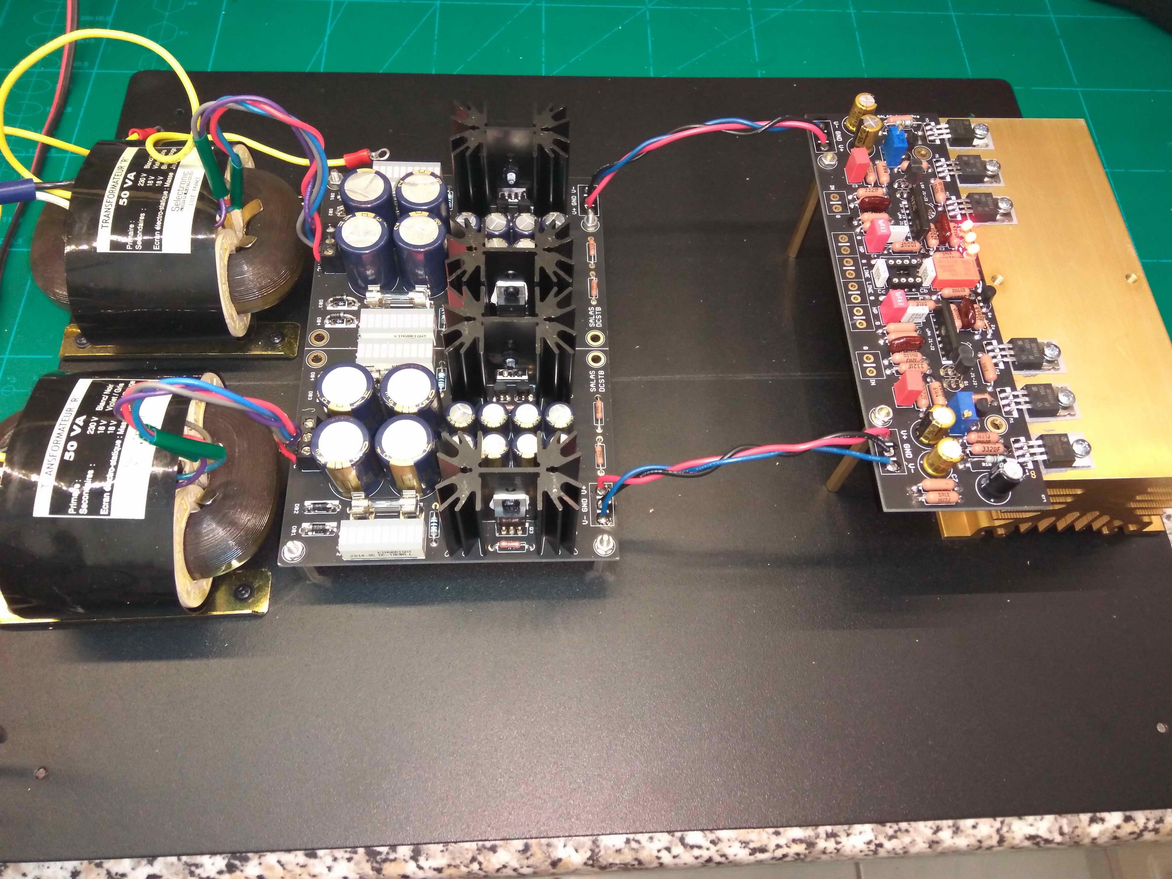

Jeah! I got my boards today and I did some layout placing practices. I think I'm going to settle with this and do the drillings. The green board is a LDR volume/IO controller and the small trafo board it's power supply.
The LDR board is this one: http://www.diyaudio.com/forums/anal...d-ldr-volume-source-selection-controller.html
Specifically I made a version designed by user zdr (Neb).
135mA generous bias choice is understood because your headphones are 62 Ohm and you have a huge sink, but are you really going to use it facing down? How close lucked out your Leds and Jfet parts tolerances for good output voltages and are the pass transistors heatsinks temperatures reasonable?

It' s the only way to fit the sink and the amp to the main plate. Heatsinking is more than enough even this way. Output voltage are 17.28 to 17.55 volts, so I decided not to touch them. Pass transistors heatsinks temperatures are reasonable so far, but I will have to leave them on for longer time to be more certain.
Pass transistors temp around 41 degrees Celsius after an hour or so open air though.
