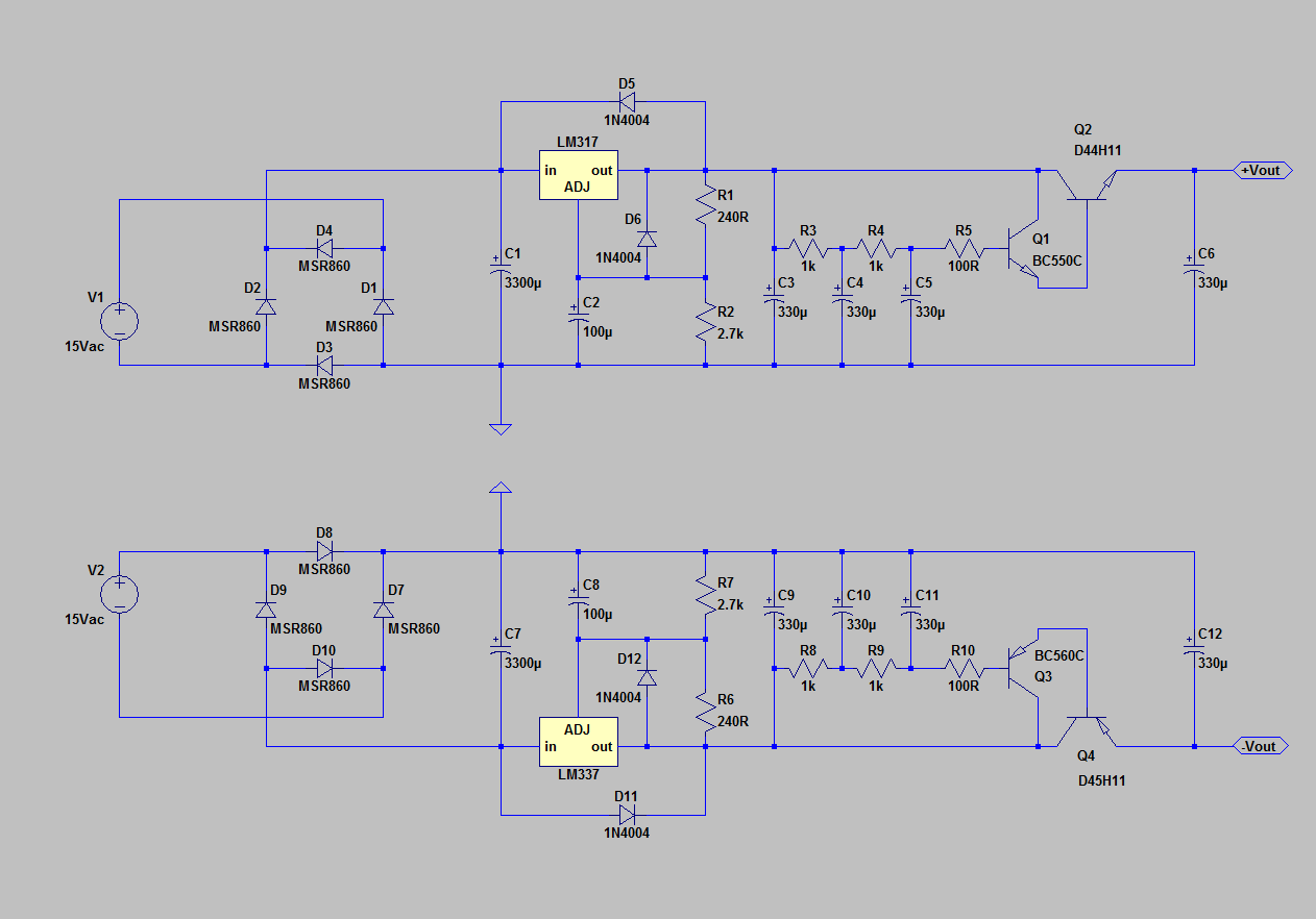

Good question. Looks like this. I believe it's something John Curl has used but I picked it up off EVUL's F5 headamp thread.
I believe it should work well but you would know better than I. It's what I already have, so it's nice to reuse parts.

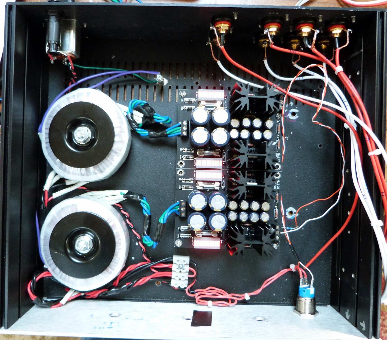

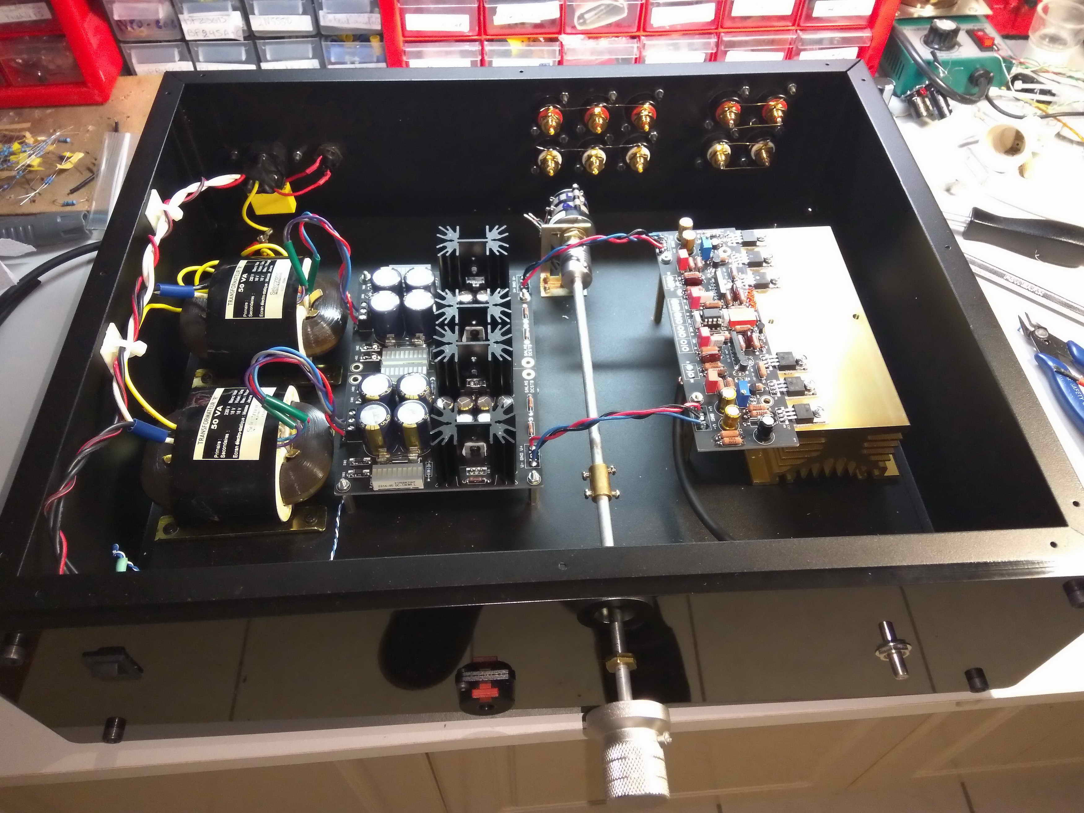

Here is today's progress. I got the second trafo in the mail yesterday so today I managed to stuff everything into a 3U galaxy chassis and get the PSU up and running. +/-17.6 vdc on both PSU's. All of the signal wiring is coax, and I decided to order a new 3position 4 pole selector switch instead of using a old six position 2 pole radio shack switch that I has laying around, that way I can keep the input grounds separate. I don't know if it will make much of a difference but it can't hurt. Everything else is ready to go, hope the switch comes quickly.

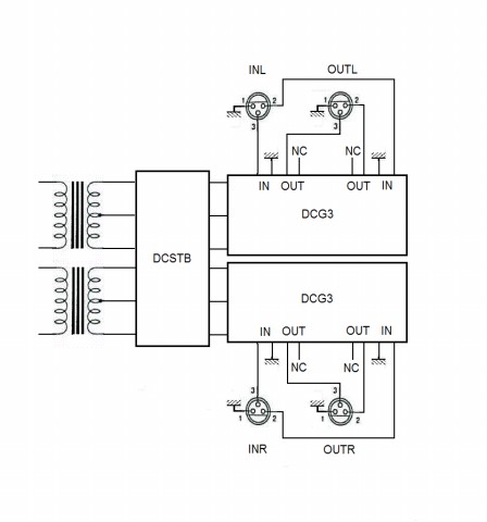

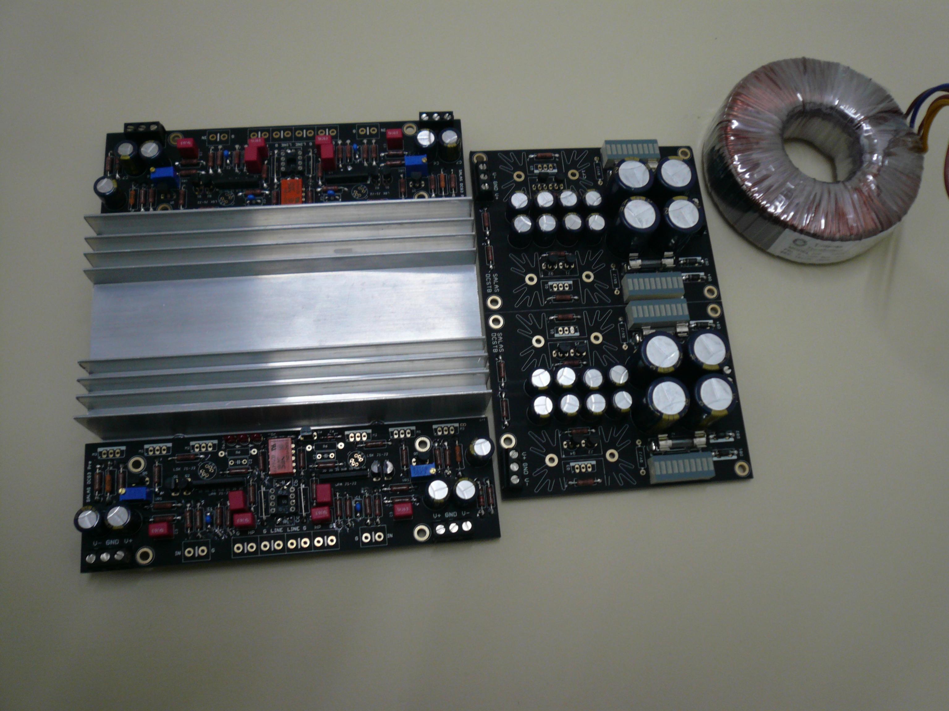

While waiting for another transformer and some heatsinks, I make plans for layout and wiring. Separate psu for each channel but each DCSTB module with 2,5" heatsinks will feed one DCG3 module biased @ 100mA. Theory says that the antiphase balanced signal is self compensating for reduced psu modulation. Plus the DCSTB will be loaded for lower output impedance! Gain will be set @6x - R6 = 2k5 - plus 6db for balanced mode(?) I' m very curious to listen to this!

I was planning to use the case as a heat sink. I have made a smaller sink out of some aluminum stock, about 7 in long, 2 1/2 in wide, 1/4 inch thick. The mosfets are mounted directly to that, and the sink bolts directly to the case side. Much easier to take apart if needed without disturbing the mosfets.
I'm not sure how the rumor started about Mr. Curl designing or using this supply.
I asked him about it a while back and his reply was he had never seen the circuit before, though he liked it.
Then he asked if I was the one who designed it.
I just laid out a board for it and have 10 on the way.
Looking forward to trying it.
What are the two violet and one black wire doing? Connected to a common chassis bolt?Here is today's progress. I got the second trafo in the mail yesterday so today I managed to stuff everything into a 3U galaxy chassis and get the PSU up and running. +/-17.6 vdc on both PSU's. All of the signal wiring is coax, and I decided to order a new 3position 4 pole selector switch instead of using a old six position 2 pole radio shack switch that I has laying around, that way I can keep the input grounds separate. I don't know if it will make much of a difference but it can't hurt. Everything else is ready to go, hope the switch comes quickly.
Paul
The loop areas at the input sockets are very big.
The exposed core should be very much shorter.
The pig tail should be much shorter.
Aim to keep the short pigtail very close to the core for low loop area. It would be better to have two smaller pigtails, diametrically opposed and connected to the barrel beside the core/Hot
