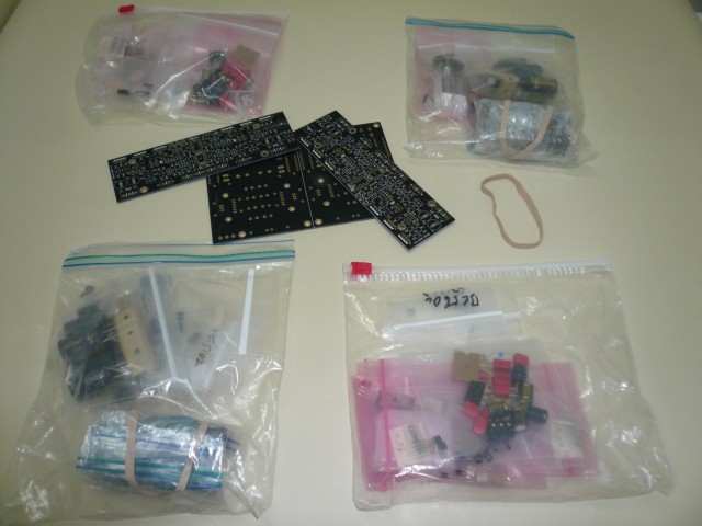

Just arrived! Not bad timing after all... I had to finish a guitar amp for my little nephew meanwhile. I wish the best for the new year to everyone:)

I've started assembling. Those PCBs are a dream! I need to ask a couple of things;
I'm building two DCG3 boards (balanced) and one DCSTB board. Each stereo board will be powered by one psu rail. I think channel separation will be OK but what about current consumption? Is it safe to bias at 150 mA? Is it a compromise to stay at 100 mA wrt sound quality rather than driving ability?
Also, my system is quite idiosyncratic... Preamp actually means a compined DAC analogue output and a line stage together thus, gain is never high enough! DCG3 will be set for 4x - 1k5 isn't it ? I have used line stage with this gain and I know it will do but I would like to know if there is posibility to go higher...

I am not expert; but one PSU get's rather hot, by bias at 100mA when used for stereo setup on one DCG3 board (I did try this when building)... So if you will bias it at 150mA i think you need bigger heatsinks on DCSTB.

150mA output stage bias will make no THD difference to 100mA for loads >60Ω
6x gain can be done with R6=2.5KΩ
