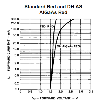

By way of illustration, here's the If vs Vf for an HLMP6000, a cheap, readily available red LED (I've got a few hundred of these in my parts drawer, bought at Mouser). For a current swing of even a milliamp or three, the change in forward voltage is minuscule. You have to be swinging several dozen milliamps before the curvature becomes an issue.
Ben, you're absolutely right, in an actual audio circuit you will not get that big a percentage increase. My point was that it only takes 26 mV change across a semiconductor diode to cause that absurdly enormous change in current through it. It takes even less to cause "only" a 100% swing in current, and even less to cause "only" a 50% swing in current.It's hard to see how you're going to get a 272 percent increase in diode current.
Let's look at some smaller signal swings to see how things change. If you applied, say, 10 mV signal swing to the diode instead, the percentage change is exp{(+/-10)/(26)}, This works out to +147 % on positive input half-cycles, and -32% on negative half cycles. Still very asymmetrical, very distorted.
If you go still smaller and applied only 5 mV across the diode, the percentage change is exp{(+/-5)/(26)}. This works out to +19% and -17.5%. Now we can see that the positive and negative swings are getting closer to equal, i.e. the amount of distortion created by the diode is being reduced.
Let's go still smaller. Get down to 1 mV, and you only have about a +4% increase in current on positive half-cycles, and almost the same -4% decrease in current on negative half cycles. So at this low voltage, the diode is almost linear and creates little distortion.
So these numbers say that very small AC voltages across a semiconductor diode are okay, but the effect of diode nonlinearity shows up rapidly if you drive it with more than a few mV.

The equation you keep using is for silicon diodes, not LEDs. If you differentiate the wrong equation, you'll get wrong results. It's not terribly important, the curves are qualitatively the same, but if you want to do it analytically rather than experimentally, you need to plug in the right constants and equations. Given the variables, I took the trouble to actually set up and measure- again, see the Red Light District article. Also, take a look at the actual experimental If vs Vf graph I posted. Since you're familiar with load lines, you should easily be able to determine the voltage swing from a given current swing- the slope is pretty darn high (i.e., for a given current swing, the voltage doesn't vary much- a battery would be proud!) and there's not much curvature.

Do I believe that it is possible to make a good sounding guitar amp with one or more LED's in the cathode of one or more tube stages? Yes I do, although I don't expect everyone else to agree with me.
I will try almost anything once and I have stuck far more nonlinear things in the cathode circuit than LED's (SY's idea) in quest of good clean HiFi sound and sweet sounding guitar amp bliss (try an ordinary incandescent light bulb).

Sometimes I just stick things into a circuit to see what happens. In the case of light bulbs you can get a limiting effect with a bulb that is just at the threshold of nonlinearity in the cathode circuit on the output stage. A parallel resistor is needed to control the effect.
You can also try sticking a small incandescent bulb in the GNFB path with a resistor to ground after the bulb to force some signal current through it. This allows a reduction of GNFB above the nonlinear break point making for a very expressive amp.
