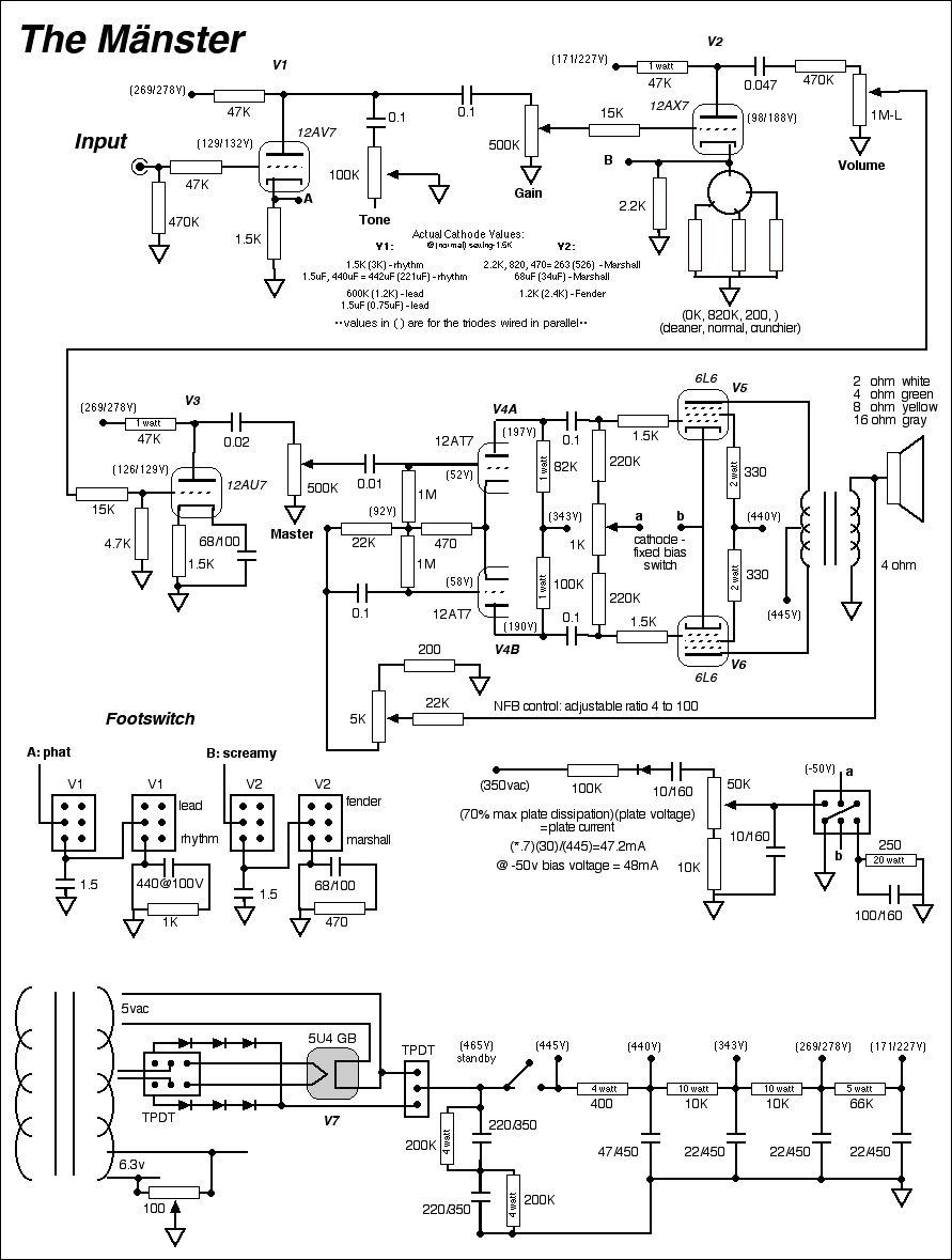

Does anyone know of any issues with using a rotary switch for different value cathode resistors? I tried this and really like the changes it had-crunch to clean. The only thing that is bad is the loud pop it makes with each turn, unless I turn down the volume.
Why not simply us a pot? Then you have no switching noise. Place the pot in series with the lowest value fixed resistor you want. Use a (say) 500R linear pot and then the bias is adjustable for whatever the fixed resistor is up to 500 ohms on top of that. Yes there will be some noise when you tun the pot.

The noise when using a pot in an audio circuit results when there is DC on the pot. If you look closely, most audio circuits have the volume and tone control pots isolated from DC by capacitors, so there is no DC on the pots, and they don't make those loud and scratchy sounds when you turn them for that reason.
But there's no way to keep DC out of a bias circuit; thus, the OP's original question.
