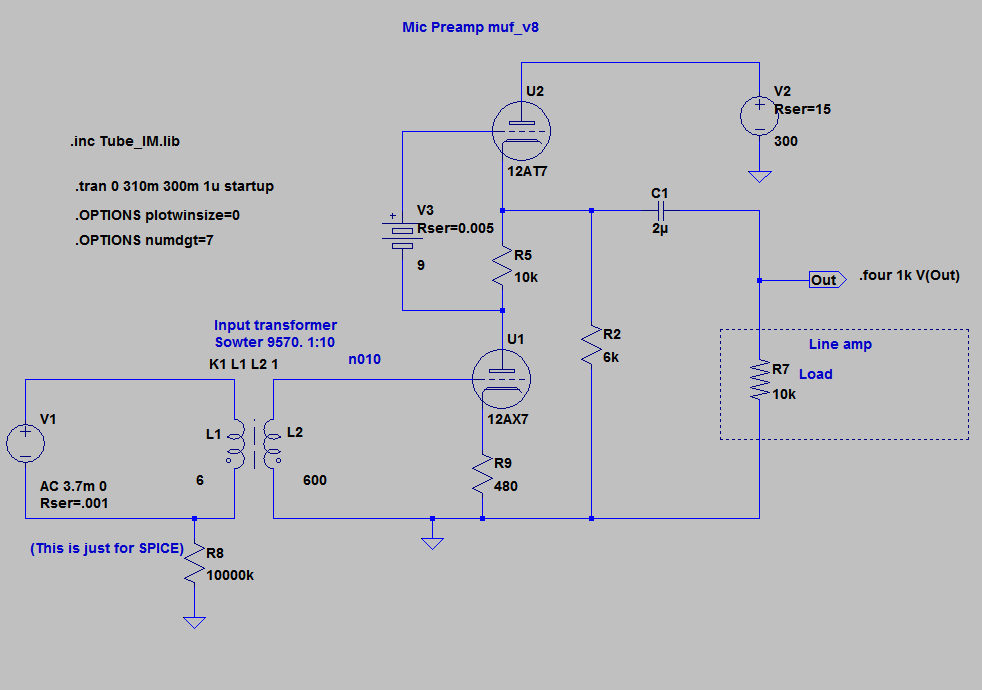

Here is the THD for the capacitor layout:

Total Harmonic Distortion: 0.007506%
Here are the THD logs for the 1:1 trafo:

Total Harmonic Distortion: 0.070315%
My wonder is its ability to sit in the middle of the signal path like how you have done. It can act as a neutral capacitor?

Results look very promising!I have been told that a rechargeable lithium at the cathode there charges its self up as you run the equipment. Its practically self sustaining! I also heard great reviews of the sonic properties this way.
Though I am hesitant to replace very simple atomic device - resistor - with quite complex device - battery - here on U1 cathode.

That guy says "Another advantage is no AC can pass through a battery and it's a fixed bias, voltage, and current so there is no fluctuation.". This I do not think so. Regarding to SPICE circuit of lithium battery from article "Comparison of Several Methods for Determining the Internal Resistance of Lithium Ion Cells", chapter 2.3. AC Resistance, battery can conduct AC.
Chapter 4.9. Impedance Spectroscopy, Figure 10 shows that battery had 2.3mOhm of impedance at 1kHz, and, the most unpleasant, it produces gradual phase shift from 1kHz -10dgr, to 20kHz 40dgr.
I do not know how to make a model of a battery for spice, but may be we can replace it with equivalent circuit from the article.
or better to audition it?
Regarding batteries as a signal conductor.
I've found article "Evaluation of Lithium-Ion Battery Equivalent Circuit Models for State of Charge Estimation by an Experimental Approach" and got DP model and element parameters from Table5. Battery is ~63V
Built simple SPICE circuit.
Simulation shows very low THD, flat FR and very low resistance.
It has tiny phase fluctuations above 10kHz.
It is all because huge internal capacitances were shunted by very low restances, so they practically had no impact.
So, it appears that battery can be used for biasing! And it conducts AC signal.
I am not sure though about how much noise is created by electrons going to ions and back to electrons there in electrolyte.

Fascinating! Is there really more than 5000 farads in this battery model? Is there really that many farads in a double-A rechargeable? Apparently this is all news to me.

With 1.5V battery I do not know what element's parameters are. Using a "common sense" I'd divide each by 45.
I can see it should have very little impact.
Though the previous article "Comparison of Several Methods for Determining the Internal Resistance of Lithium Ion Cells" in Figure 10 shows phase shift in DEGREES! The circuit I've simulated shows phase shift in micro degrees.
I trust the model more, I think there is a typo in first article.
I do not think that it make sense to introduce battery as a sub-circuit into the schematic. Lets just use a standard "battery" element, just set appropriate resistance (I set 0.001 Ohm for 1.2V battery, works perfectly).
The latest schematic uses 2 batteries. 1.2V Li to bias U1 and 9V Li to bias U2.
I do not know what will be better NiCa or Lithium, but one guy wrote that NiMH have fast discharging rate (1%/day) so you should use preamp at leas once a week . I'd start with Lithium. (I also love the song by Nirvana)
What's left?
- to calculate output impedance. It is better to be 600 Ohm to be compatible with other amps line inputs. Experts please help!
- to simulate noise
- to select an input TF from quality/price perspective

Experimenting with simulations with different voltages of battery on U1 cathode I've found performance quite significantly depends on a voltage. The voltage must be precise. Any deviation causes increase in THD.
I do not think that a battery, at least a regular battery, can be a reliable source of precise voltage here. It needs to be somehow regulated for a precise voltage, in my case it must be exactly 0.33V, to keep low THD (in my case I've achieved 0.002+%). That regulation most likely will deprive the idea of simplicity bringing more elements into the schematic.
So, I'll probably return back to a simple resistor here for sake of stability.

I read that upper tube should be good for current, better than the lower one.Just curious, any reason why the upper triode is different from the lower triode in this stack? Wouldnt it be nice if this all was one 12AT7? or 12AX7 for more gain?
I do not know how, I just found this on mine circuit by trials. If you play with another circuit you may find a different one.Also, how is it that 0.33 volts is the sweet spot for THD? No 1.5V AA?
From my understanding batteries pass DC voltage as well, they just add their voltage to it.If batteries can pass an AC signal so damn good... better than a capacitor, why cant we replace all coupling with super low voltage batteries?
So they cannot be used for coupling.
Putting a 12AX7 on top will not give you more gain, but it will increase the output impedance. The issue with the scheme as shown is that the resistor used to sneak more current into the 12AT7 also acts as a load for the circuit. SRPP have a distortion null at one particular load, and you'll have to determine if what you have there is the right one. IMO, you'd do better with a less fashionable circuit (e.g., a high mu triode with CCS plate load direct coupled to a cathode follower), but again, you'll have to think a bit about what the high mu triode does for input capacitance and how that will affect the transformer.
Thanks SY!The issue with the scheme as shown is that the resistor used to sneak more current into the 12AT7 also acts as a load for the circuit.
which resistor do you refer to?
Mu-follower was selected that it is characterized by many authors on web as high mu with low distortion and low impedance.
Though I feel that it is quite sensitive to load resistance. Basically for any particular R7 value it needs to fine tune R2 R5 and R9 to minimize THD.
Would it make sense to add another stage like cathode follower, White follower or Aikido?
What should be best output voltage headroom? currently it is +- 2.4V swings with 10k load. Is it too much?
