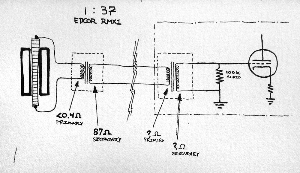

About how to connect the transformer. Yes you can use the transformer as a load but it requires math and a complete redesign. That WOULD be the best way to go. But for now tacking on a 1:1 using a capastor to block any DC current will let you experiment.

Jensen http://www.jensen-transformers.com/as/as021.pdf shows exactly what I meant by a option "one". Another option would be connecting OT's primary to anode of lower tube in mu-follower and to cathode resistor of upper tube, instead of anode resistor.
I've simulated both in LTSpice, it shows better results for primary as a load. Also, it can be possible to remove capacitor from there making this DC coupled, if a transformer allows DC. The cap can create resonance with inductance of primary.
What will be sonically better, I do not know. I think it totally depends on OT. Unfortunately I cannot buy multiple OTs for testing, too expensive.
Thus any recommendations on OTs are welcome.
Zout is 88 Ohm, mu-follower. Zin is 10KOhm balanced.
On Lundahl site I've found many different transformers. Same on Jensen site, but there not many can be balanced. Did not check Sowter others yet.
I've added cheap $5 600x600 Mouser transformer as AC coupled load. It shows excellent noise elimination, that buzz disappeared. JNoisemeter shows SNR 83dB (unfiltered, RMS)
The only residue of buzz is left that is picked up by umbilical cable. Probably it needs to be shielded, or/and twisted better. Currently I use 5 wire electrical cable from Lowes. May be I need to make DIY one, shielded.
So, I'll go with an output transformer, do not know which one.

here I've illustrated what I want to do (and how it is currently done with the cheap OT). Please note that ground of the Preamp is different than ground of Sound card, they are disconnected. However they are most likely connected via house mains earth. But they are not connected by signal cable, the output TRS connector's sleeve is not connected to preamp's chassis, so the earth loop is not created.

Currently I am considering to use an output transformer at preamp output.
But reading article "Jensen AN-003 INTERCONNECTION OF BALANCED AND UNBALANCED EQUIPMENT" http://www.jensen-transformers.com/an/an003.pdf
I found following:
There is a part 2.2 - "BETTER" uses an Output Transformer to Improve Balance
and part 2.3 - "BEST" uses an Input Transformer to "Fix" the Input Stage
Difference I see is OT at output side of cable, or IT at input side of cable.
Why the second is better?

It's complicated, but it is partly because the OT they use in that example is really an input transformer and it does not work too well as an OT. If you use a 600:600 OT then its performance will be fine.

You would have to re-build the E-MU 1212. Simply placing a transformer between the preamp and the audio interface does not change the audio interface it would still have a differential amplifier inside that is made of op-amps.
They also say that a rebuilt will be more efficient, but placing IT right in front of input also works. The input transformer isolates cable capacitance and possible cable imperfectness, that can cause unbalance, from an input stage.

The Jensen JT-11-ELCF IS a 600:600 transformer. You are right it is an output transformer. It is confusing because the JT-11-ELCF is a 600:600 output transformer and the JT-11P-1 is a 10k:10k input transformer. I mistakenly thought they were using the SAME transformer in both examples when in fact they were quite different. Sorry to have added to the confusion.
The bottom line is Jensen is right. If there is just a single transformer, it is best at the input end of an unbalanced connection. The ideal situation of course is a transformer at each end.

Yes, impedance balanced output and an input transformer should work well and be relatively cheap. I think a lot of this is academic. The main thing for your original hum problem is to break the signal ground connection between the mic pre and the PC.

I've simulated the OT, IT with and without Output Impedance Matched Passive Network in LTSpice.
Cable is 6-ft, R 25mO/f, C 50pF/f.
Noises: sinusoidal signals 60,120 and 180Hz, 1V, common mode to both wires.
OIMPN -> 6ft cable -> IT
It shows up to 40dB lower buzz comparing to simple unbalanced output. It shows just little spikes of buzz a little bit above -140dB.
The result is very very close to results for OT -> 6ft cable -> IT.
However with OT it does not have any little spike of buzz at all.
OT -> 6ft cable -> bal load R10k - gives random noise floor around -120dB
So, the best result was, of course, OT-to-IT coupling. Very close to it, but 2 times cheaper - OIMPN to IT.
It is interesting, direct connection with floating pin 1 on output side shows very clean result - full common noise rejection (however in real life this allows some buzz).
Same results with direct connection from OIMP with grounded pin 1.
