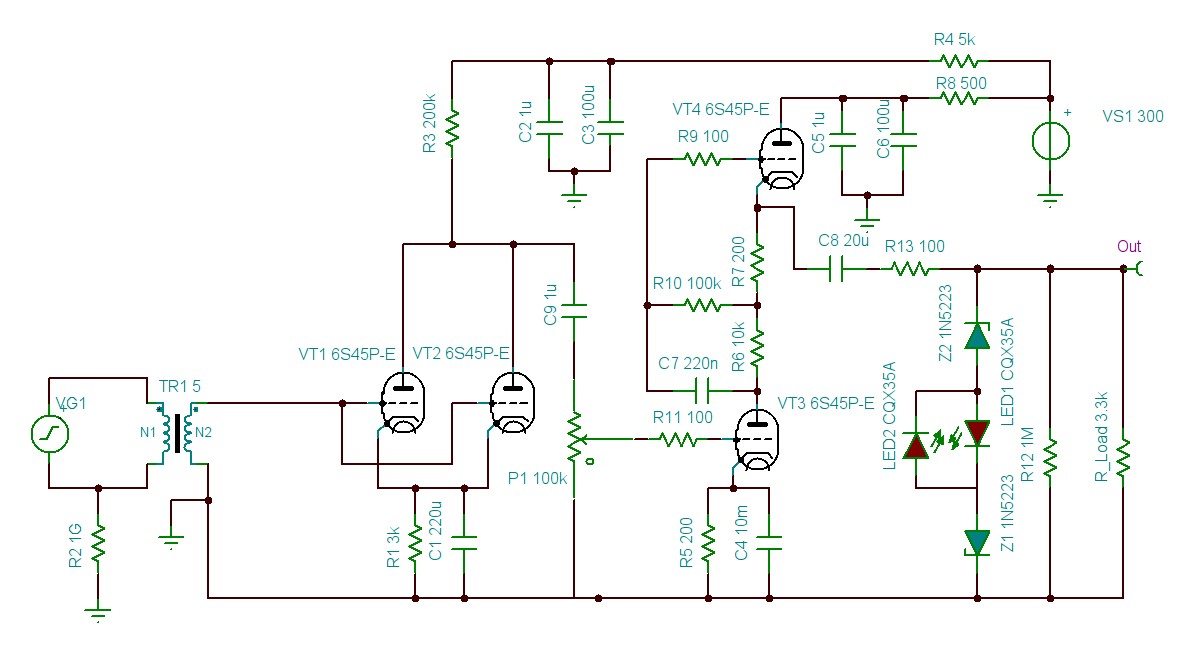

LTSpice simulation for cascode shows poor noise and freq response rolloff above 10kHz.
How to protect input of line amp from an excessive signal?
Measured V~ on output (with 4.6k load) during buzz when input tube grid touched . V was up to 140V~ ! Wow. That is brutal. It is good that mixer preamp has a protection.
I've added two 2.7V Zeners back-to-back across output, and 100R ballast resistor. Voltage was not higher than ~3V when I rubbed mic.
I do not hear any impact on normal sound.
Added two bright (4500mCd) red LEDs in between Zenners, that indicates overload. Cannot measure impact of the protection on sound because do not have good sound card. But I do not hear any audible impact for signals of normal level. And high level is distorted anyway.
Here is my current schematic.

New addition to overflow protection - magic eye indicator.
I've added this 6E2ÏÔʾÇý¶¯°å
indicator to output. It serves dual purpose: helps to set proper signal level, and this tube looks really magic . I was going to add a line of LEDs, but then decided to make it all tubes. At least how it looks externally.
I hope, 9014 across output signal path will not spoil sound too much.
Or should I make it switchable?

In attempts to improve noise level, I've measured the preamp's "sound" when it is totally un-powered (by switches) and still plugged into wall mains outlet.
There is some buzz (60Hz *N) that comes most likely from Earth loop.
I've described the issue here http://www.diyaudio.com/forums/power-supplies/257066-weird-buzz-when-psu-turned-off.html
But still do not have any solution. Could you please take a look.
I tried to completely disconnect Audio Ground (AG) and chassis - it creates too much noises and radio.
I tried to put R 20 Ohm between chassis and AG - buzz is same as directly connected.
Any other ideas?
Chassis is alum box, and it MUST be earthed.

About the only way to completely isolate the ground from the signal is to use an audio output transformer.
Thank you Chris. Any recommendations?
Zout is 88 Ohm (simulated value)
Zin is 10K
It is entirely possible you get some hum when the mic pre is NOT powered. The tubes are open circuit so your output looks like a 1Meg resistor in parallel with some back to back diodes. It is not surprising this might pick up some hum.
To minimise hum in your build I recommend you read this:
http://www.ianbell.ukfsn.org/EzTubeMixer/docs/EzTubeMixer/SimpleMixer/grounding101v2.pdf
Cheers
Ian

I'll try first with cheap 1:1 (600R:600R) transformer I have, I know it will cut off LF and HF, but it should remove buzz. If it works I'll buy a good transformer.
Earth buzz is still puzzling me. I suspect that Earth of my computer, that is connected via UPS, is somehow different (has buzzing potential) with Earth of preamp, and if I connect both, it will still introduce buzz even with output transformer. I doubt that E-MU 1212 has input transformers, I assume it has AG connected with Earth.
Are my suspicions correct?
Should I break that loop by connecting screen of output TRS cable only on one side?
Like detaching Pin 1 from Earth on output preamp TRS?
Also somewhere I read that nothing else should be attached to Earth chassis bolt.
Ian proposes to make it the Audio Ground as well. Will it be legal?
From other sources also is advised to make the Audio Ground at input, because it is most sensitive place, any hum here will be then amplified. I've made this way, but still have some buzz. Could you comment?

What is better, to place primary in between bottom and top tube, instead of resistor,
or to make parafeed, placing it simply on output and ground?
I know the latter may be done with a toroidal as well.
Just ac couple the output to the transformer. I don't know why people use confusing terms like parafeed when they mean ac coupling.
