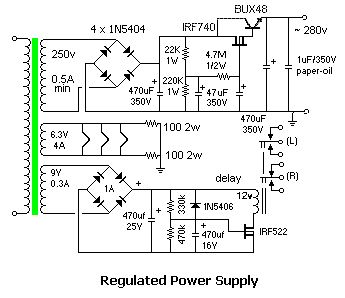

Regarding power I suggest you to use a solid state regulator circuit with a very low output impedance to kill the residual noise comes from rectification (region around 50-60 to 400 Hz).
I found this schematic
Walter
