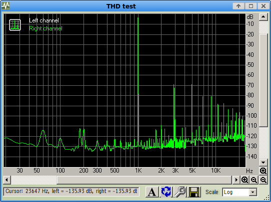

I've added snubbers to rectifier bridge - 0.1mF serial with 100R for each shoulder of the bridge. However it looks like it does not help. Even worse. I see some 60Hz harmonics where they were not seen before.
Please take a look at charts. It is noise from 150R pluggend into input XLR.
I am puzzled why there is the buzz. It is clear that this buzz (quite little, but still) comes from HT, because when I turn off mains transformer there is no buzz.
Also there is less buzz when bottom part of aluminum box is removed. I think that mains transformer induces some currents in the box when it is closed, so loop through the box is established. Last three pictures are noise with box open, no bottom part. V in file name is volume (clicks) on volume attenuator, 22 clicks - is full volume.
The fact that the whole noise spectrum, including the hum goes up and down with the gain implies the hum is entering the first stage. To make sure it is not getting into the XLR socket itself, repeat the tests with the input short circuited.

I've got snapshots of 150R up to 100Hz and up to 500Hz with higher resolution.The fact that the whole noise spectrum, including the hum goes up and down with the gain implies the hum is entering the first stage. To make sure it is not getting into the XLR socket itself, repeat the tests with the input short circuited.
Same with input short circuited. Pic 3 and 4.
Thanks for the extra hi res plots. These seem to show 60Hz and 180Hz as the first two peaks. The 60Hz implies this is not an HT problem but rather a transformer coupling problem which would also go away when the mains is turned off.

Ian thank you for looking into all of this and helpful advises.Thanks for the extra hi res plots. These seem to show 60Hz and 180Hz as the first two peaks. The 60Hz implies this is not an HT problem but rather a transformer coupling problem which would also go away when the mains is turned off.
Yes, when I disconnect mains, the preamp runs on power accumulated in reservoir caps, there is no buzz. I tried to put thick soft steel ring over the mains transformer (toroidal one), hoping that it will gather magnetic field into it. It does not help.
So I do not know. Snubbers do not help, shielding does not, iron ring does not. I think the only option is left - to separate PSU from preamp.
