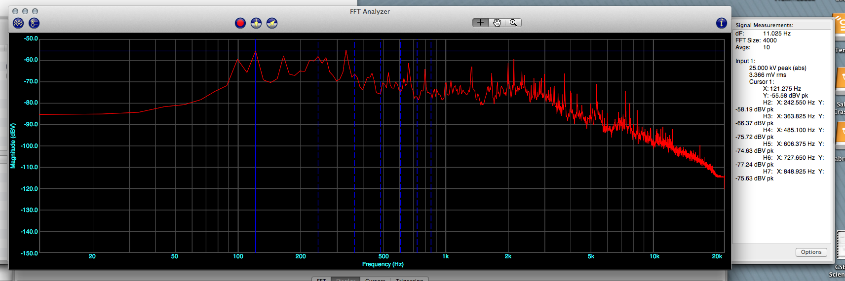

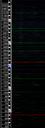

I've analyzed buzz fragment of the file - 60Hz and its harmonics are sticking out significantly. Especially 60 and 300Hz.
Is it really right at 60Hz? Look more like close to 60Hz to me.
One other thing is that rectified 60Hz is 120Hz. So if there is not enough filtering you get 120 not 60. The diodes have the effect of a frequency doubler.
Still sounds like environmental noise to me, coming from outside your amp. We will see if the screen shot of my spectrum is attached properly. If it is then yes there is something near 120Hz. The blue cursoe is on it ad its harmonic but there is loads of other "trash" on the screen to. If if this is mains AC leaking in it might NOT be from your power supply.
Yes it is. It may look a little bit off on the chart because of log scale and FFT is a little bit rough on 60Hz. But it is 60Hz and its harmonics - 120, 300 etc ...

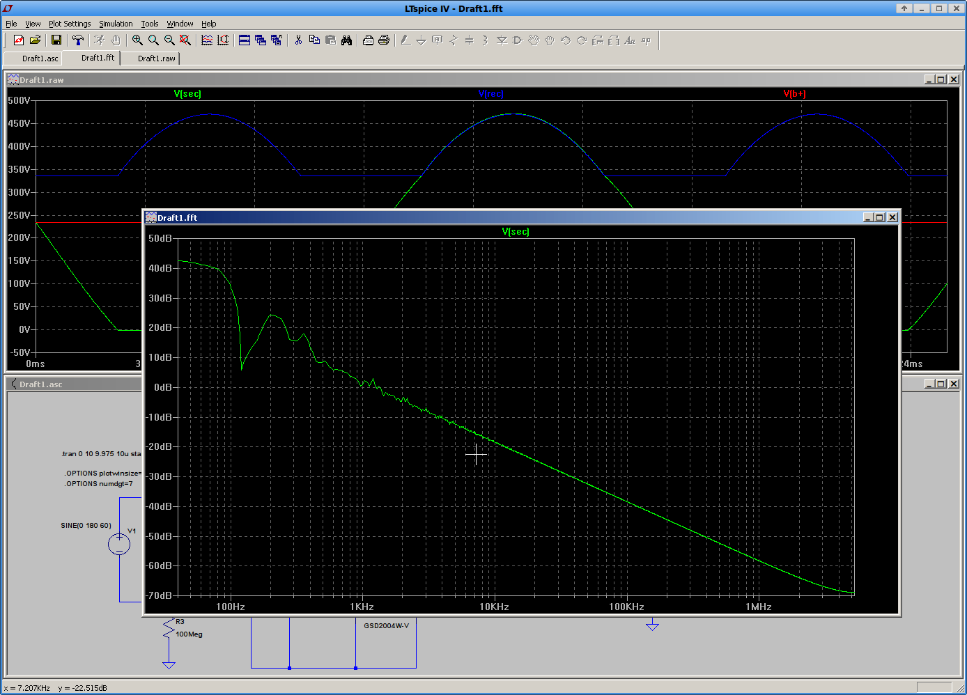

I read about ringing in PSU, and how to fight it using snubbers.
Thinking to put snubbers on bridges.
Why RC snubber should be put across each diode in bridge?
Will be just one on AC side and one on DC side enough? Let say 50nF and 50R each?
Snubber removes ringing, but signal shape on secondary is still has sharp square angles. This causes FFT with harmonics.

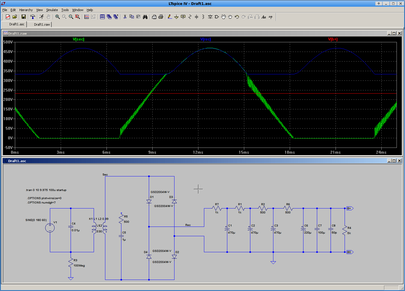

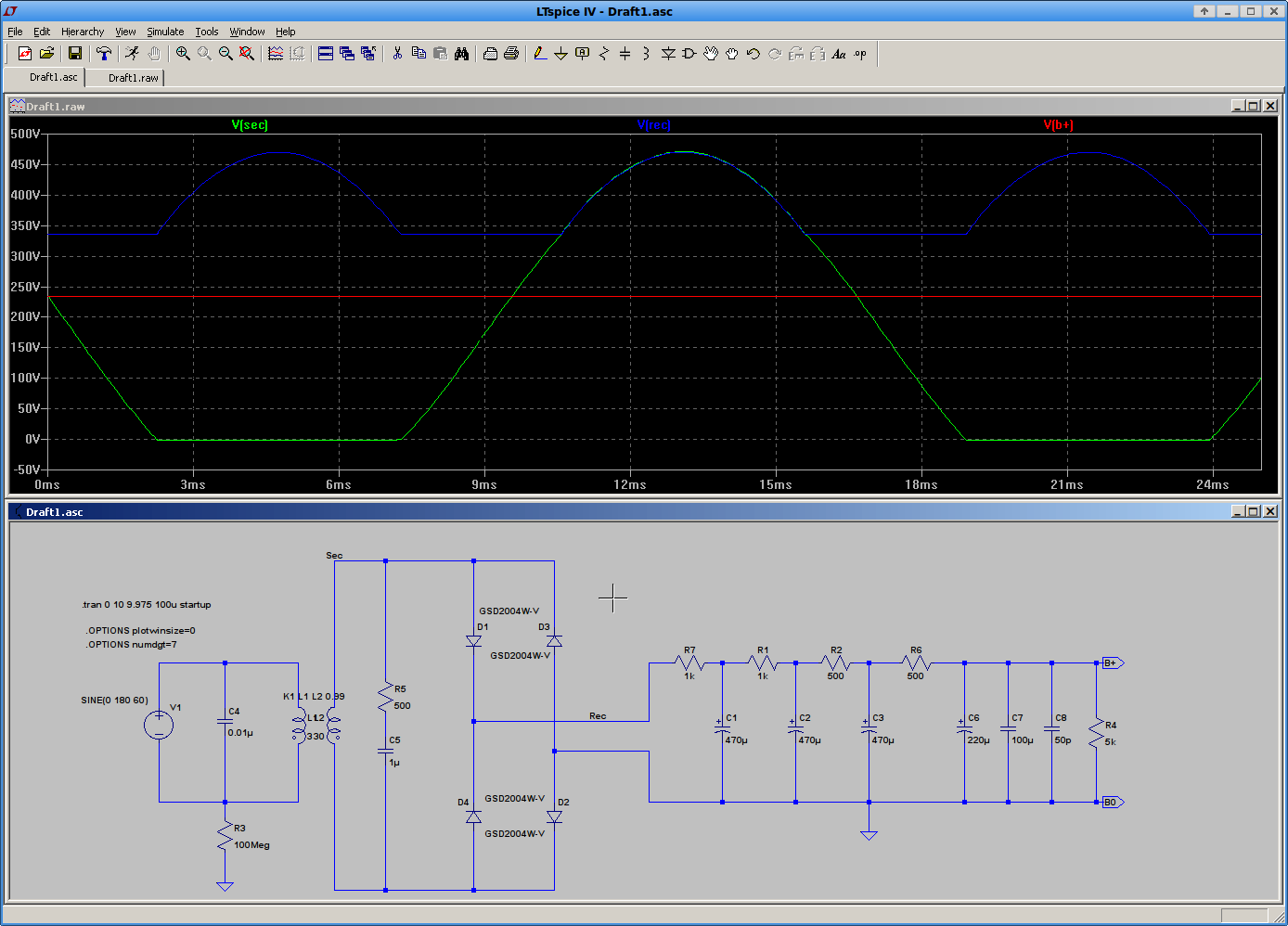

Here are pictures of simulations with and without snubber.
What signal shape should be achieved on secondary?:
a) Without ringing;
b) Without ringing and smooth, without sharp edges;
c) close to sinusoidal, with some harmonics;
d) ideally sinusoidal.
"Signal" here is mains 60Hz.
Why the snubber did not help in my case? preamp still buzzes same way.
I think I know. With snubber C 0.1uF supression of ringing is insufficient.
I had to increase it to 1-5uF in simulation.
In reality I've got caps to make it 3uF and tried. My 500R 0.5W smoked after couple of seconds. I had to stop it.
In model simulation current through the snubber R shows amplitude -0.350mA - +0.350mA AC. That is 0.7A AC or about 0.5A DC. From equasion P=R*I^2, power of a resistor has to be 123W (!).
With C 1uF power of R needs to be 23W.
The more C is the closer voltage and current on secondary to sinusoid. But price for it - a higher current on R.
Still have a question. Will it only suppressing of ringing oscillations be sufficient, or sharp edges on signal shape should also be smoothed, or even further, signal shape should be sinusoidal? What shape is more important - voltage or current?

I think you need a better transformer model. You are using an ideal transformer. As a first cut place a resister equal to the DRC of the secondary in series with the secondary. You might try to put 1/2 the DCR on each side but I doubt that will matter.
This more accurate model I think will give better results.
Next you add leakage inductance to the model but you'd have to measure you transformer to know what that is.
One cheap way to remove those switching spikes is to place a small cap in parallel with each diode about 10nF is right.
Also you will notice how adding the transformer DRC into the spice model helps. You can add resisters to the real circuit too. See "Rlim1" and Rlim2" on the fourth example on this page

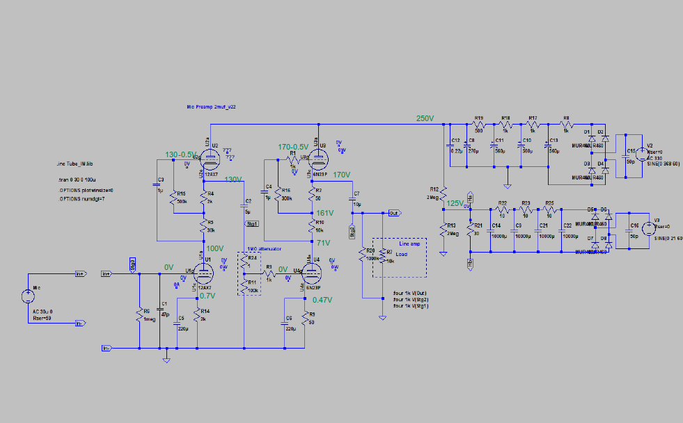

Chris, thanks for advises. It looks like I've found the cause of buzz.
Yesterday I just randomly placed 0.1u cap across top resistor of heater elevator voltage divider. Buzz decreased by 30-40dB! It become less than -80dB but still audible.
Today I started searching/reading about elevators and found that quite a big cap (20-100uF) should be placed across a bottom resistor.
Look pic 3 at http://forum.metroamp.com/download/file.php?id=5062.
Also I use 2MR resistors in divider to reduce a current. It looks it too high. I'll try with two 100kR and some cap across the bottom one.
Though I still do not understand how it works. My heater supply is DC, not regulated but very well filtered with three RC of 10000uF caps. How buzz appears?
Does it come from a ripple of heater supply into H+? or vice versa?
Or because heater circuit is floating, connected to ground only via the bottom R of elevator, it picks up RF/EMI and passess it somehow emitting/consuming electrons to cathode?
I suspect the any noise transfore from heater circuit to signal path was happening otside of the tubes because you hade the heater elevated well abouve ground. I'd guess the transfer was very close to the tube socket where the wires are just millimeters apart

Your cap on the voltage divider provides a short circuit for AC voltage to ground.
As you work off the remaining noise you might even find out why most people who use DC heaters also use a regulator. Those regulators are great for suppressing transients and ripple. The LM317 regulator is also smaller and cheaper than a big filter cap
There is another small effect: Do you have a 'scope? Look at the heater secondary AC waveform. Usually it is not a perfect sine wave. That is because the current in the primary is not constant and that is because the current on the B+ secondary is anything but constant. It is zero when diodes don't conduct and much higher when they do. Some of this gets reflected on the 6.3V secondary. This effect is much larger on power amps then a preamp

I don't think the buzz was the result of elevation but of there being no good AC path to ground.
We also don't know yet how those switching spike were being coupled to the DC heater supply. My guess after looking at the assembly photos is that this is a very "tight" layout with components and their leads all placed close together.
Remember that if you want a wire to pick up stay signals from it's environment the best way to make that happen is to give it a high impedance from ground and use lots of wire. A heater circuit tied to ground only with a 1M resistor is the very definition of that. Adding that cap gave it a nearly zero impedance to ground.

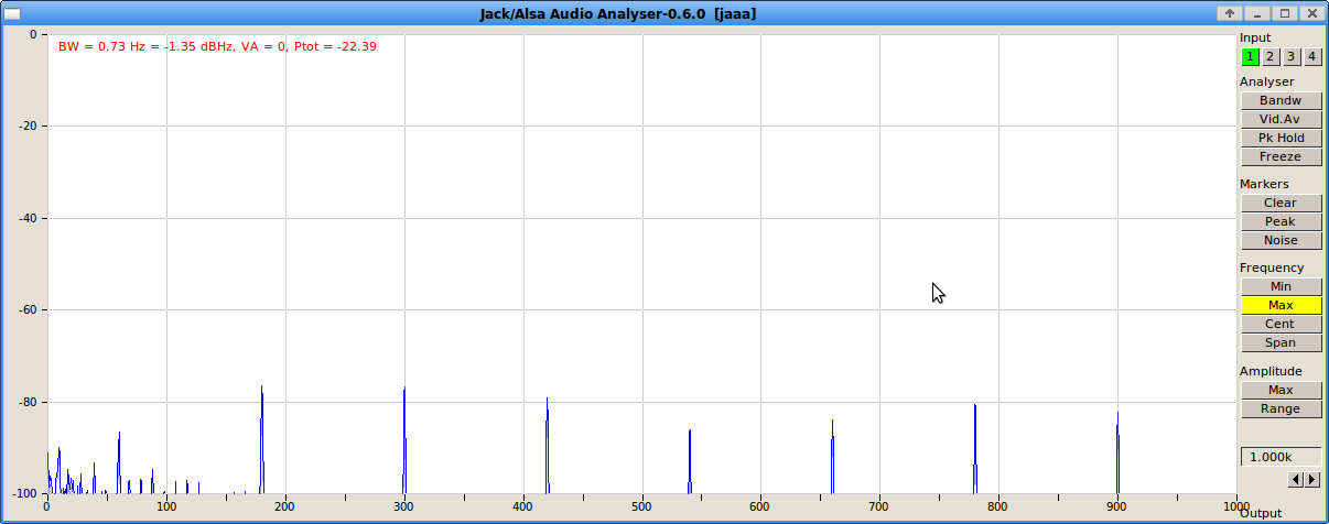

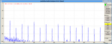

I've changed elevator resistors to 100K and bypassed the bottom one with C 220uF.
Buzz reduced dramatically.
But there is still some dry buzz made of 180Hz and higher harmonics of 60Hz.
Here is pic taken with volume at 75%.
PS/ When I turn off power, the preamp still works on reservoire caps energy for couple of seconds. No buzz just some hiss.
