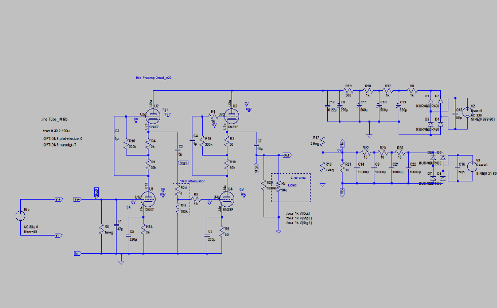

Ribbon Microphone Preamp

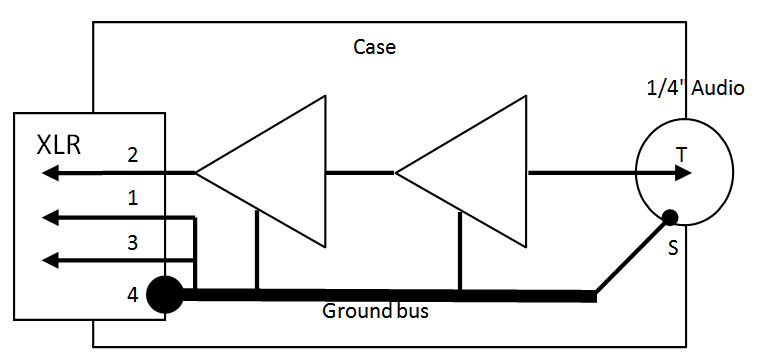

#1 XLR Pin-4 is XLR ground, shown as rectangle here Sound System Interconnection on Figure 1b. So it can be soldered with pin-1?
Pin-2 is hot signal. However Pin-3 directly goes to Signal Ground because the preamp is not balanced. The Star Point in my case is XLR Pin-4. So Pin-3 is soldered to it. Is it correct?
Currently, in schematic it looks like on the picture attached. Triangles are tube cascades.
Another thing, mains earth is bolted far away from XLR where Start Point is.
mains earth is bolted on back surface nearby power cord plug.

Ian thanks.
But in this article you described grounding of a balanced preamp with input and output transformers.
Mine has no transformers. I removed the input transformer because mic signal is strong enough.
What to do in case of unbalanced preamp without transformers?
Is it really "the must" to have mains earth as a star point?
I read somewhere that star point should be as close to input connector as possible. So I decided to place it on XLR ground pin. Automatically it happens that shortest way for pin-1 and V0 (pin-3) is just to solder them all together to the ground pin. Is this way wrong?

If that is what you built then it is working about like I'd expect it so. Such a design has zero common mode rejections and will amplify any and all hum it picks up.
On top of this you have a ground loop too. The ground bus and chassis seem to be wired in parallel. There should be at most ONE connection from signal to chassis ground. Some argue for zero, some for one. But two is always the wrong answer.
You need a balanced or differential input. What your amp needs to amplify is the difference BETWEEN pins 2 and 3 not the level of on of them above ground.
Also, importantly, what is the input impedance of this amplifier? I'm betting is is very high. The also is an invitation to hum.
You are best off getting an input transformer. There is a reason "everyone" uses them.

I do not understand what is wrong if 3 is on the ground. There will be still same difference between 2 and 3.
Isolation of the ground is a minor thing compared to this. At present you have other problems that mask this small effect.
To understand why you don't ground pin 2 or 3, first think about WHY people use balanced signals. Let's say your microphone and the microphone cable are inside an electric field. They are, you can't escape it because the power grid is "everywhere". Then BOTH the pin 2 and pin 3 will raise and lower their voltage. They act like one plate of a capacitor. Their voltage moves up and down together. We call this "common mode" noise because it is common to both conductors.
Let n = noise picked up from the environment and s be the audio signal.
In a truely balanced system, if you measure the difference between the two wires you do not see this 60Hz (or 50Hz) noise. Pin two has n+s/2 and pin three has n-s/2 do the difference is s.
Now in your design you have fixed one pin at zero volts. The other pin has n+s on it. The difference is n+s.
OK what the above ignores is that the microphone has about 200 ohms of impedance and all the wires have some resistance. So grounding the pin 3 has the effect of pulling pin 2 to ground through the the mic's internal resistance. Let others comment if I am right but I think this has the effect of tossing out away half the signal.
Next problem is the input impedance of the amplifier? This the "load" the microphone sees. You modle it as if the mic was an AC generator and the amp a resistor. If it is high like the grid on a tube then the load on the mic then there is very little load on the mic and the voltage to current ratio is high. I cable running into such an amp acts like an antenna.
An input transformer words because it makes absolutely sure the two input pins 2 and 3 have identical current and voltage. The transformer can not pass any common mode noise. it is a near perfect blocker (except for inter winding capacitance.) Not only does it block common mode noise it provides near noiseless voltage gain (8 to 10 x) and importantly it matches the low mic impedance to the high tube impedance.
So your amp is amplifying all the noise and half the signal while a transformer based based amp sends 16 times the signal and almost none of the noise to the first tube.
Electric guitar players are used the kind of amp you have and just put up with the noise, they play loud enough to cover it up.

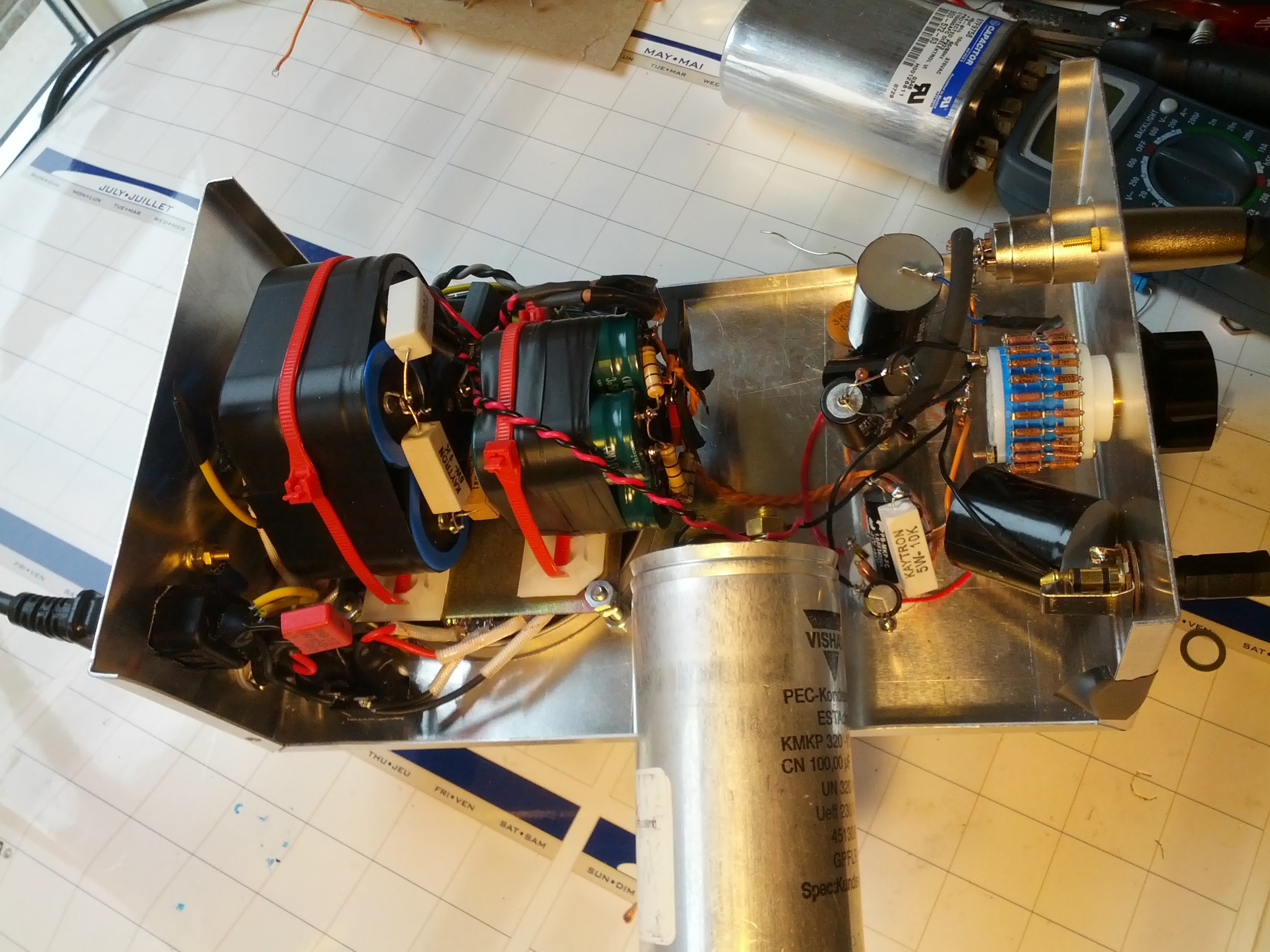

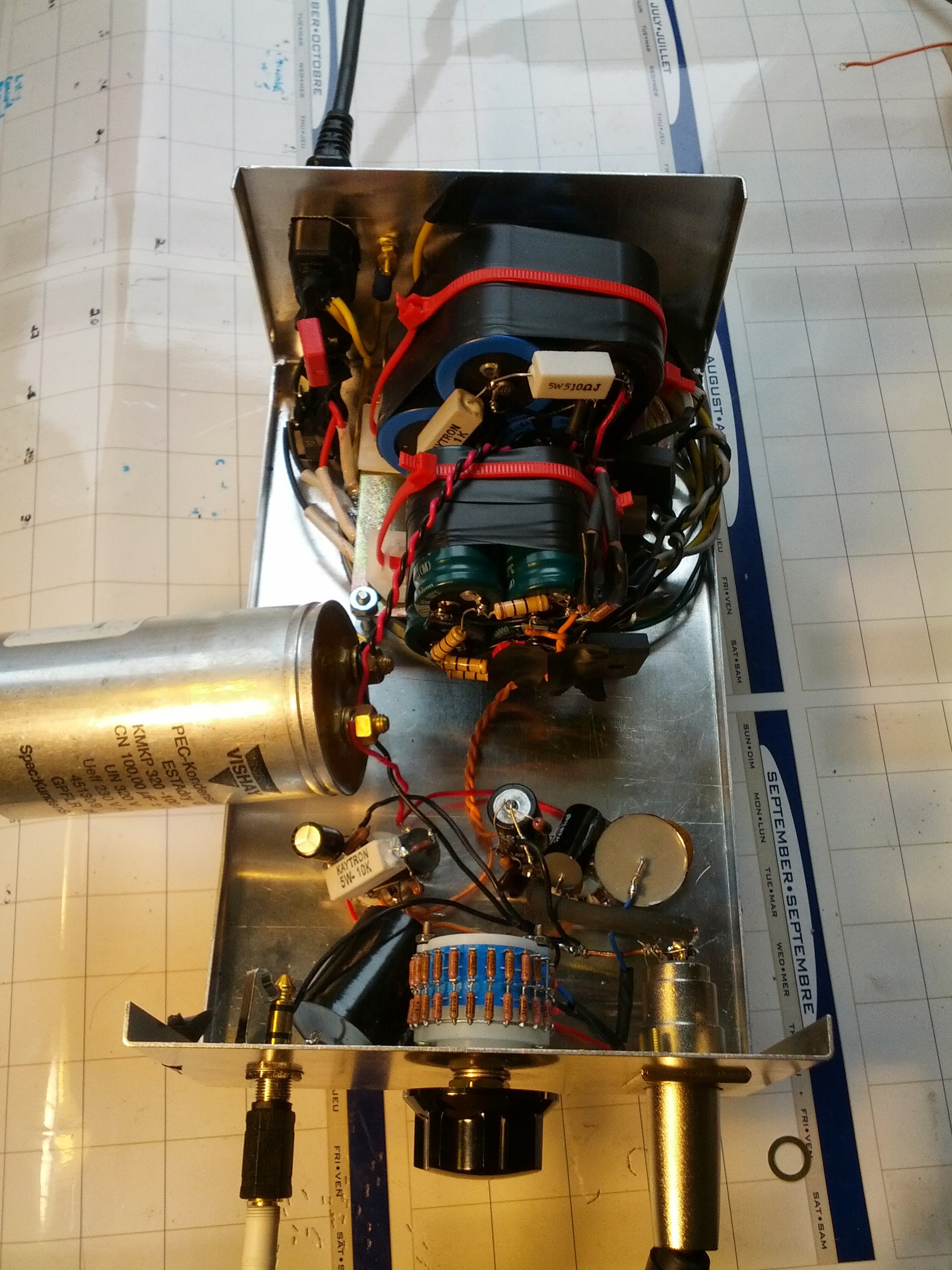

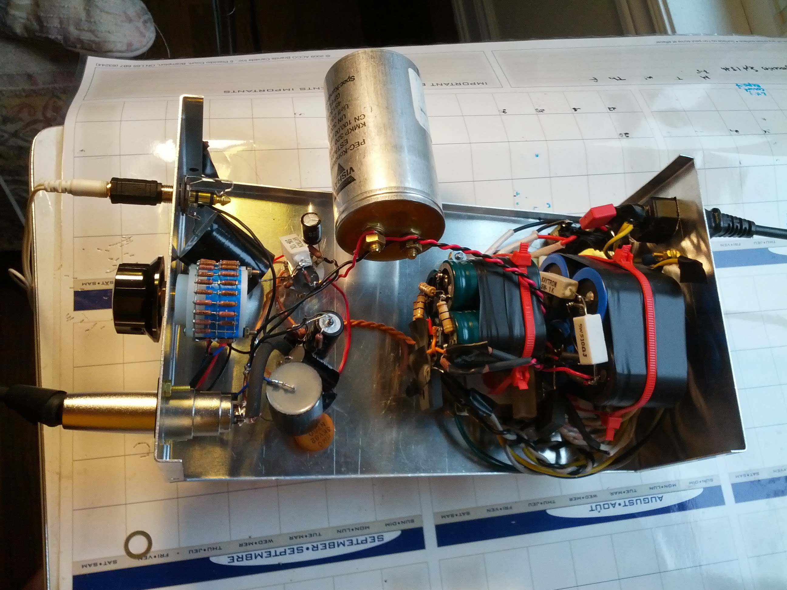

here are pics. Big Vishay motor run cap is sticking out temporarily to improve visibility for pics.
Above you argued that copper can act as a magnetic shield. Read this to get the correct answer Electromagnetic shielding - Wikipedia, the free encyclopedia
One way to improve power supply hum is to remove the power supply to a separate chassis and use a cable. The transformer and all the AC wire is 3 feet away from the amplifier. You have to think about safety when you make a high voltage cable. What if your cat or a small child tugs on the cable?
You also need some filtering in the amp chassis to remove whatever the cable picked up from the environment.
