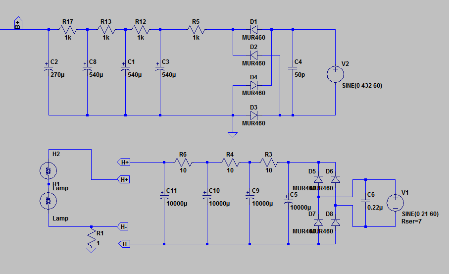

I've made a pre-build on a cardboard sheet. It works even without an input transformer - I can hear all sounds from my ribbon mic in earphones plugged into output.
Though it buzzes because there is no RF shielding currently, I believe it will not buzz after final build in an aluminum project box.
Also, I use a simple RC (four caps, 150,270,270,150uF, with three 1KR between them) filter power supply, with DC heaters. Not regulated.
Simulations show no ripple.
I hope all the buzz is from RF over air, not from DC over chains.

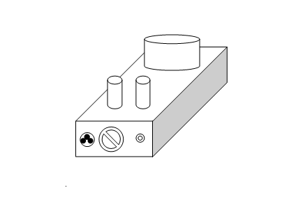

I've put everything into aluminum box. (second picture)
The problem.
Still having some buzz.
Mains toroid transformer is placed on top of the box with its base bolted underneath top surface for a cosmetic beautification. Steel cup is placed on the toroid itself. For shielding and cosmetic both.
RC filter caps are attached to the transformer base underneath.
I use simple RC filters, not regulated, PSU. B+ has four 540uF noname electrolytes and one 270uF Nichicon electrolyte cap at the end. I believe that this Nichicon is faster. I am thinking also to bypass it with ~100uF PP film motor cap.
Heater's filter has four 100,000uF electrolyte caps. It creates no ripple according to simulations. Heaters of both envelops are in serial, while inside envelopes they are paralleled. In total it it needs 12V, but actually after RC filter there is 9.8V DC, which is OK, I think.
Tubes stick out on top front in ~4 inches from mains transformer cap. Tubes are in aluminum shielding caps. (see picture)
Inside box I've separated PSU area from amp area by an aluminum compartment separator made of a beer can.
B+ wires are twisted, and heater wires are twisted too, on the way from PSU to amp.
Input female XLR is bolted to aluminum box without isolation. Pins 1,3,4 are connected together. 2" chunk of thick copper wire is soldered to XLR pin-4 and serves as circuit ground bus. Ground wires for amp cascades and PSU are soldered to this bus. Mains Earth is bolted to the case nearby power plug.
Output 1/4" unbalanced audio plug female is bolted to the case without insulation. Here I think is a problem. It should be isolated from case, should it?
Otherwise it creates loop.
Currently I am reading Grounding and Shielding Audio Devices.
Good reading, but there on fig. 4, circuit ground is connected to chassis ground nearby PSU.
So my questions are:
1 - should the input XLR pins 1,3,4 be soldered together? If not - how?
2 - should the output unbalanced 1/4" jack attached to chassis or be isolated?
3 - should the signal ground connect to chassis ground, where? directly or via some circuit? What could be that circuit?
4 - when I bring mic closer to transformer buzz increases. Is thin steel cup enough? Should I consider thicker steel?
5 - Should I consider thicker aluminum or steel for the compartment separator?

#1, On he input XLR, pin 1 is ground, conect that to the chassis as close to the input jack as you can. It is simply a sheild that does not cary any audio What is pin 4? You must mean the shell. Yes conect that to the same place as pin one.
But the SIGNAL pins 2 and 3 are NEVER grounded. NEVER ground the signal pins.
#2. Keep it isolated. Attaching it to the chassis provides two paths for the ground current. You want only one.
Trying to shield using metal chassis parts is not going to help if yo have grounded pin 2 or 3
Check this out:
http://www.ianbell.ukfsn.org/EzTubeMixer/docs/EzTubeMixer/SimpleMixer/grounding101v2.pdf
Cheers
Ian
Cheers
Ian
