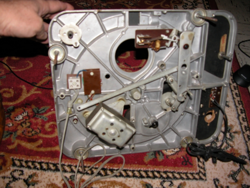

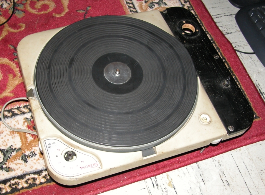

The Ersatz TD124
A couple of posts back I mentioned a turntable that appeared to be a TD-124 with a bunch of TD-121 parts on it - which is exactly what it turned out to be..
The original top and bottom platter, spindle and main bearing have been removed along with the strobe and a lot of mechanical components. Someone then installed a TD-121 platter and bearing on this chassis. Other parts may have been used to fix another TD-124. Very difficult to know.
I theorize that the strobe and platter assembly might have been used to upgrade a TD-121 due to the presence of that platter.
Some parts will be used on my TD-124 and the rest will be saved for future repairs to other tables. Unfortunately there are just too many hard to source parts missing from this one to make it a viable restoration candidate, what is there is not in bad condition indicating that this probably was a usable table prior to be cannibalized. A shame really..
