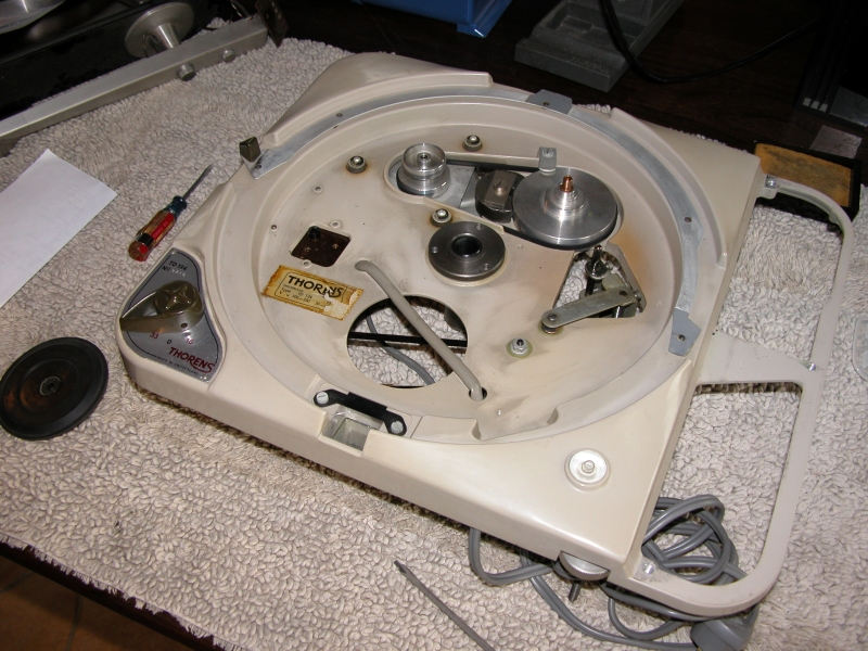

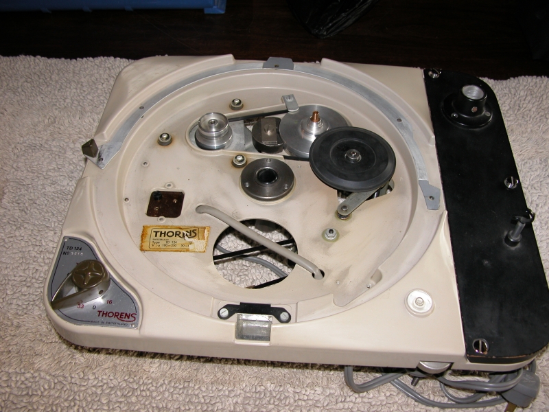

MKI Service
Today I worked on two MKI both built in 1959, one in the 9xxx serial number range, and the other in the 12xxx range.
It was an interesting experience. Here is what I learned today...

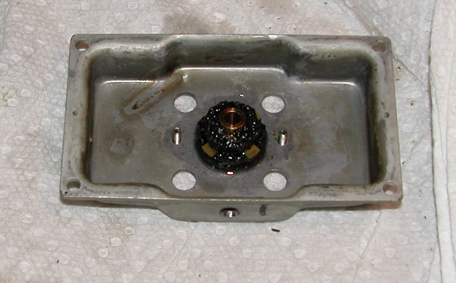

  • Both of these tables had the plastic bearings, I don't trust either - one seemed ok, although it had been run dry and scoring was evident on the spindle on the lower bushing, the other was definitely on its way out. (A lot of drag, probably due a distorted bushing.) These will be replaced.
  • The motors in early MKI have no provisions for oiling the lower bearing so we drilled holes in the lower housings of both motors for this purpose.
  • One of the two motors have lubricant that had turned to jelly in an effort to make it run on speed the brake had been backed off.
  • The other motor showed evidence of having been lubed by squirting oil into the ventilation openings - I cleaned up that mess. Its lower bearing was also full of glop.
  • One of the tables was using the 50Hz pulley position with the brake magnetic set so close to the intermediate pulley that the magnetic had to be moved to remove the pulley for service.
  • The intermediate pulleys are totally different than the MKII pulley and are much better damped - they are somewhat heavier and run much quieter with the same belts used here. These run on a ball bearing in an inverted sintered bronze bearing mounted in the pulley. The MKII runs on a nylon thrust plate in a sintered bronze bearing in the chassis. For whatever reason the two MKI are substantially quieter with a given belt than the two MKII I am familiar with.
  • Both had the cast iron platter which is clearly a higher quality item than the zamac platter on my MKII, and is much deader.
Working on these tables leaves me with the strong impression that an early MKI with a new main bearing, and the MKII motor suspension upgrade kit may be slightly superior to the late MKII I own. The intermediate pulley in the MKII looks suspiciously similar to the one used in the TD-135 which is a very inexpensively constructed table compared to a TD-124 or even the TD-121..
Both tables when reassembled ran very quietly and came up to speed in less than 1 platter revolution.
More motor details in next post.

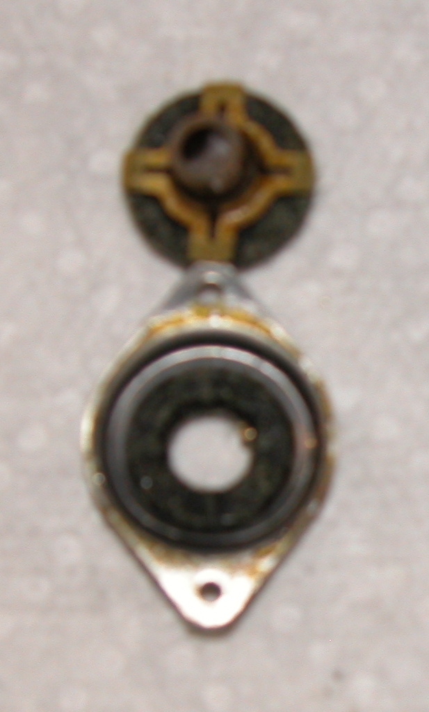

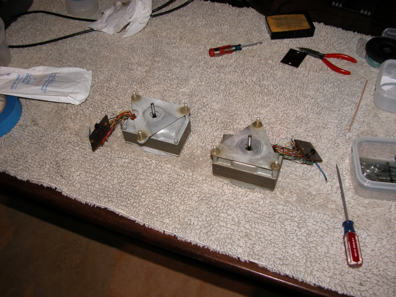

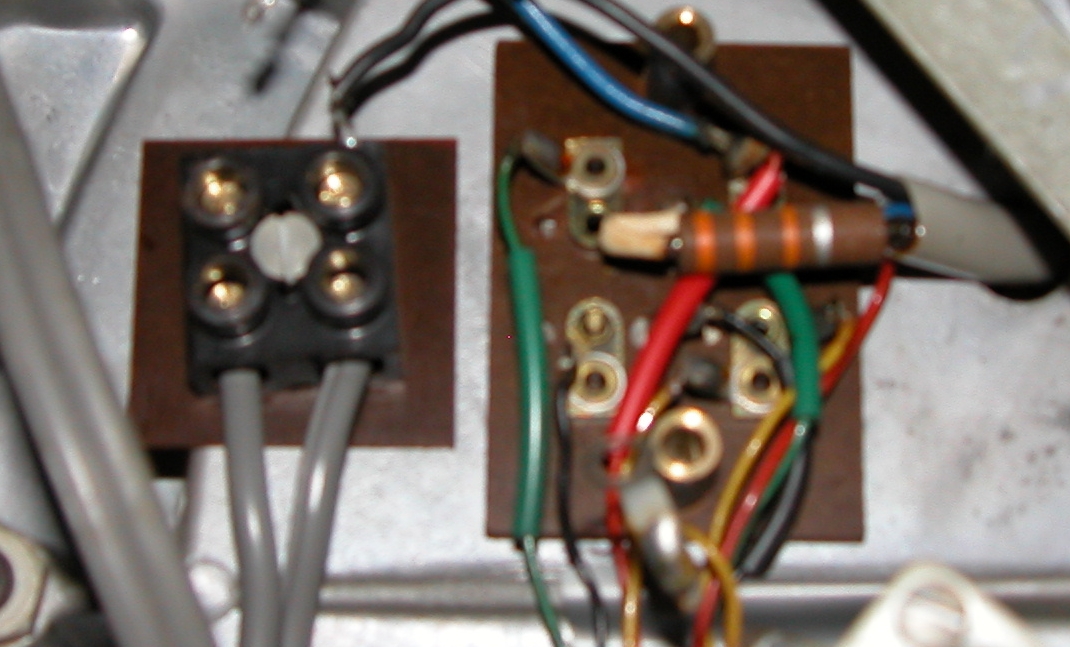

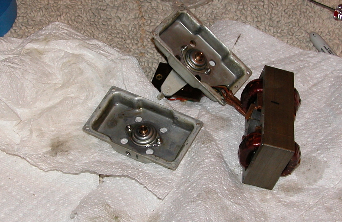

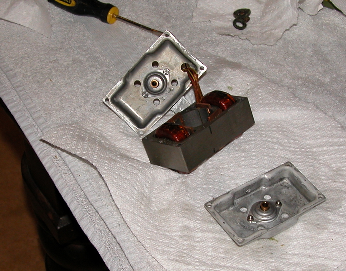

Removing the motors was somewhat easier on these MKI than on my MKII in that the wiring was tack soldered in place and there were only two connections that needed to be unsoldered from the voltage selector assembly.
I prefer leaving the wiring as intact as possible and remove the motor and selector together.. A little care is required with the cambric tubes and wire exiting the motor, but it is possible to separate the top plate sufficiently to drill out the brass rivets retaining the bearing assembly.
I made quite certain that all felts were thoroughly soaked in oil prior to installation - quite messy but this will hopefully avoid a repeat of my experience.
The quality of these bearings appears excellent and the motors run extremely quietly after a little work to align the bearings and determine the quietest configuration.
Two motors were rebuilt in all, one by me and one under my guidance. These tables still need at a minimum new motor bushings and main bearings..

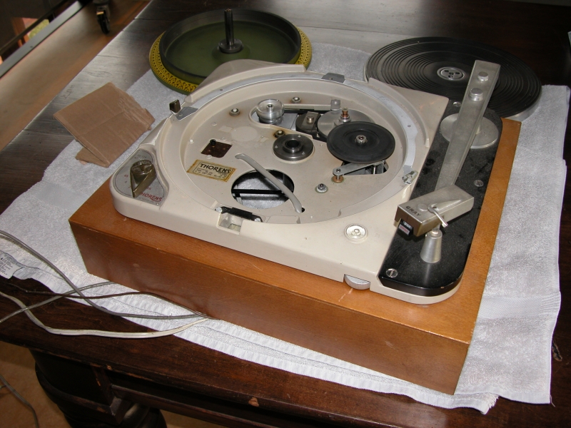

I'm listening to my TD-124 as I write this, very pleased with the sound - notwithstanding my MKI intermediate pulley envy.. :p:p

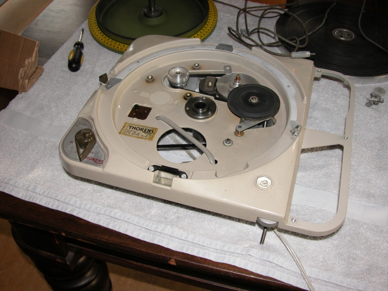

Above is a photo of the (mk 1) step pulley axle with bearing ball parked at its top. This being where it runs when the step pulley is assembled over the axle shaft. The bearing ball is 4mm diameter and has been upgraded to silicon ceramic. :cool:
Above: Prior to clean up......a detail shot of the casting detail that retains the step pulley axle. Two set screws. The MkII, and some of the later MK1 models do not use this casting detail.
Next photo shows the vertical alignment between idler tire and step pulley. This one needs some adjustment. Just as a side note the idler wheel in this photo is one from Mirko. It spins very concentric to its axis of rotation and offers the benefit of new bushings. However I did see some lateral run-out. Not so bad as to impede making a good vertical adjustment.
After the adjustment the idler tire ran cleanly within the width of the step pulley lands without touching a shoulder.
