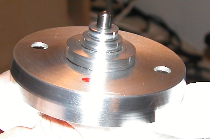

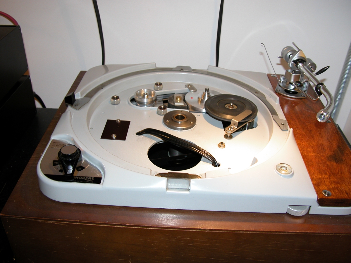

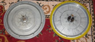

Some pictures, power quality, ramblings..
Thought I would share some more pictures showing my fitful progress.. :D
Today the table is running extremely quietly. Quite a contrast from last night, and I have unfortunately spent little time listening today because I have been very busy with job hunt related stuff.
The intermediate pulley is making little if any noise, there is some slight idler pulley singing on the platter, but very muted, and there is some motor noise - much less than last night which makes me suspect power quality which I know to be a problem outside of strictly line voltage.
The AC waveform here at times looks like what you would expect from a close to saturated pole pig.. :eek: Sort of a trapezoid with variable slopes, so some sort of power regeneration is probably advisable. I designed the rest of my electronics to be as immune as possible to these issues as I know how..
I have posted a picture of the turntable with the platter off, I think people may be surprised at how clean it is. As I indicated previously this is an extremely low hour unit that was "stored" in heated and conditioned space its entire life. You can see the results of my work and cleaning quite clearly in the pictures.
I spent some time over-zealously polishing the intermediate pulley with scotch-brite, this was probably a bit excessive and if you look carefully at the picture I posted you may see that. I did clean it before reinstalling it, but not before the picture. This in conjunction with the stretched and talc'd CB965 has finally resulted in a relatively quiet running intermediate pulley. I will probably spend some time with an emery cloth and polish it further, anything that reduces belt chatter.. The motor obviously cogs and I don't believe there is anything I can do about that as I mentioned in a previous post, but it is well isolated, and not transmitted to the chassis or platter.. What more could one ask for? Audibly quieter running overall would be nice, but I don't think I'm going to get there. The motor runs dead silent under no load, and when loaded makes some noise.. Bearing alignment is good, no further reduction in noise results from tweaking the bearing alignment.

Finally as promised I have posted a picture that clearly shows the difference between a zamac platter installed on the much earlier TD-121 and one installed on my very late TD-124. Note the small spindle - never thought a 10mm spindle would look puny, but next to that 14mm monster it is puny and then some. While not obvious the pitch of the bolt pattern is identical and these platters can be interchanged with just the swap of the spindle assemblies. The casting on my late TD-124 has clearly evolved and there are a number of differences between them. I am not sure whether the raised center of the TD-121 platter would interfere with the clutch mechanism and upper platter on a TD-124, but I'm not really curious enough to try this.. I have some thoughts of damping the inside of the platter where clearances permit.. Note that the late zamac platter has only a strobe pattern for 33 1/3 rpm at 50 and 60Hz.. I have seen erroneous references on line to 16 2/3 as well as 33 1/3 rpm strobe patterns on these platters, which is certainly not the case with the few I have seen.

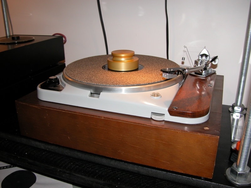

Merrill-Scillia E.D.M Mat, Sound, Noise..
The MSR EDM mat arrived this afternoon just as I was about to sit down to eat some lunch.. Naturally lunch was delayed while I unpacked and installed the mat.
This is a lead/composite (looks a bit like cork) mat and was modified by Merrill for use on the TD-124.. Weighs almost 1 1/2lbs which in conjunction with the record weight means I have added almost 2 1/2 lbs of mass to the platter, however given the fact that the cast platter weighs several more lbs than the zamac platter I am not concerned about the additional weight. It does make operating the clutch a little trickier due to the added weight on the upper platter.. I expect the dots will need more frequent replacement as well, and I leave it sitting on the clutch when shut off when I can remember to do so..
So you're probably wondering what it did to the sound... Given I have been listening only for a few hours my observations aren't comprehensive.
The "zing" I have mentioned in previous posts is completely absent as is most of the air that I really enjoyed - obviously an artifact of the mat itself.
The sound is tighter, and a bit more controlled. It might be just a little over damped for my tastes. Drier... It sounds more technically correct, and a bit less lively. Oddly this reminds me a lot of the SME 20 sound in fact. (Within the realms of faulty auditory memory, and bearing in mind my comments about fair comparisons to the SME.)
There is clearly more low level and HF detail evident, and the noise floor, never high to begin with seems subjectively even lower.
Imaging seems to have gained some additional precision, depth seems largely unchanged and is still a major improvement compared to turntables past.
Some particularly well recorded material does sound noticeably more natural, and warmer, more fluid.
Percussive sounds retain their impact, no softening apparent..
Overall this is a better compromise than the other mats I have tried, but it does alter the sound of this table, whether that is a radical change or not I have not quite figured it out.
After the initial shock, (it does sound different) and listening to a slowly widening range of material I feel that this a very significant overall improvement.
The additional mass seems to have solved my pitch control issues, as the loading on the main bearing is rather significantly increased. (Probably getting to be time for a silicon nitride ball bearing on the spindle..)
The table has remained relatively quiet as compared to a few days back.. I think I might be getting to the end of needing "desperate" tweaks. Power quality is an issue here, and I think I am going to look at a clean 60Hz sine source to power this table down the road.
