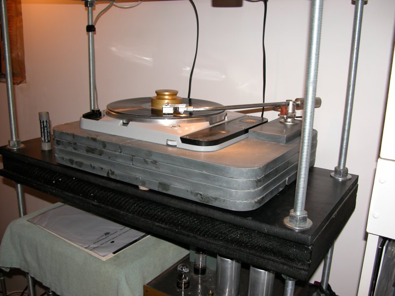

My new slate plinth will be arriving next week. Can't wait to set it up. My understanding is that a good plinth can be worth 15dB or more reduction in mechanical noise levels.
I hear also good noise reduction with the new plinth. The extra rubber-pads between the hard rubber-feet and plinth absorb energy and the new mushroom work also fine.
So I think when users are mounting their frame direct to the plinth some higher rumble frequencies will be amplified by that. It is not the right approach I think.
Absorption on a very sub low frequency is better.

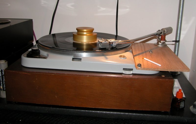

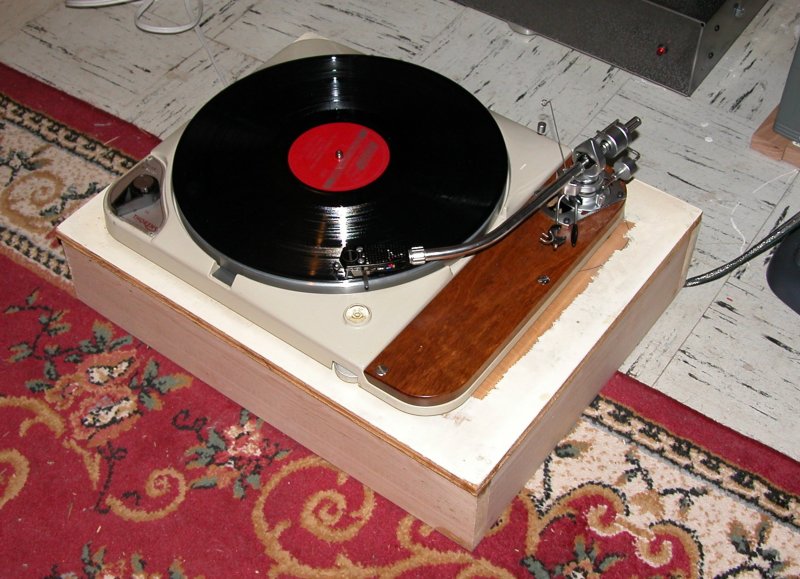

I've posted a couple of pictures of what I am tinkering with/listening to lately..
The first is my "Ersatz TD-124" this little machine was cannibalized at some point to upgrade a TD-121 which is what this machine has temporarily become. Currently it is fitted out as a TD-121 with a combination of the parts that were given to me with it and a few bits and pieces I've cobbled together. The SME 3009 Series II has an ancient Stanton 681 (with original stylus on it) installed and it actually sounds pretty good. Rumble and noise levels are acceptable although significantly higher than the TD-124/II.
The TD-124/II is currently equipped with a very wimpy temporary arm board with my new Schick on it. The head shell is an Orsonic and the cartridge is my trusty old ZU. The Schick is equipped with the heavier counter-weight. This combo performs at a whole other level compared to this table with the SME arm and ZU cartridge. My new slate plinth is on its way and should be here within a week or so.

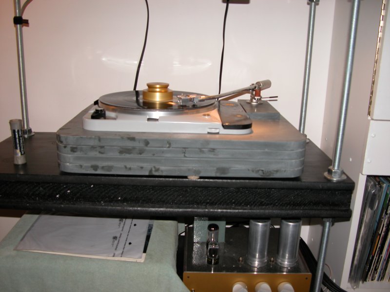

A few days ago my friend from Vietnam arrived home with the heartbreaking news that the airport security in Los Angeles had unpacked the plinth components and failed to repack them correctly - with the exception of the one piece that was in his suitcase the other pieces all got broken in a minimum of 4 places and in most cases about twice that many locations.
We spent most of the morning piecing the broken pieces back together with devcon epoxy - while not unscarred we were successful and I have a functional slate plinth. It actually works extremely well - the mechanical noise floor is significantly improved - in fact the only noise in playback now is the tracing noise in the grooves, there is no audible noise from the table at all.
The good news is he will ship me another when he gets back and this one will be used with my other TD-124 which will also benefit a lot.
The plinth weighs 80lbs..

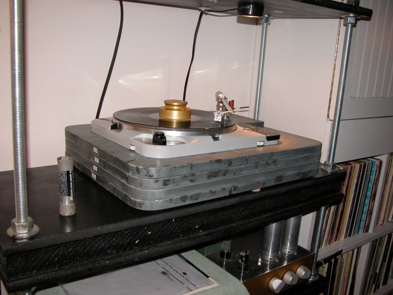

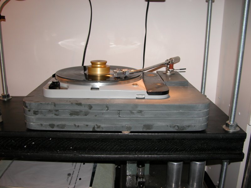

The sad thing about this is conceptually this plinth works perfectly. The top two layers and the bottom two layers are different in order to maximize the mass of the plinth.
This plinth will live on as the plinth for my secondary TD-124 once I have one that has arrived intact.
I would have oiled the plinth had it survived intact, but because of the damage and the need to epoxy it I haven't bothered.
I'm hoping the next one can get here unscathed by air-freight. It will be packed extremely carefully..
The silence on the lead in and lead out grooves is uncanny, there is literally no noise at all other than the tracing noise.
It was to be the culmination of my TT project, now that will have to wait.. OTOH I will have two functional plinths and tables.
In any case the end result is nothing short of amazing..

So pleased with my Beogram 3000 Thorens that I've moved the tt and my vintage amplifier into my main listening room. My TD124 has been recently refurbished, and the motor is in very good condition - when being tested, it started turning at 28V AC, where I understand they typically start at 45V AC.
This shows, in that it reaches speed stability very fast - over the course of an evening I may have some drift, but I check between each record, and as Steve writes all that's needed is a little turning of the speed adjustment wheel, if necessary, to lock the speed.
And as he also mentions, it's a joy to listen to long piano notes, winds and brass that hold steady, without any hint of wavering. I have a belt driven Beogram 4000, and after getting the TD124 I'm spending very little time listening to the Bg4000 - the difference is noticeable.
My vintage units together with my Helsinki Gradient 1.5 speakers.
Detail, here with the 9"-tonearm:
